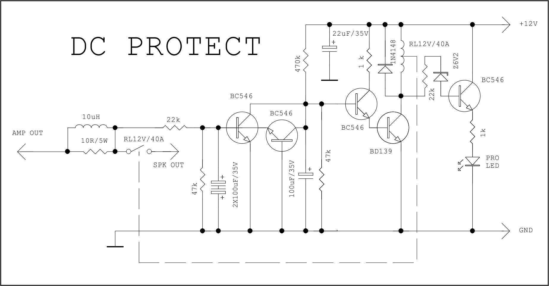

Protect from post #28 can work with 24V without any change.
Many thanks sir Mile... :)
Best Regards
What is the maximum supply voltage for your version of the 555 timer chip?
All my datasheets show Vsupply <= 18Vdc
With transistor add to NE555 out any relay voltage can be use.
Supply voltage for NE555 is 5-15V
Apex, are you expecting Boss to create a new LV supply from his 24Vdc supply, to power the timer chip?
Looks like you need to show Boss how.
