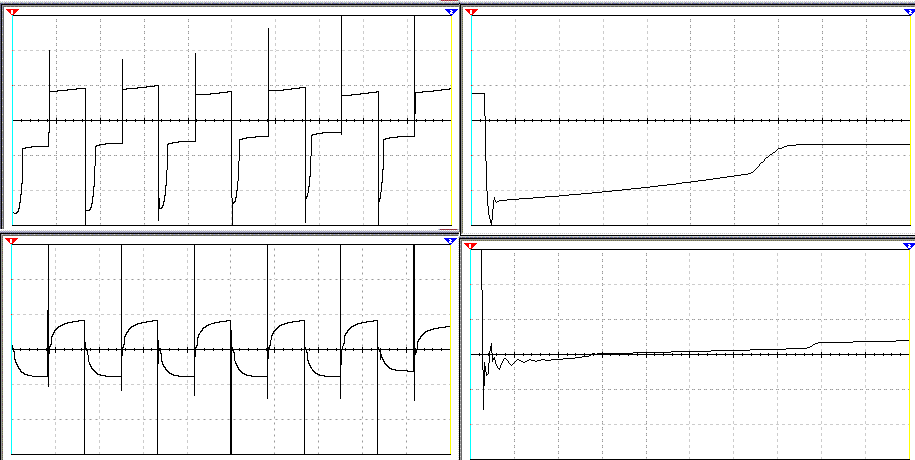

The pictures below is the simulated amp handling a slightly clipping squarewave at 30Hz. The scope is connected to the base of the VAS (This is where I look for instability that does not show on the output).
The two on the top are into a 4 ohm resistor, with the second one a magnification of the first.
The bottom two are into a 4 ohms in series with an 11mH inductor, paralleled with a 100uF cap. Like the top, the second is a magnification of the first.
I'm showing this because there's no visible difference between the two on output, and clipping behavior is also the same - clean, symmetrical clipping.
I put another 1N914 in series with the first and the top of the wave doesn't cut off anymore.

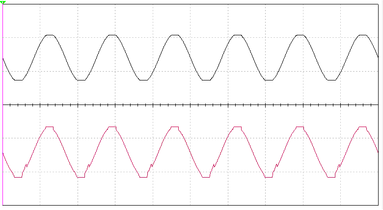

megajocke said:What does the VAS collector look like when clipping into a light load?
Here it is. The top is the output with the input 1Vpp over the input sensitivity. the red trace underneath is the collector of the VAS.
NOTE: This is the simulator, not the real amp.

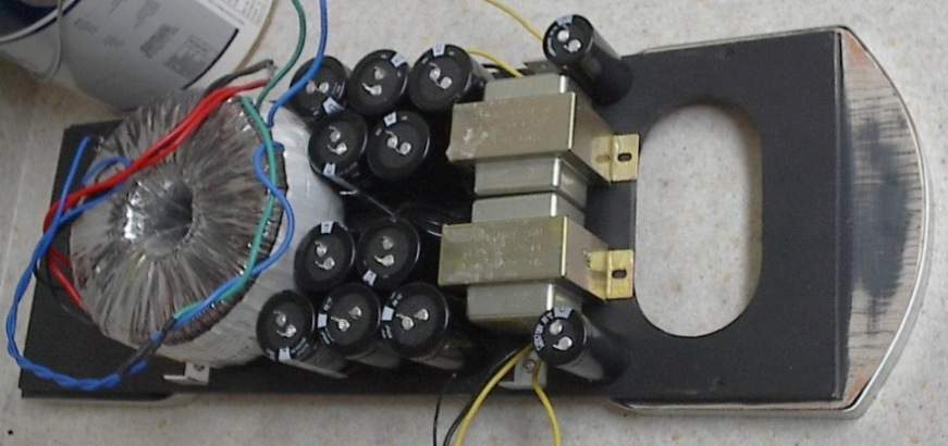

A nice pair of 4700uf caps for your input stage power won't take up too much room. Being low current, you could have the bridge just mounted to the case with a screw.
Input stage as a whole uses only 20-30mA tops, if even that much, so a small transformer is more than good enough, but I've never seen a small one at such a high voltage. Maybe you could make some higher voltage taps off your main transformer if it's a toroid.
EWorkshop1708 said:
...but I've never seen a small one at such a high voltage. Maybe you could make some higher voltage taps off your main transformer if it's a toroid.
Hi EW,
The extra voltage for the front end will be supplied from a 6.3-0-6.3 VAC transformer. This rectified voltage will be added in series to the main power supply for the front end (as shown in the schematic in post#158.)
I have played around with the placement of components on the chassis, and I think I can get it all to fit. Originally I had a 12-0-12 transformer for the relays and control circuits. I will replace that with two 6-0-6, 3A transformers to supply the extra voltage for the front end, the 12V power for the controls and the 24V for the relays.
Here's how it looks. Everything will still fit under the cover shield. I have some new 4700uF caps coming to use in the low voltage supply.

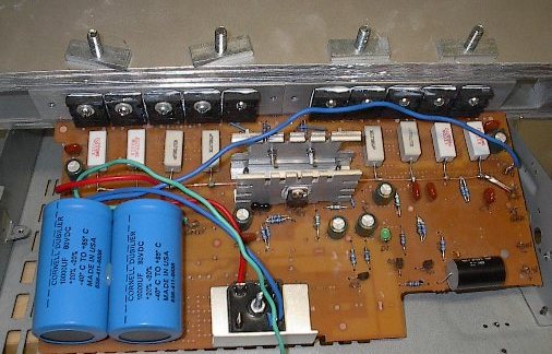

Hi Dan,
My test supply used 2 Cornell Dubilier 10,000uF caps, one per rail.
The final supply will have 5 - 8200uF per rail (plus the two 10,000uf above, if I can make them fit).
I do see what you mean, that some of the "ringing" could be from the power supply not being able to keep the high current demand up.
I'm going to take the time to try to get the real power supply finished before I run anymore tests.

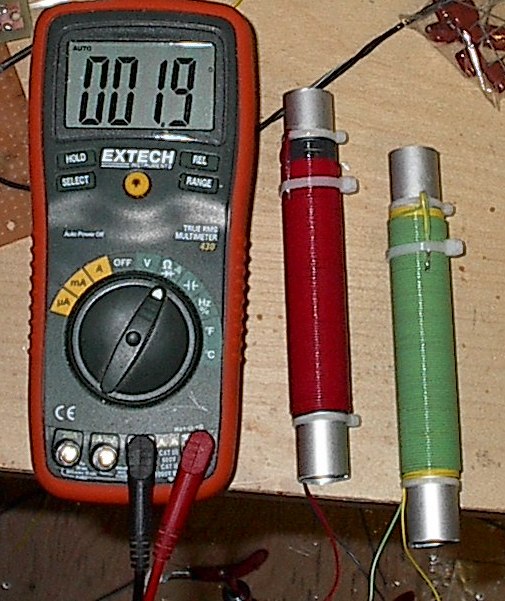

I think it's more the load I was trying to drive. My homemade resistors may be too inductive. I will make a point of measuring their inductance tomorrow with Speaker Workshop.
Shown earlier, here are my dummy load "resistors":

Hi wg_ski,
Do you really think it's absolutely necessary to have base resistors on all of my output stage devices? I have decided to have one to supply all, not wanting to tear down the work I've done already unless it's needed.
This amps predecessor, the P68 500 watt version had no base stoppers at all, not even on the drivers. I guess Rod doesn't believe in them. Anyhow, that amp ran stable, and it had 4 paralleled outputs per side plus the CFP.
I just got lucky, I think.
