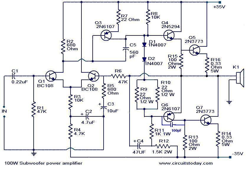

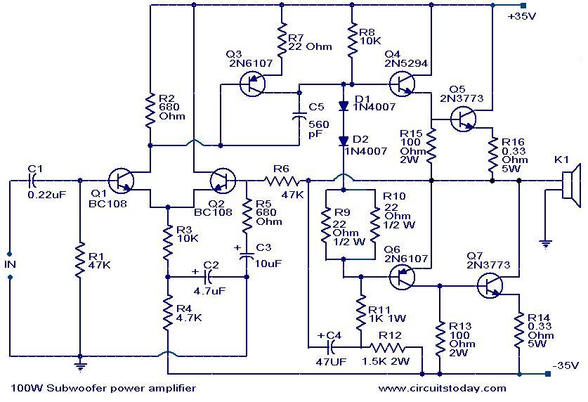

one pair is enough to drive 100watt load
There's more transistors that support 100W, for ex: MJL3281/1302 it are complementary.
2N3773 is difficult of meeting original and also worse than the above model.
Then you can give me schematics
i wan to make an amplifier for keyboard and guiter
Thank you

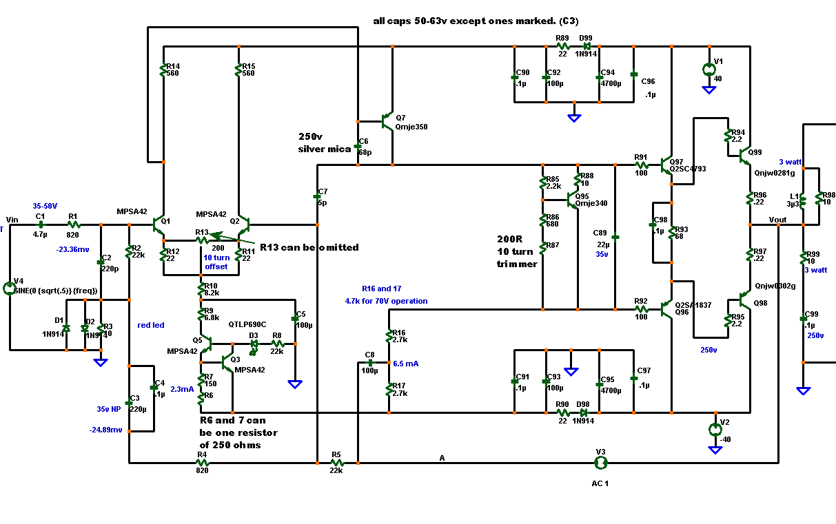

Here is one that will work with your mpsa42's and will be 10 times better that the one you posted. Runs on 40-0-40vdc.
OS
Is this schematic finals, I wish to try it.
