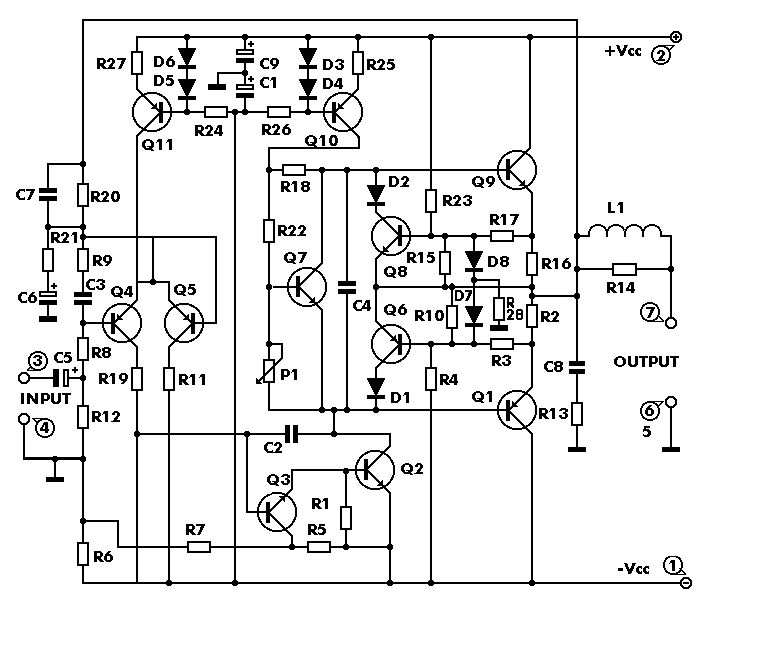

100 watt audio amplifier
this is greek made
from a company called smart kit electronics
if you buy the kit its almost for sure that it will not work since its using bdv 66-67 darligtons that they are not "selected" and i dont mean matched i mean selected ....
bdv 66-67 might have diferent behaviour between company to company and also between the same company but in diferent orders ...
so if in this amplifier you have P and N transitor that they are not complementary your amp is out of balance and bias ( very critikal for this design ) will never work properly
also 100w is overestimated and will never be produced as operating these bdv 66-67 in 40 volts rails and 4 ohms loads is way out of transitors can handle .....
one option will be to get the schematic and part list of this and operate it with MJ15015-16 very nice devices from on semi
but finally you dont expect much of it sound wise no matter what transistors you use
and the best option will be to built a DX amplifier from Destroyer x
( you will get a lot of forum help if you choose to do that ) or other designs the same simple but more safe and effective to built that are discussed here in the forum
simular to DX is the P3 or P3A from rod elliot or sixtec amplifier or symasym and so on ...
search .....you will find plenty
if looking at the circuit
there is nothing new about it
there is no improvement and good ideas, apart from very rudimentary circuit
It is, in my opinion, a very standard and simple version of Douglas Self blameless amplifier.

in this particular kit the outs are darligtons BDV 66-67 OR BDW 83-84....
am i missing something ????
the schematic is the very one from topic starter kit!!!!

kibet85 said:
http://english.cxem.net/amplifier/amplifier25.php
Hi all,has anyone done this amplifier....
The schematic looks OK.
Conventional Lin-topology solid-state class B/AB amplifier with darlington output stage, with overcurrent & short circuit protection.
The OP stage looks a bit undersized, but for home usage with the inbuilt protection it seems enough.
However for PA usage I'd add one more pair of OP devices. Or change these BDW devices to a 200...250W rated darlington pair.
R2 must be 0.47r/5W, I'm sure that 1r/2W is a misprint.
Solder a resistor in series with P1 for safety reasons! Then I'd double C6 to 220uF.
Rail fuses are needed, use 5A fast-blow fuses /rail.
With the mentioned modifications it's a reliable and cheap project. IMHO it's not that bad as Sakis and Lineup noted. It has a correct PCB design too!

Thanks guys..first,m a rookie....i just love loud sound..now,this amp has already been made..its intended use is a subwoofer amplifier(actually,m using it right now)..the thing is,its not responding to those low bas notes...e.g..i hope you guys know this song'get ur walk on'by xzibit..it has some deep bass..this amp is not responding to those kind of beats..could u guys tel me wats the problem is...
M using a +-38 transformer with 4700 microfarad caps rated 100 watts..for the outputs,1 pair of darlingtons...mj2500 and 2n6388...thught of adding another pair and increasing the caps to like 15000.... my sub is a pioneer 800 wats rated 4ohms...
questions
are you using 38+38 ac ????? so your rails are something like 50+50 volts ????
then in this case what is your idle ????
did you managed to set the idle as was or you made any mods???
also mj 2500 and 2n6388 are they complementary ????? can they be complementery ????? do they share the same specs ????
have you checked the device with a scope ????is it symmetrical ???is clipping symetrical ????

listen mike
facts
- this amp is designed to operate in 40+40 volts
- increase the rails of the amp is almost 53 volts thats out of specs
- will effect the gain
-will effect the bias
-will effect the protection circuit
-will effect safety
then .....
one amplifier to operate properly in this class has to be symmetric IE the transitors used have to be complementary IE same make brand and cahracteristics ....
for example 2n6388 is 80 volt .....too litle for operating at 53+53 volts then 10 ampere and can dissipate 65w totaly ..... you are asking to more than 100w...thats not right ......b1000 is the grade of amplification you get from this transistor and finally this transistor is not designed to use for audio is for small switching application or power supply
now mj 2500 is even worst only 60 volt .....cannot operate at 53+53 volts 10 ampere and then 150w ( thats the only good but very diferent from 2n6388 ) and atleast can go up to 3mhz that makes it a transistor that can work for audio .....
more facts
they way this amp is built it will fail any minute now and its disuster waiting to happen .... unless all these is a mistake and you have 38+ 38 volts DC ...in this case transistors are barely enough but will not work as long as their not complemetary ......first it will fail the 2n6388 then will also destroy the mj2500 and then your speaker .....even if you have fuses on this will not be fast enough to save your speaker ...
in case you have 53+53 volts rails the protection circuit needs to be redesigned to be able to operate at this voltage .....
also the idle you state of 50ma is totally wrong and the only way to calculate bias properly for this configuration is to measure the voltage drop acroos every emiter resistor 0.47R 5W for every transistor respectively .and then calculate with ohms law
..... i bet you that if you do you will see that the one has like 10 mv and the other has 50 mv since this is coming from the diference of the transistors .....
the only possible solution is to get the brother of mj 2500 that is the mj 3000 or any other set of complementary transistors .... for example mj 11015-16 that are 160 volts devices and then either remove totaly the protection circuit or recalculate it for the specific application ....
in this case you will almost make at least 120w of solid power and also very stable
