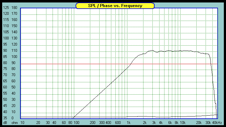

Usually. There's tweeters which doesn't have big bumb in impedance.Here is tweeter which has peak at 500 Hz only rising couple of ohms.
THE ART OF SOUND PERFECTION BY SEAS - H1189-06 27TDFC

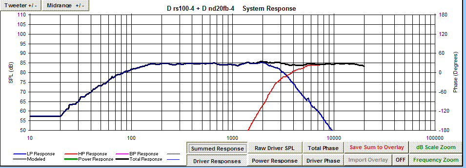

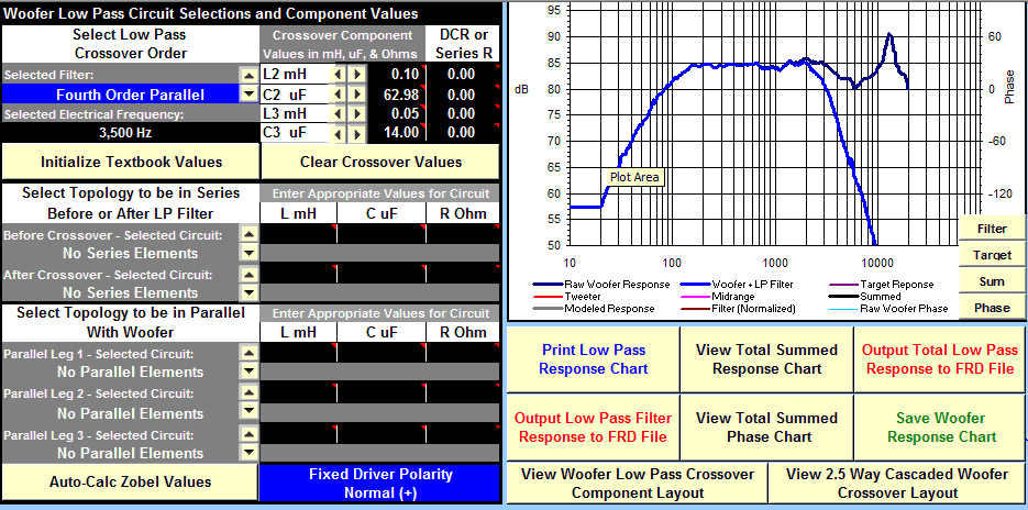

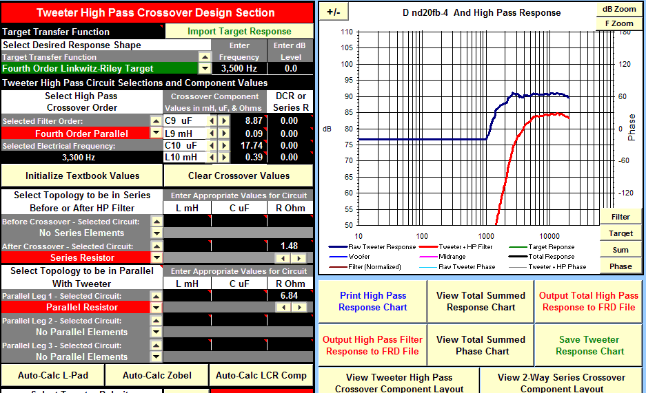

Update: I've been using Passive Crossover Designer and have managed to get a fairly flat response.
Woofer crossed over at 3500Hz, tweeter at 3300Hz. (With 4dB attenuator)
Does this response look ok? Please request more details if needed.
One more question: should I use Zaph's FR graphs or the Dayton ones?
