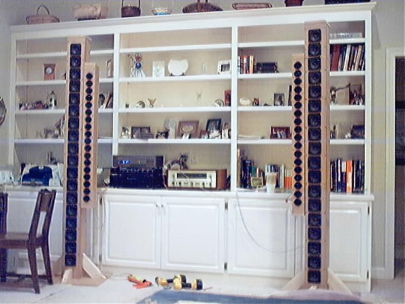

enjoyed the bag of chips... best speaker I've ever built, purpose built for circlotron otl.

Re: Re: been there, done that...
graaf said:
wow! thanks! :)
beautiful and impressive!
what is the combined impedance?
what are the drivers? tell me more! :D
best,
graaf
They were Parts Express buyouts, no longer available. They were built in three days as a proof of concept excercise of the least expensive drivers I could find. 49 cent midranges, 70 cent tweeters. $400 total for the pair, complete. They roll off at 80 and 18000. I crossed over at 4000, used active electronic before tubed mono-blocks. 16 ohm resistive in a complex series/parallel 6 group power tapered arrangement ala James Griffin's NFLAWP.
