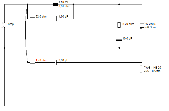

10" woof plus single capped morel cat378
I don't subscribe to the ohmage theory. All you need to know is that this is a low inductance woofer around 0.6mH like most eminence speakers.
So if you have a bass coil 2X or 3X bigger, its going to be flat enough. Eminence often recommend 2mH and 10uF shunt on the bass, with 3.3uF and 0.3mH on the tweet.

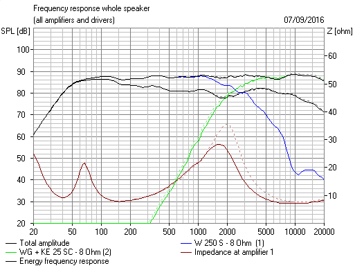

Let's look at the FR:

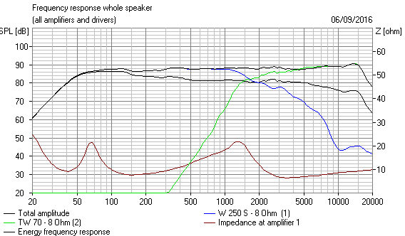

I think you'll end up around 2.5kHz crossover. Below is some modelling of mine with a far less efficient high inductance 10" woofer and a cone tweeter. It all seems to play nicely enough. Second order at least on the tweeter though. Hope it helps. It's your project.

Designing Loudspeakers - WD25T EX - The next step

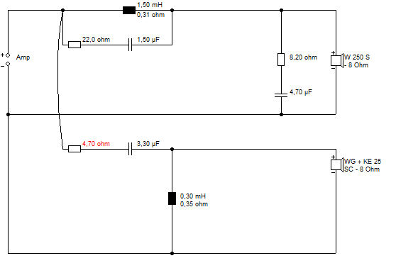

Looks like you are just going to scrape it on tweeter level here. I decided that 2.5kHz XO was a good place to be. The bass filter, mere shaping really, is almost written in stone.

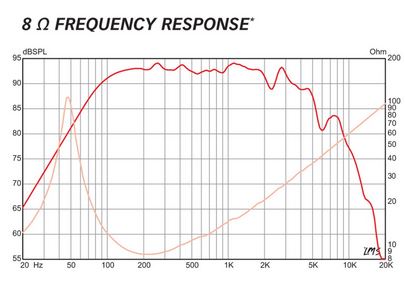

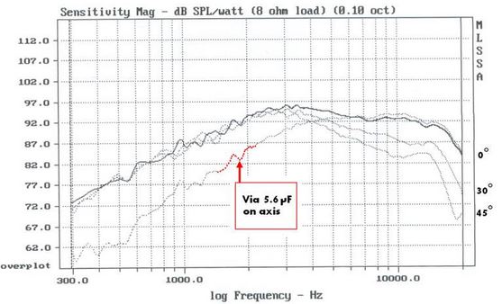

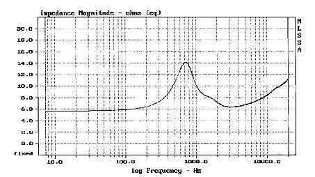

Phase alignment isn't very critical. Just seems to work. Most of your efforts will be adjusting the tweeter filter. I'd guess 4.7uF will be reasonable as a simple cap filter here. That 14ohm Fs lump on the ferrofluid CAT 378 shouldn't be too problematic, but I don't like that sort of thing much from listening experience.

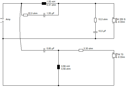

A couple of second-order filters seem to play nicely, but values are affected by how much attenuation you need, in fact they all end up in much the same place. The dotted line is what I called the Devore 1 filter.
Nobody gets a speaker right first time. Not even Troels. Because there are trade-offs. But the sort of project I would take on. The final tweeter crossover is not going to be more than 3 components, which can't be that hard. :)

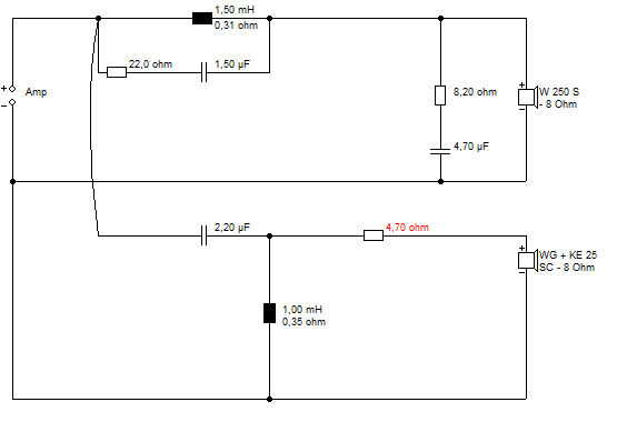

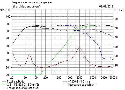

I've been simming something similar with a genuine waveguide tweeter, albeit a sophisticated one with a an Fs notch built in. It gets nowhere near 6dB/octave, of course.
You could take the crossover lower, of course, and dispersion improves. It looks like this first-order. With the likely less attenuation with the B102 woofer, the cap would probably be near enough 4.7uF with no resistors. But actually 5.6uF and 15R shunt would be better IMO to damp the Fs a bit.
You can see the tweeter is being worked much harder at low frequency. So distorts more, which is the trade-off. Phase is a bit off, but happily lobes above axis, which is where most of us listen. In fact a bit BW3, which is no bad thing.
I think the bass coil and related notch might be a bit select on test. I really couldn't guess what will sound balanced here, but you can usually just listen to the woofer on its own and get it right.

The morel is easy to roll in due to same sensitivity. A compression driver has higher inductance and will resonate with a cap. The klipsch rf7 had the same problem I think. But you can use cap / resistor to get level right. Ideally the morel would be more revealing if it didn'the have ferrofluid.
