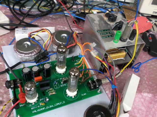

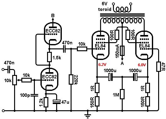

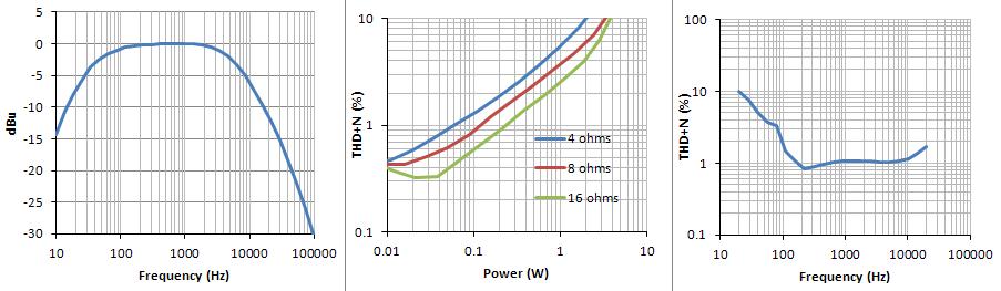

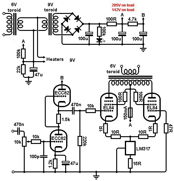

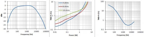

I recently acquired this amp kinda by accident, for spare parts. But after I received it I knew it looked familiar somehow and eventually traced it to this thread! So I thought it would be fun to run a few tests on it, and see what could be done with it. I had to reverse engineer the circuit, so Nigel can correct me if anything is wrong.

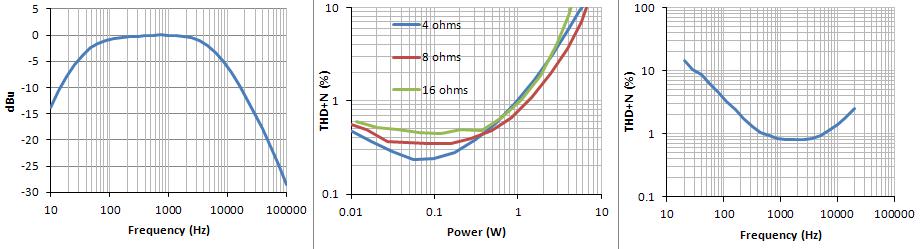

You can see from the results the -3dB bandwidth is about 40Hz to 6kHz (1Vrms into 8 ohms), which I guess isn't bad when you're using a power transformer as the output transformer.
Distortion is pretty dire, struggling to make even 1W if you don't mind listening to ~10% distortion!
In all the following tests, distortion v. frequency is also at 1Vrms into 8 ohms.
The main problem as I see it is that the HT is too low, only 141V! Let's bump it up a bit...

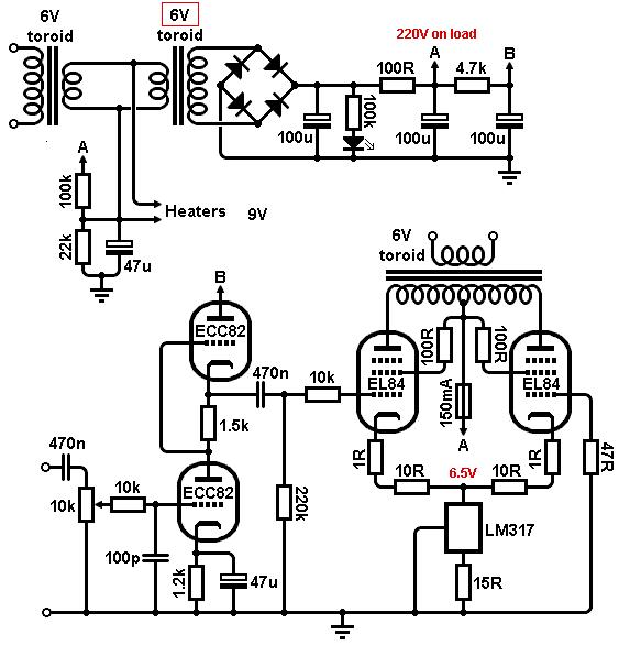

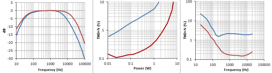

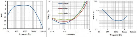

So I replaced the 9V backwards transformer with a 6V backwards transformer, giving me 220V HT. Now we're getting a more realiable 1W at close to 2% distortion @ 1kHz. At low frequencies it is actually worse, but it does looks better behaved -more like you expect for a transformer-coupled circuit.
I think the LM317 CCS is now the big handicap because it has barely any voltage headroom with only 6.5V across it. Also there is about 5mA mismatch between the EL84 cathode currents which could be affecting the output transformer, so let's do something about it...

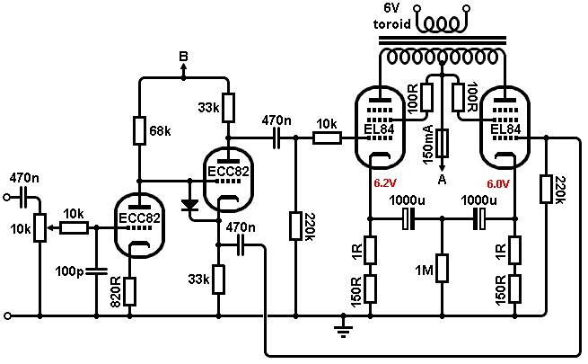

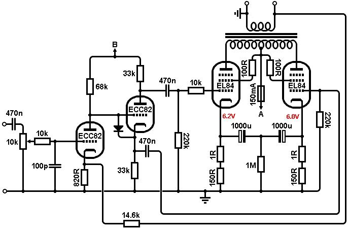

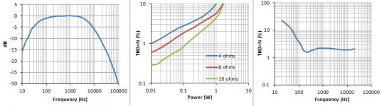

Here I've replaced the CCS with individual bias resistors, but kept the cathodes coupled together with capacitors. Now there is only 1.3mA mismatch between cathode currents. Unfortunately this means we have sacrificed AC balance; without the CCS the master EL84 is passing much less signal to the slave EL84. Output power has suffered. So let's get rid of the trendy quasi-SRPP and restore AC balance with a proper phase inverter...

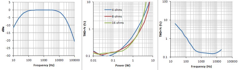

OK this is now a big topological departure from the spirit of Nigel's orginal design, but a man's gotta do what a man's gotta do
After converting the circuit to an old reliable DC-coupled cathodyne, we're really getting somewhere. Output power now comfortably manages 1W at <1% distortion, and distortion v. frequency is back to 'normal looking' again. If you don't mind listening to 10% distortion then we are getting 7W into 8 ohms, more than 4 times what we originally started with!

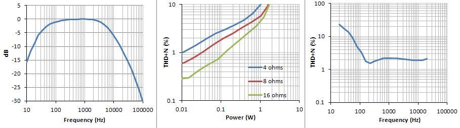

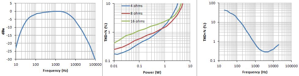

Finally let's do something about the frequency response. The limitation of the 'output transformer' could be improved either by driving it with a lower impedance, e.g. triodes, or by using negative feedback. Let's try the latter because it's quick and easy. From the previous frequency response graph it looks like about 8dB would be enough to bring the closed-loop response down to where it will manage 20kHz @ -3dB.
So after adding 8dB feedback the response is now 35Hz to 15.8kHz, a bit less than attempted but hey, I didn't want to spend long on this or court instability. Remember, this is just for fun! Distortion has likewise fallen by 8dB, being less than 0.4% at 1W. You could now reasonably call this a 2W amplifier (~1% THD), at least at 1kHz!
