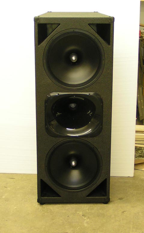

I recently completed these:
They are based on Earl Geddes Nathan design but built with much cheaper components. Namely, B&C DE10-8 compression driver, Dayton HR10RW waveguide, Selenium ADM25-25 adapter, Eminence Beta 10a. Gedlee HOMless Foam Plugs.
I am using a ESP P09b electronic crossover, crossing at 2.2khz but am about to change that to 1.8khz. They are already sounding very nice. Just tinkering and doing the final touches now
