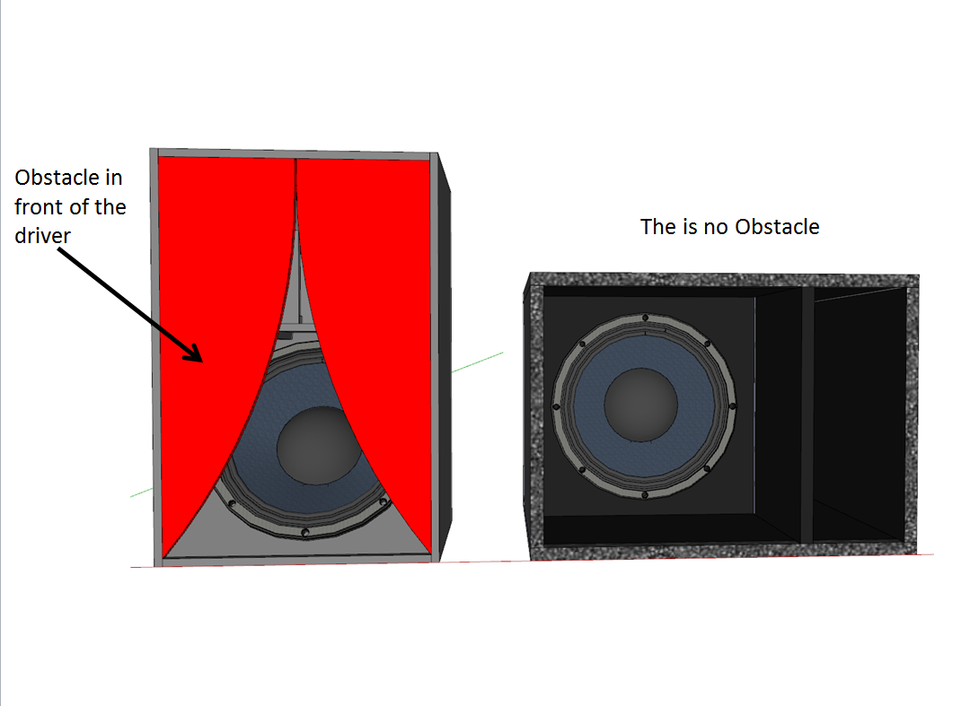

IG81, thanks a lot for your shared experience, I may need MMJ support to proper answer all your comments but in the mean while could you share what is the Karlson design you are making comparison?
When I think about Karlson i rember that there is an big obstacle in front of the driver, maybe these leads to a different behavior in the upper frequencies. The supper planar has no obstacle in front of the driver, so there is nothing that could attenuate upper frequencies at front radiation, but the resonator in fact as side effect can affect the upper frequencies directivity.
I can review the target, but do you think the best solution still BR or should I try to investigate other design?
Without proper measurements to confirm any theory we may run in circle :D

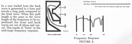

I still think that the MMJ proposal is different because the dip we see probably are only linked to the interaction between front and back waves. There is nothing in front of the driver to attenuate the upper frequencies and upper frequencies are very sensitive to obstacles. In this sense Karlson is a different story. Maybe the design closer to Super Planar would be Rear Loaded Horn that present the same cancellation (dips) behavior due to front and back waves.

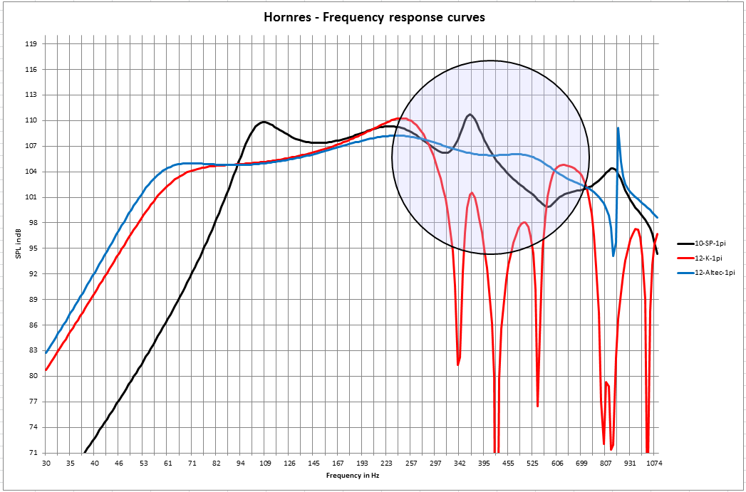

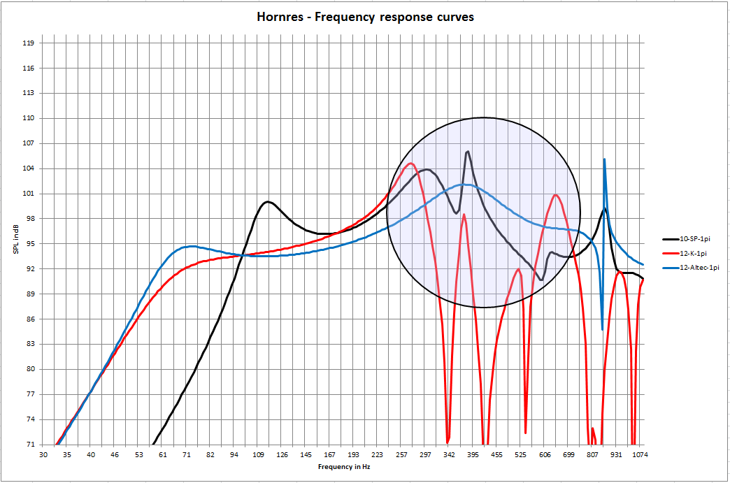

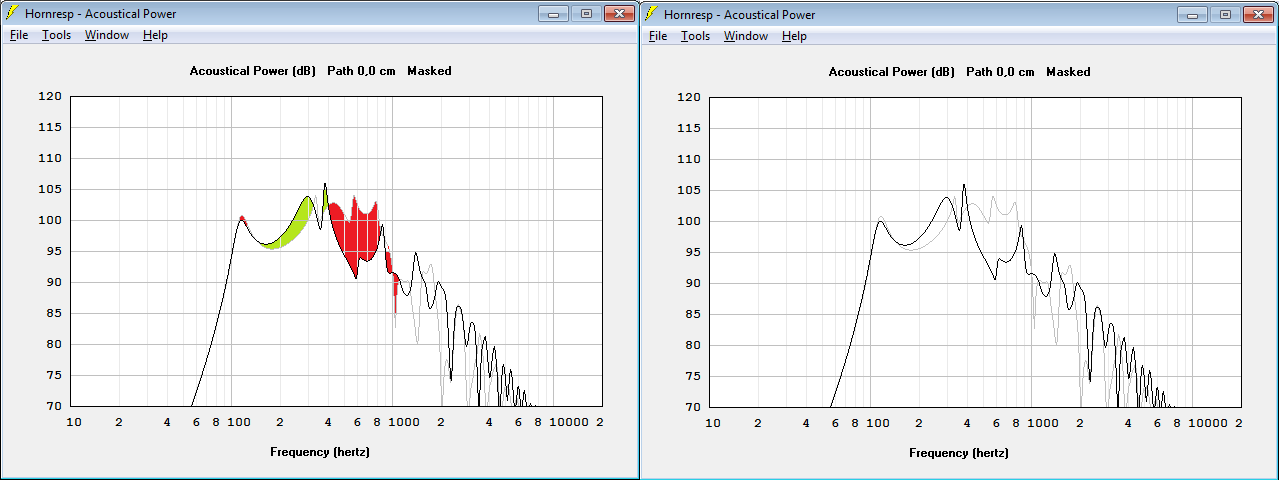

Freddi, below you can find your two simulation compared to the Super Planar 10", one at 1pi as you made, and other as 4pi (as I'm focusing).
In addition, maybe hornresp is not much accurate to simulate Karlson design.

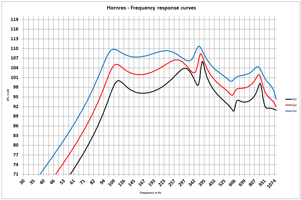

IG81, I put all three conditions in the same graphic for your better comparison: 4pi, 2pi and 1pi and as you can see in 2pi the Super Planar Top is already over 101dB and with small EQ it's over 104dB, isn't seductive for a single 10"?
What 10" driver is this?
I guess stitching the red trace to the black one above ~500Hz might give a rough idea of system performance including baffle step. One could call that a "solid" 98dB. You're in a ~10dB window from 100Hz-1kHz, could be worse.
I don't know how it will sound subjectively though. There will be standing waves, mouth reflections, diffraction and HOM's. I suppose you really have to build it and evaluate if it works for you. Luckily one such enclosure should be a fast and fairly cheap build.
What is essentially a U-frame on a bass reflex, is here being used outside of its pass-band. The linear effects on the transfer function (shown in the above simulations) are not as bad as that of a Karlson, but it remains to be heard if the result is more euphonic than annoying IMO.

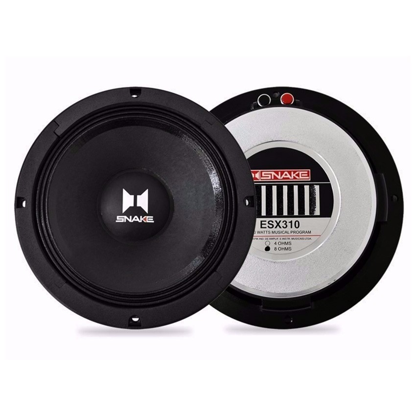

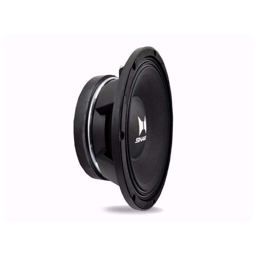

It's a brazilian driver from a company named Snake.
Driver model: ESX310
T/S parameters
fs = 67Hz
Re = 5 ohm
Qms = 6,653
Qes = 0,192
Qts = 0,186
Vas = 28 L
Sd = 0,0314 m^2
Xmax = 4 mm
Le = 0,28 mH
BL = 17,37 T/m
no = 4,3%
mms = 28 g​

The Super Planar uses a quarter wave resonator (not reflex) as the rear section , and yes , in this case a U-Frame as the resonator in front of the driver ..... It is compound loading with the high-tuned front resonator filling in the 4/4 cancellation of the rear QW section ... .

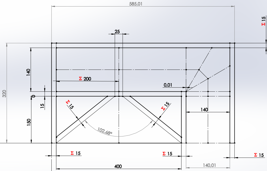

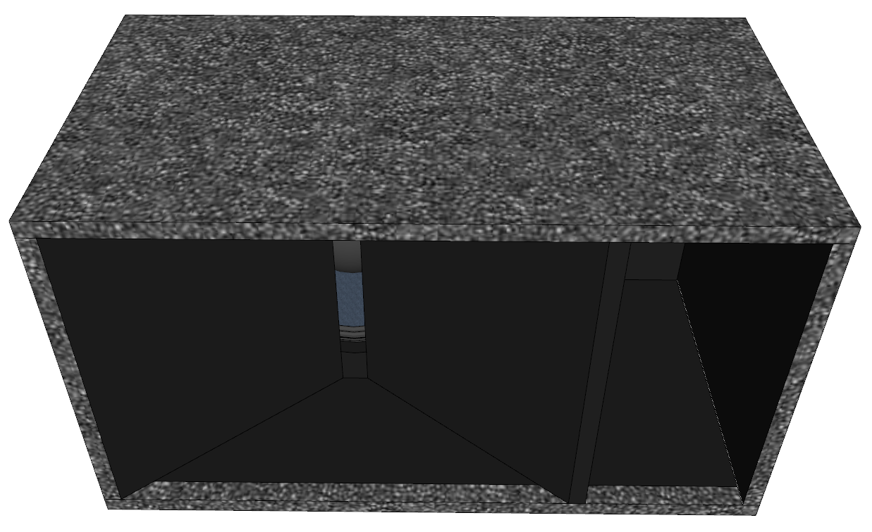

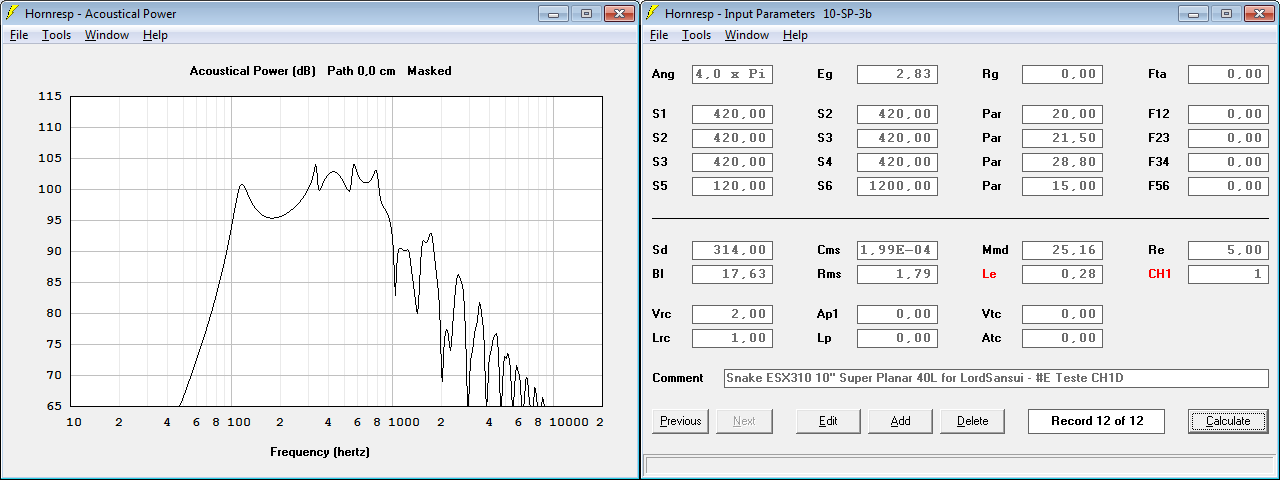

Backing from some time due to my baby burn and playing around with the new tool added from David to hornresp (thanks) here are some results.
CH1, it's a compound horn with front path having offset drive.
Considering the original proposal from MMJ to Superplanar top, the one I've been used in this thread and just adding flare in front of the driver in proves a lot the HF range but at the price of some lost in the medium frequencies. Probably it can also improve cab dispersion.
At the end the design became exactly a front load horn with big vent and short horn path.
Still in doubt about what to do, lets see
