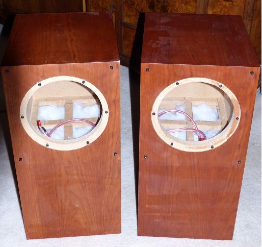

I just picked up a pair of sealed enclosures that have dimension of 13.5" wide x 16.25" deep x 27.75" height - these are 1 1/4 mdf thick . Can someone please suggest some 10" that would work well in these cabinets. thanks.

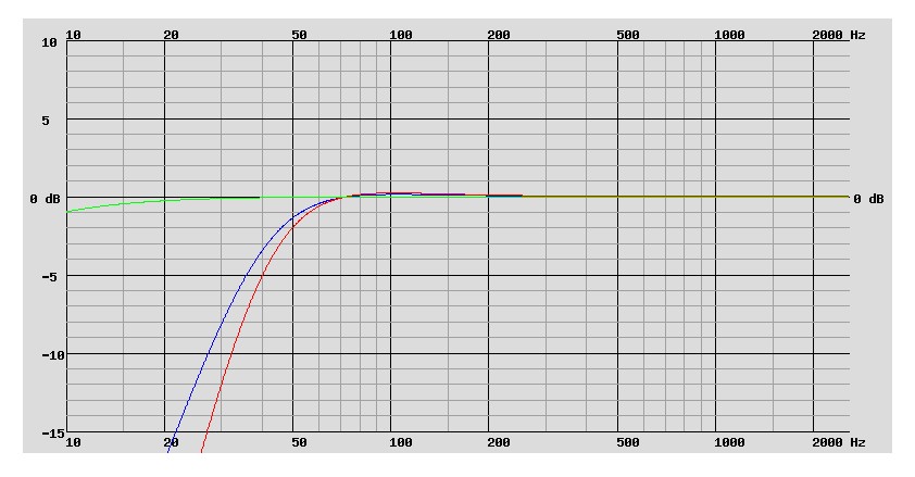

:2c: I found 2 Drivers that IMO should suit your Boxes for Sub use if properly Ported:
http://meniscusaudio.com/images/CSS-SDX10-data170308.pdf
In closed(~ Net. Vol.= 60L/f-3dB= ~46Hz) or Ported Boxes(~Net. 52L, Port Vol.=~ 8.8L, Port Area= 110cm^2, Length=80 cm +Bw4 HPF at ~22Hz)....Rec.#1
http://www.parts-express.com/pdf/295-414s.pdf
In closed(~ Net. Vol.=60L/f-3dB= ~51Hz) or ported boxes(Net. 52L, Port Vol.=~ 8.8L, Port Area= 110cm^2, Length=80 cm +Bw4 HPF at ~30Hz)....Rec.#2
b:)

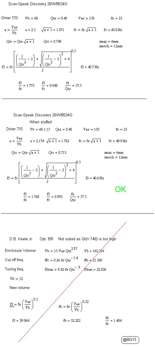

Scanspeak Discovery 26W/8534G 10"
So i take it as a big thumb up?

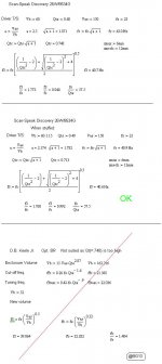

It's acceptable. If you're ready for the ~41Hz/F3. It may work nicely with the room gain. (This in relation to the low fr. extension only.) Two (62L) sealed speakers might give a good punch. :)
  • SCANSPEAK 26W8534G00 v2011, VB = 62.0 L, QTC = 0.772, le 0 dB correspond à 85.3 dB2.83Vm.jpg
