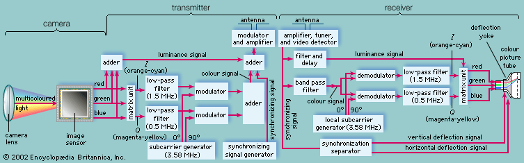

Guys, I apologize for a dumb question undeserving of starting a new thread... Usurping wire 1 for SUM instead of GND, with custom adaptor/splitter at each end, L and R can be recovered balanced, no? In general, N+1 wires for N channels: SUM, SUM-ch1, ... , SUM-chN. Why not? Thanks.
(Acutally I was looking for SUM and DIFF thingies and wondered if unbal/bal adaptor/receiver already contained such.)
In theory, yes.
You start with [L], [R] and [Gnd] (3 'poles'), and ends up with [+∑ ], [+L-∑ ], [+R-∑ ] or [-∑ ], [-L+∑ ], [-R+∑ ] (both 3 'poles' too).
It's comparable with the colour coding of television ( [Y], [B-Y], [R-Y] ), all to be superimposed on a hf-carrier.
As long as the coded signals are noise free ('in the box'), it's ok. But transferring these through unshielded cable, external noise will be added no matter what. (Adding a shield, common or separated, will increase the amount of 'poles'.) Decoding the original signals will become more difficult, adding distortion to the signals. The net gain will be less then staying with the original.
