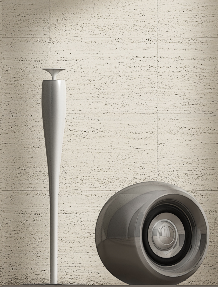

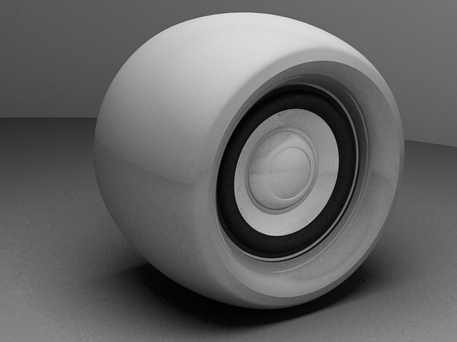

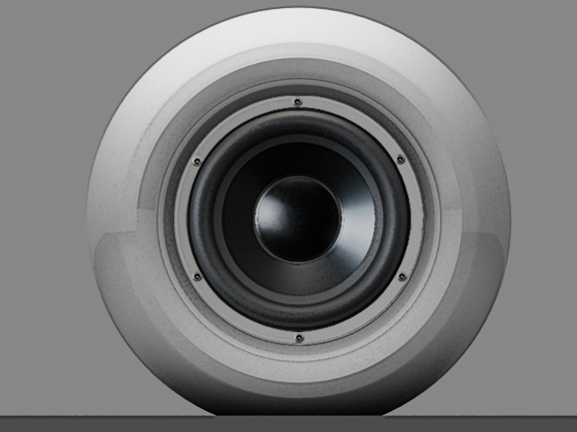

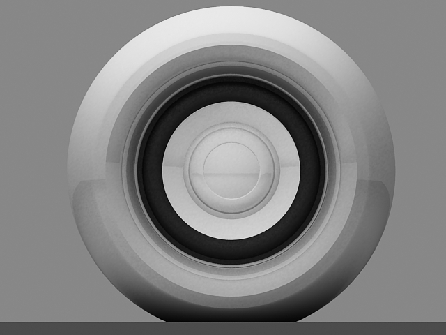

Softening edges is a necessity IMHO, 3/4 inch radius is the least I now do, but if you can only do 1/2 inch, it is far better than nothing.
You are fighting a round baffle. That is the absolutely worst mechanical arrangement for a baffle with regard to ripple in the baffle step. As I said, if you are building an integrated system so you can apply eq where needed, you can probably do OK. Just expect it. As an example: assuming a 130 mm round baffle with an 80mm driver in it. Expect a 2 dB hump at about 2100 Hz and a 2 dB dip at 500 with about a 6 dB step with pole-zeros at about 250 and 450Hz. It will make the speaker " shout" in a most unpleasant way. This is just from a model, so the reality in measurement will be different. Using a full range, or more correctly a wide range, you will have breakup modes to deal with. This can be nasty. Nasty enough I abandoned my FR efforts and went back to tweeters.

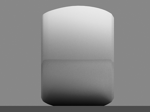

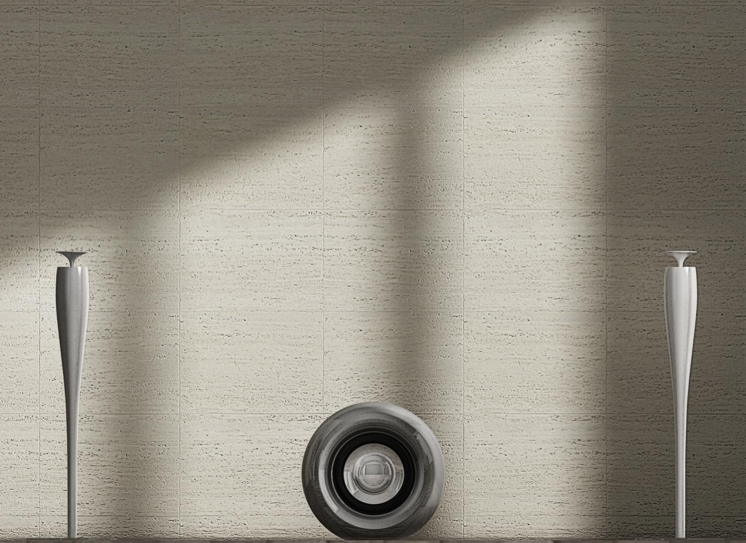

My understanding is that curved/round speaker shapes get around the inherent structural and acoustic problems of box speakers. A sphere is the ideal exterior shape. Internally, a sphere is not ideal acoustically, so kind of by happy accident and because its a floor standing design, I've ended up with a teardrop shaped top section with no real baffle per se, and a 'tail' like stand which will absorb standing waves. The top diameter where the driver sits is 93mm across and sharp edges in the render will be softened.

Tested fish tank activated carbon. It raised Fs slightly (2 Hz) and only lowered Qts by about .05. Hump down by about half a dB. Subjective, but I think it did not do as well on controlling reflections as wool. I assume it is coal based, not coconut as it did not say. If it is the micro pores, I am not impressed. $35 going into the flower bed. It is going to cost about $150 to get a pail of the clean coconut delivered, so I may not bother without much better evidence. Right now, I'll still choose glass for big sealed subs and wool for mid-bass.
Bill, back on subject. You have no extended baffle, but you still have a baffle even if it no more than the mounting flange. Measurement will show what you will need to deal with on the eq. You can get a hint if you download The Edge and spend 5 minutes looking at the simulation. Only a sim; reality will be a bit off. The good news is the larger the radius, the less of a problem. When the radius is large enough, it becomes an effective sphere which is the smoothest of all possible shapes. As you are doing a FR, you won't have any problem with the BSC overlapping the crossover.
I don't know what problems you think rectangular boxes have a curved box solves. A curved box may be easier to push the resonances up higher where they are less problematic. No magic, just different. Should be fine. Square boxes do wind up looking like just square boxes which does not meet your design goal.
I have not heard of the FR you mention. Got a link? Always looking for a well behaved driver. My efforts with a Fostex and a Fountek were not very happy. You say no breakup issues. I think you mean no serious issues that may need eq, as all drivers have breakup. Physics. If it is high enough, and low enough Q, it may not be a problem.
Ah, Tracked it down. I don't believe the frequency response for a second. Not from a 3 inch with a phase plug. 8 or 9K maybe, which may suit your goals fine. It looks like it could be a neo magnet which would be a good thing. I am betting on breakup issues below 8K and some of that may be what makes it look like it has some top end. Typical for a FR. May be a good selection for your goals. Only a prototype will tell.
Even at 220 for a crossover, that is a small driver to fill a room.
