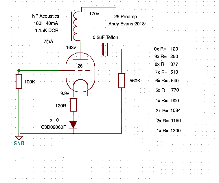

I've been lazy and have just been listening to my 26 stage with SIC diode bias (not filament bias) for a few weeks. It sounded good right from the start. I keep meaning to change some of the diodes for a resistor, and then do the same in filament bias. I'll get round to it in the end!

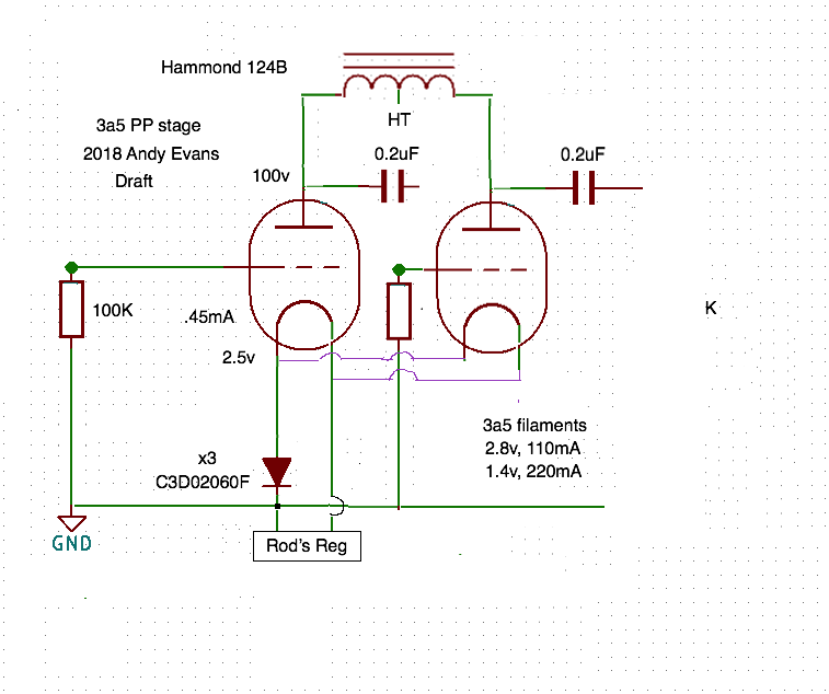

I also want to try a 3a5 with SIC diode bias as a first stage for a PP amp. I had an idea something like this.

Hmm, doesn't look quite right. I'd like to see independent regulators and a CCS tail with means to adjust currents through the core.It all just gets more and more interesting!

Curiosity led me to tweak the 26 preamp I've been using and enjoying for a couple of weeks. With the SIC diodes it turned out much better than I expected. Here's my latest version where I've run the 26 at 7ma. Not quite max dissipation but close. I put a 120R resistor at the top of the string of diodes in the hope it would add a little useful feedback. Whatever its doing, the whole thing works very nicely. I'm really pleased with this. Clarity is really up a level, as we witnessed when Ale presented his 01A with SIC bias for our recent preamp shootout, which is on his blog. This whole SIC diode bias idea is a step forward in my view. This is my best preamp to date, I believe.
One regulator can work. You can add a balance pot between filaments and SiC array for bias adjustment. That will compensate mismatch of valves and filaments
I just can't see how the pot will work with one regulator and a common CT filament supplying both triodes within the envelope.
How many volts do you need them to swing? Mind you the 3a5 is an excellent valve for low level signal and not to swing many volts. I measured about 0.2% for 10Vrms on a single ended driver test. It may sound really good though.
Not obviuos where the 10 mV was measured, at the input or the output? How much gain did the stage have? How did you measure D%?

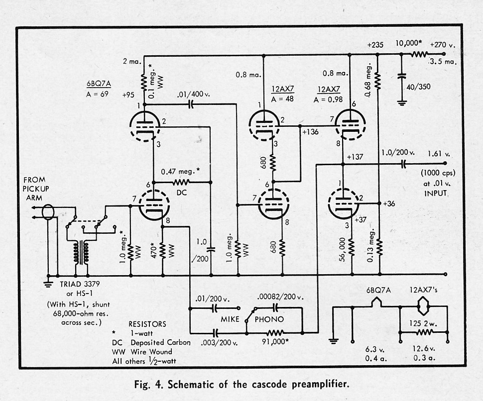

Just curious. These preamps seem very different than what I recall, those required to amplify & properly shape the response curve of a magnetic pickup on vinyl. For that 12AX7 was the dominant choice. 12AY7 is purpose built for lower noise. EF86/Z729 would also work. And for very low noise, cascode was used, often done with high Gm RF triodes such as the 6BQ7/6BK7 family.with DC on the heaters.
This thread seems to be describing something for a very different requirement.
The front end of a PP amp if it were differential wud normally have a common impedance at the point where the cathodes are brought together. That is how balance & common mode rejection is obtained. THe common mode tolerance of the amplifier is also determined by what the common mode impedance is connected to the bottom end, common or a negative supply rail.
Diff Amps are very common in test equipment. An obvious application is the Differential Probe, a very useful tool when working with circuits where a common ground may not be a convenient measurement point. I use mine a lot on the front end of a virtual scope used in audio design. This particular model can withstand 750 volts offset while set to the X1000 mode.
The common impedance we find is normally a resistance or a bipolar transistor. That puts the cathode off ground for both AC & DC currents. Not a good place to be for a small DHT triode such as the 3A5.
But could be done, interference from the heater supply is a danger. A floating battery could be used to avoid that, but needs to be shielded.
Looks like could create more problems than it solves. Have you breadboarded a trial yet? Lots of factors to consider on the way to success!
Hi Ale!
Yes, you can use one regulator, and the heating and bias can be made to work.
But please consider the anode current in each filament. For push-pull, each filament will carry music-signal current flowing in anti-phase to the other triode.
When we share a heating supply the two filaments are connected together. Now, these anti-phase music-signals will be in conflict, and this collision is not helpful. The effect on the sound is similar to using a regulated-voltage to heat a DHT: The signal-voltage across the filament is crushed by the regulator's output capacitor & the low-impedance forced by the feedback of the regulator's closed-loop.
