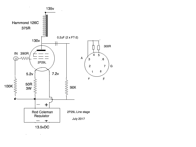

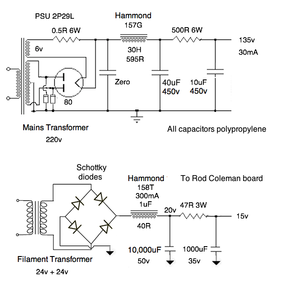

I'm setting up a 2P29L to compare with my 01A preamp. I thought I'd economise with a 12v+12v filament transformer with no choke, but it's no dice really. I usually build choke input filament supplies since all my circuits are filament bias, and no choke = detectably sharper sound. I think I may just get away with cap input into a 158T choke, which is 40 ohms, for the 2P29L. It would mean an operating point something like 125v a-k, -5v bias, 15mA. I'd be expecting 13.5v filament supply into Rod's Reg. I'll have to set it up and see if it works.
Well, it doesn't work with CLC, at least not with the 158T which is 40 ohms. I get 12.6v going into the reg. I really should go back to 24+24v and choke input, which I usually do. Obviously doesn't pay to cut corners.
Since there's no 2P29L preamp thread I'll just post the circuit here, for the curious.

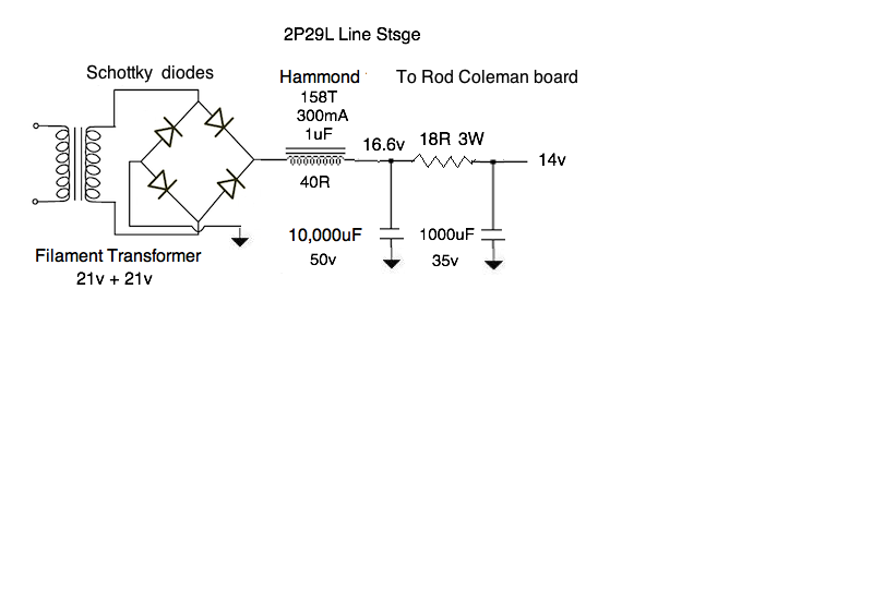

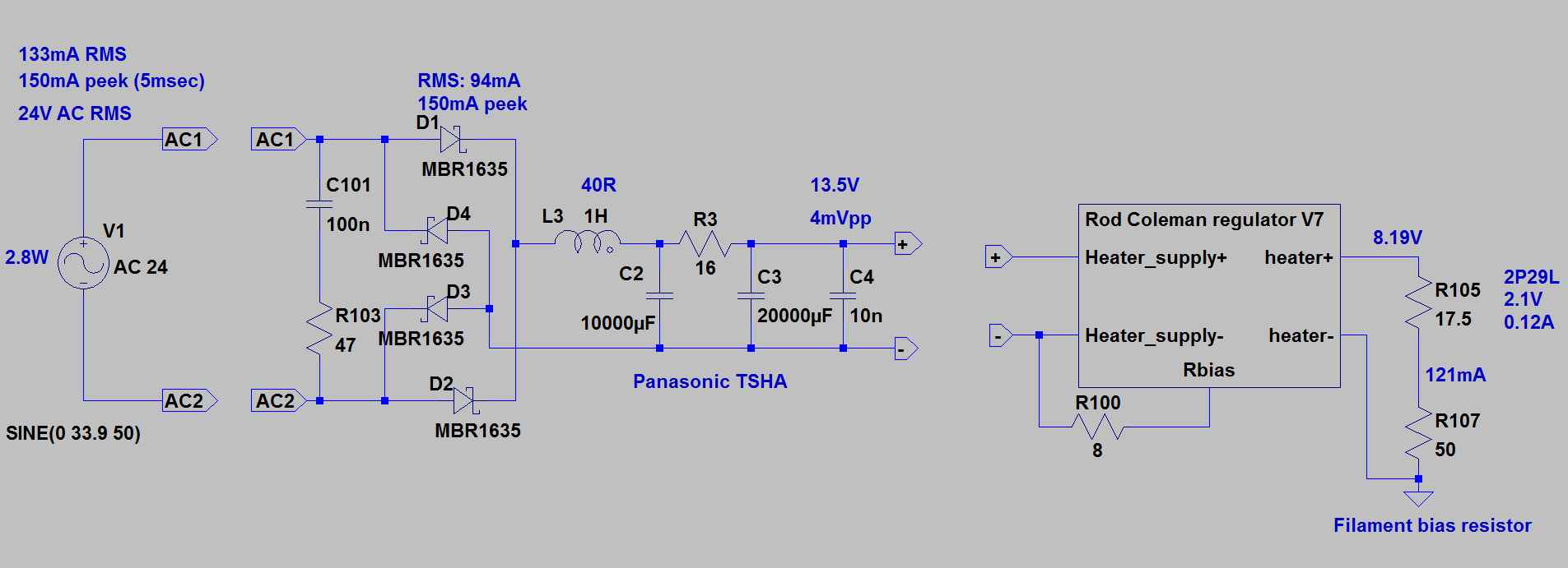

If you use 47R 3W (post #253), with 24V AC the raw supply output is only 10V.
With 33R the output voltage is about 11.5V, the R.C. regulator working at the border (120mA).
IMHO this "large" resistor is unnecessary for filtrating, with 4R7 the raw output hum is only 4.5mVpp.
If you want to compromise, with 16R resistor the raw supply is 13.5V (4mVpp).
Thanks for the schematic! I've ended up with the supply shown, finished the preamp and listening to it. It's very detailed, as far as I can tell a shade more than my 01A preamp which is the same kind of build. The 01A has a more silky tone quality - the 2P29L is a trifle sharper in the treble. They're both good, really, in different ways.

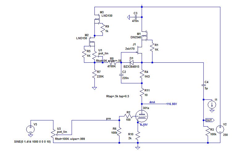

Ale's Gyrator-Filament bias Rod Coleman
I bread boarded the gyrator with the 01A today. I'm new to filament bias so not sure whats going on and starved like Ale does. I have 4volt at top of 20ohm filament resistor and about 7.7 volts at the other end. 4 volt at 20 ohm is 200ma, I assume this is what the Rod Coleman is consuming in current.....50w resistor gets warm Now, when I get to Ale's gyrator and use the test point, I read .117 volts across 10ohms, .117/10ohms is 11.7ma. This tube should be running at about 3ma, any idea whats driving up the current? I have plenty of gain, scope looks good, DN2540 gets warm at that current.
I have a couple of 01A preamps, the 2P29L now, and a choke loaded 4P1L. I don't have a 10Y although I have plenty of tubes. I want to try out the 26 again with the gyrator - at 7mA it might just drive my PSE 4P1L output stage. What do you think?
These are the contenders, I agree, having heard all of them in various builds. I hope to try your follower PCB soon with the 01A.
Yes, the 26 with the gyrator is superb. I did a quick test and was very happy with it. I will go back to it at some point I will test first the 4P1L in screen mode with some positive voltage on the anode to increase gain. It’d be interesting to see if we can get same good sound with a tad more gain in that configuration.
There are some other valves on the list to try, unfortunately not enough time though.
I’m focusing on a headphone amp as will be getting into flat renovation work and will have to pack all the system up. It will be about 6 months of work so need to survive with a minimum system. We will move out from our place during the work
Would be great if you wonder over before and listen to the latest preamps before I dismantle everything.....
Cheers Ale
What is the anode voltage? Can you dial the voltage and set the current to 3mA? What would be the anode voltage then?
The anode voltage is 116v, I assumed that would match the current in your schematic. It sims this way as well.
If I dial it down to 3ma, anode voltage is about 65volts. 3ma simmed at about 95 volts but my tube model could be flawed...
Edit: I bypassed filament bias and used a 2.2K resistor, current at gyrator test point dropped to 2.4ma, I must be doing something wrong with filament bias? Or your diagram is off a little?
