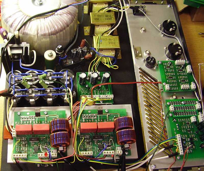

This is my 150V 30A amp inside, during assembling (3 versions were developed, this was the first):

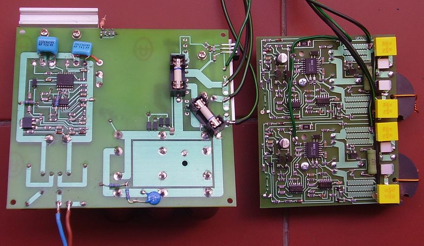

This is my simple UcD version:

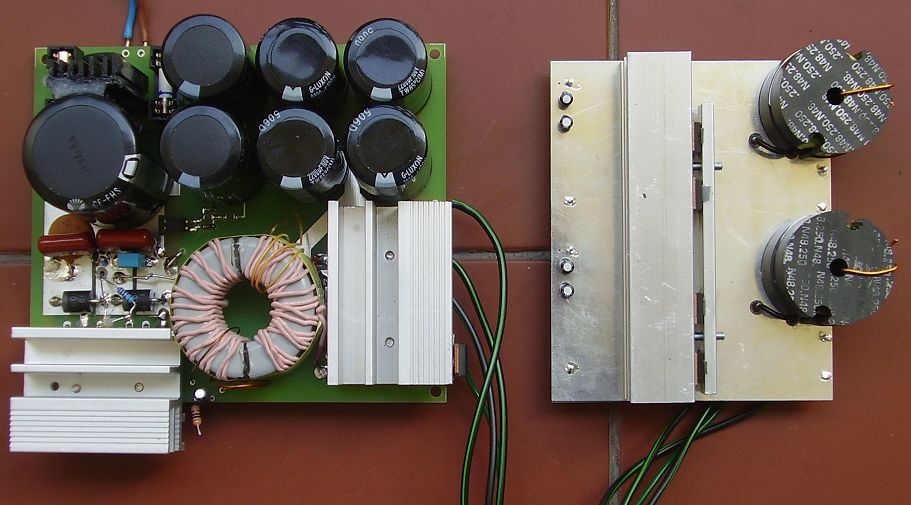

This is a bridged amp based on TL494:

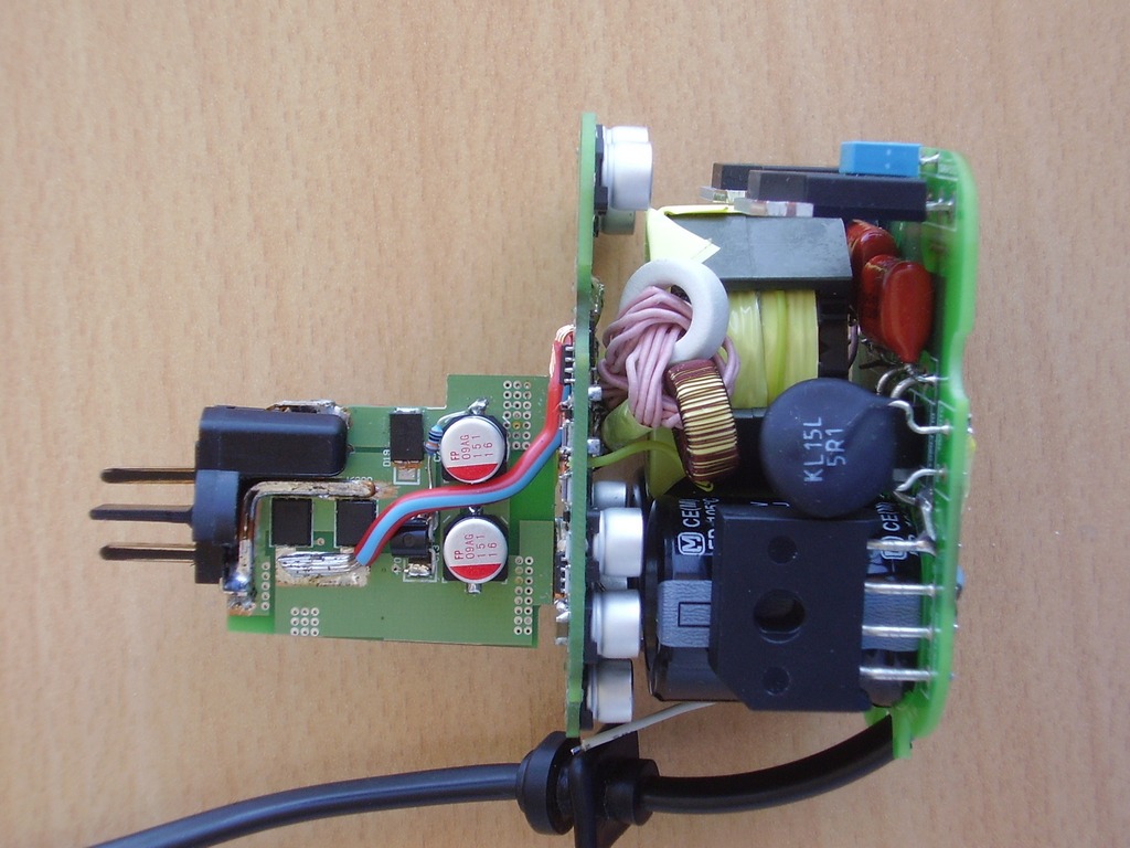

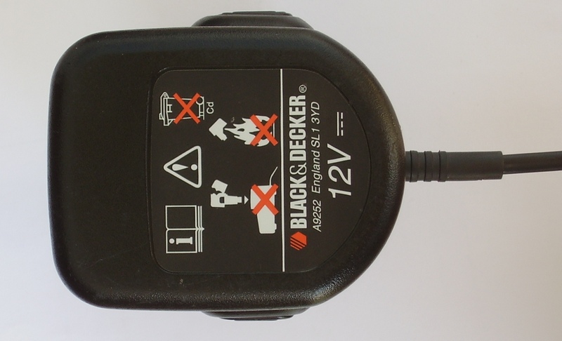

This is a 230V/12V 30A SMPS built inside the case of a drill battery:

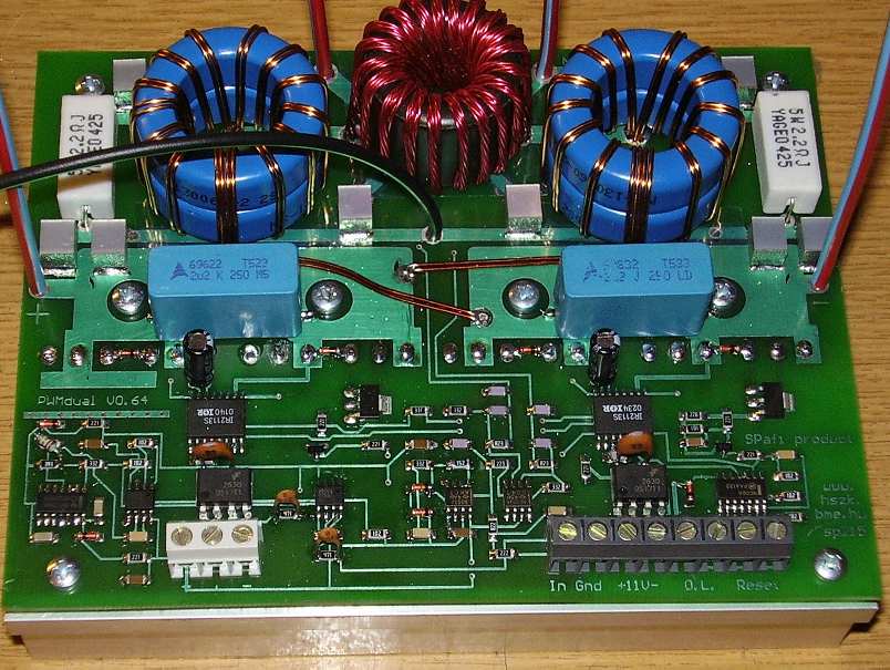

This is a very high speed UCD (a little tuning was made on PCB):
These are only the pictures already uploaded here, since I'm not home, I can show only this much, but I've built about 50 ClassD amps. All of them were designed entirely by me, I never copy schematics.
Are you satisfied now? These pictures are irrelevant, trueth and logic speaks for itself if the listener is able to think. Stupid errors in schematics also speakes for themself.
