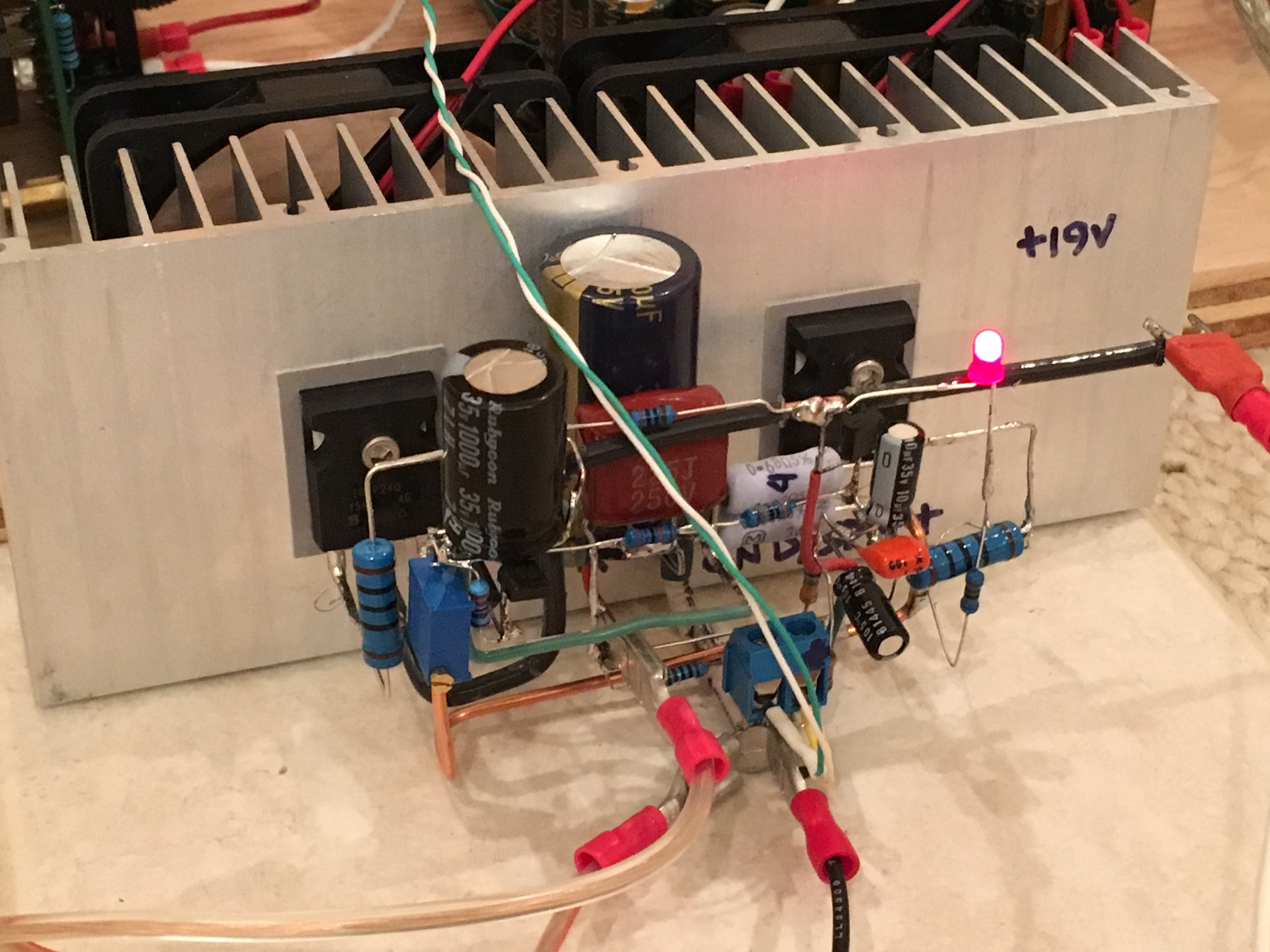

ACA is easy to make. I just made it in a few hours last night with no PCB.
Dead bug ACA:
