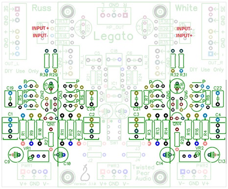

BIIIse dual mono 2 Legato output wiring
in the final stage of building my case a few questions raise:
Wiring output anlog according the document for 2 ivyIII (http://www.twistedpearaudio.com/docs/digital/dualmono_BII_IVYIII.pdf)
Are the outputs on the Legato 3.1 sides labeld SE (on both sides of Legato Board) exactly the same as the outputs on the front of board labeld R/GND/L (normally used for HP)?
Therefore should i use the outputs on front of each Legato(with left/right flipped) for wiring my output with dual mono setup? It would be neater/shorter then using left and right side of boards together.
How and where do I trim out DC on Legato wired for dual mono?

If I understand the question, you are asking to connect to the headphone out? If so, I don't think so as it goes through the op amps for normal single ended out. Fairly sure you must use the R and L SE out at sides of board.
You trim DC with the SE pots. Note; you will still be dealing with common mode DC, which is DC between pos balanced and ground, and neg balanced and ground. If your amp can't handle DC, you have to use coupling caps or lift (disconnect) the balanced ground. I run my balanced out with no ground (thinking the best coupling cap is no coupling cap). With dual mono, you'll see around 10 volts common mode DC versus 7-8v with single DAC board.

Just wanted to use two legato because I have two :)
thought it would be true dual mono this way. I have build a dual monad BII with two ivyIII with great result.
But with two legato I do not get it right. Both BIIIse are working well. And simple stereo via balacrend outputs work with both legato too.
But if I go dual mono sound is ugly compressed an kind out of phase? Tripe checked wiring. any clue?

One question wiring the output with one legato: I followed the integration guide p. 69 for connecting the BIIse to legato. But do I have to switch + and i on right to left channel. Or should I use the same on booth outputs.

The only crossing takes place in relation to wiring the DAC boards to Legato inputs. Dual mono and antiphase IIRC.
Follow proper polarity with R and L balanced and SE outputs. The output isn't that high on the Legato...skim down to bottom of page 70. If your output is too high, put a 300 Ohm resistor between + and - balanced. It will give you ~ 6dB reduction.

Comparing playback volumes between my old Legato 2 and current Legato3.1, the newer board is quieter. Both have 680/150 ohm resistors. On some tracks I could really use more output from the new boards. I ran a 440Hz sine wave from the BBB at -0dB and got the below trace (0.2 v/div). 1.2 volts max. For my current listening room I think I could use a full 2 volts at -0 dB. The Legato info doc suggests that 187 ohm lower resistors will produce that, but I'm doubtful if 150 ohms gives only 1.2v.
Comments or suggestions? TIA! :)

I have 187R upper resistors and (if I remember correctly) 820R (with two in parallel) lower resistors and I get almost exactly 2 volts output at 0 dB. No noise problems either.

I have made final output tweaks to my 3 Legatos and the good news is that they sound wonderful and their outputs now help compensate for different driver efficiencies. There is no audible noise and sound levels are adequate on quieter recordings. So, mission accomplished. :)
However, when I measure the output I’m still unsure what is going on. This is what I have observed from a 0dB sine wave produced via SoX on the BBB:
150/681 ohm - 1.2 v/differential channel
165/750 ohm - ~1.3 v/differential channel
180/820 ohm - 1.5 v/differential channel (~3v SE)
195/848 ohm - 1.6 v/differential channel
I was expecting 2 volts with the 195/848 ohm pair! Any thoughts about what is (apparently) limiting the output? What am I missing? :confused: B3 I2C registers 1-8 are at 0 and registers 20-23 are maxed. There is no amplitude difference between filtering the signal in ALSA and sending it to hw:0,0 in the BBB. I just wonder if the B3 is performing differently with output from BBB/Cronus than it would with a different I2S source.

Your results are pretty close to what I would expect - not to fear. :)
You could go 221/848 and the circuit should work fine, but if you have high enough level output I would just leave it alone.
