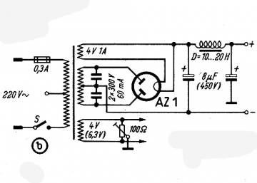

Hi coolzero,
""...Only connection for B+ negative from this rail is 470uf negative to negative (capacitor + to filament's negative and capacitor - to B+ negative)....""
In your diagram, there is already a 470uF capacitor, connected between GND and three resistors.
Did you add one more 470uF capacitor?? If so, could you show it on a diagram please??
Thankyou,
King
The diagram shown is from Jim's site (VT52.com) without a change. What I have now is completely different 26 pre with grid bias. You could find the schematic in this same thread.
Merlin, if you have two diodes only, as in that rectifier, for a full bridge you need a sec with CT or two indipendent secs.
With just one sec, you can implement a hybrid bridge: 1 tube + two ss diodes. See latest andyjevans schematic.
Edit: see post #913
Maybe yes, if only I can find a Man United scarf ;)
Joking aside, I saw you already asked what kind of ss diodes: 1N4007 or better rated at 1.000 V
SF4007 ultrafast/soft recovery are quite nice if you can find them. If not send me a PM with your address and I'll send you a pair.
If you want to use your AZ1 only with a proper Xfrm, pls consider that if you have a 240 V/100 mA sec (let's say), you will need a 480 V/200 mA CT or two secs 0-240V + 0-240V/100 mA each to be 100% equivalent. (That's another reasons why tubes are $$$: you need big Xfrms!)
