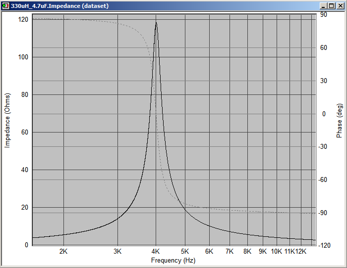

The last picture shows a sanity check. I measured all of the coils using a Wallin Jig II and speaker-workshop as I didn't have an LCR meter. I started worrying that maybe my 10% out was actually a measurement error!! so I paralleled the 330uH with a 4.7uF cap (which I was confident in the measured value of) and did an impedance measurement. The result matched what I got in a spice sim of the same value components, so I was pretty happy that the values are accurate.
