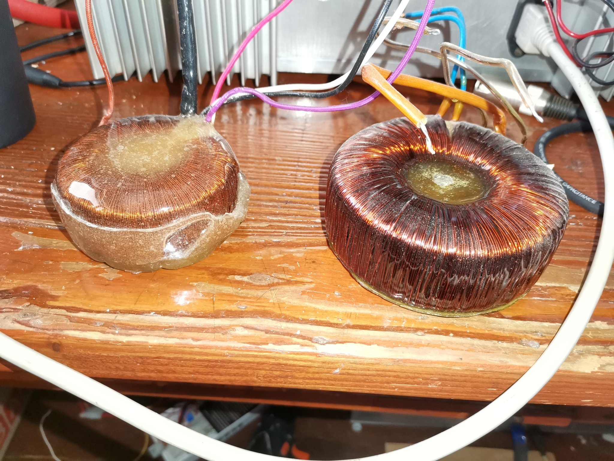

I was ordering my trafos with 20% oversized core, vacuum varnished several times (once for core, for primary and then for secondary).. This reduces buzz to minimum, but it's still there. Nevertheless it's much better than all commercial audio trafos I have bought.
This is OCD issue, with slightest music it's not hear able, but hate the buzz....
I tried DC blocker at mains input, no difference where I live.
I also sealed many trafos in epoxy,and this is very liquid epoxy with 24 hrs settling time, this penetrates deep, first I removed outside wrapping. This also helps, but still it's not zero buzz. Here are examples
Then we have commercial Amp Trafos, mostly EI core welded on corners, and the buzz is even lover than with crazy effort I put in toroids, what's the catch?
