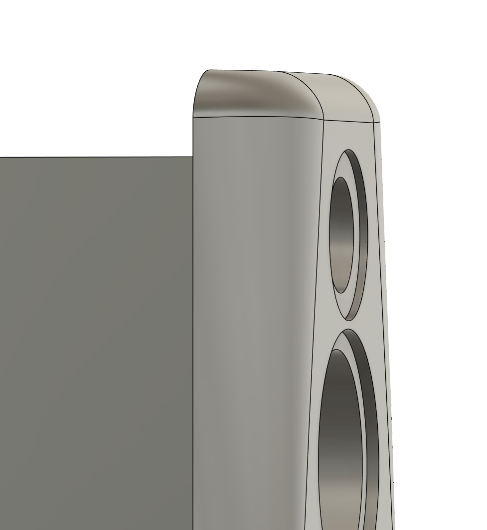

I had an hour in the shed today and got all the braces cut out. Glued up a few things. Got Covid at the moment so motivation is lacking lol.
I have modeled a roundover on the top of the front baffle, same distance as from the side of the tweeter.
Just working on modeling the roundover to the top to match. Slowly getting there.
With rounding the bevel for the mid, As they are quite thick baffles, should i leave say 10mm thickness on the front then bevel at 45 degrees, or leave it thicker?

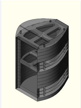

Hi all,
nice to see here the list of tips and tricks, there is a chance to put it together to some expensive DIY book about speaker building
i have only one additional observation to make
with your extraordinary CNC capabilities you may think about building an internal enclosure for the mid range speaker to reduce more the internal resonances like this here
for you of course the external shape is rectangular and only internally you use a drop-shaped cutout for every slice of your internal midrange cabinet
i am unfortunately a looser in CAD drawing and had to take an existing picture that do not fit precisely your needs
hope it helps anyway, Stefano

I think that would be fine. When I bevel the inside hole of a driver, I use a router bit with a bearing, and the bearing needs about 1/4 inch of unbeveled thickness. But I usually leave a thicker section than 1/4" (6.5 mm) to give the screws more material to bite into. So 10 mm sounds about right.With rounding the bevel for the mid, As they are quite thick baffles, should i leave say 10mm thickness on the front then bevel at 45 degrees, or leave it thicker?
