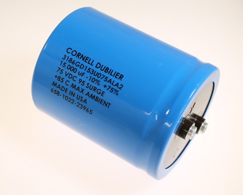

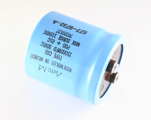

I need a couple 15kuf 75volt low profile cgs style capacitors. Have most manufacturers discontinued them? These are 65mm wide by temp tall. Nothing from Mouser or Digi key.

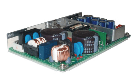

75V is a rarer value, too low for SMPS, too high for computer logic. Most likely aimed at motor and stepper motor driver modules, but for audio use it will have gone away as class-D amps with SMPS's don't need bulk capacitance except at the mains side of the SMPS. Its often easier to parallel smaller caps for lower ESR and lower ESL and better cooling.

Caps have just gone to snap in these days. Lifetimes and ripple current ratings can be just as high. May be possible to retrofit - possibly with a group of smaller ones in parallel to get the form factor, mounted to a PCB, with screw terminals on it.
Is that a Hafler amplifier? If so, which model? Most of the filter caps for the Transnova series were custom-ordered to fit the low-profile chassis. Which means that even when such capacitors were still being commonly manufactured, this particular package style (or shape-factor) was not available off-the-shelf. Unfortunately, I suspect this issue has side-lined a lot of these amplifiers.
The found (credit to Chris) on tedss.com seems to fit your case. Not talking about the price/shipping, but be aware of the suitable height and shelf life of this rare one-piece offer.
