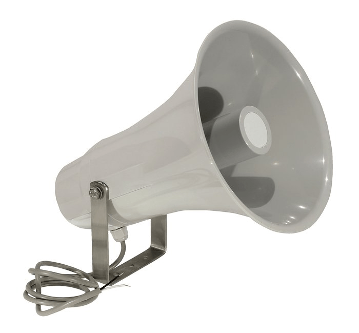

Design-wise, I see few points that might need to be taken care of:
1) It has to be able to get really loud to sound like a bird, especially in outdoor conditions. Some power would be needed.
2) The ambient temperature due to outdoor conditions and related power dissipation issues to be addressed. Solar power means it'd be running during sunlight hours.
3) Fully plastic would not be a good idea if the thermal relief needs to be efficient. A little aluminium maybe..
If I were you, I'd pick a megaphone (horn) as birds do not usually make low frequencies. Horns are efficient and loud and need less power especially when large distances are involved.
Animals make low frequencies using the resonance of their mouth / throat parts, but it is generally hard for a loudspeaker to make bass outdoors without getting large in size.

If you want really loud or efficiency then use larger speaker
such as 6.5" or even 8" weatherproof
Bird sounds are higher in frequency so you can also
use Paging horn for very high efficiency.
Very loud with even low power
Or also called re entrant horn
Many / most also waterproof
Enclosure already made and mounting system also included
Doesnt need to be very large horn for high frequency
but if lower frequency wanted just use bigger horn.

If you use one of those out door horn speakers make sure you get the right one as many are made to work on 70/100 volt systems by default.

Horn speaker driver for re entrant/paging horn is usually 8 ohm
The 70 volt systems come with a line matching transformer
So if you just want 8 ohms
dont use the transformer.
So basically all of them are compatible impedance wise.
Of course the included drivers range in design and cost.
But some are basically a speaker much like yours.
It is just in a enclosure with horn loading for more efficiency

I see some of you have recommended a megaphone instead. Those horns do look promising, but they seem much more costly than what I originally envisioned. I'll keep it in mind for my next build. My current speaker is like 6 bucks or so, and its membrane is plastic (waterproof), so no worries!
