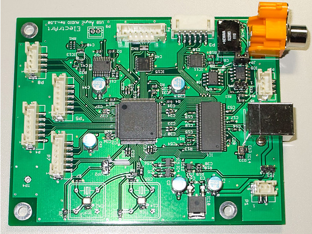

The designer and builder of the USB Dual Audio board, ElectrArt, have two ARDA AT1201 chips and he might be developing his own DSD256 recorder now.
If he presented any progress for the recorder on his blog page, I will introduce it here.

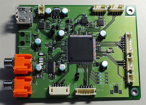

Thank you for intresting information about DSD256 in Japan, I have read all you posts and try to read the ElectrArt blog. The device PCM2DSD256 excite me very much there. The process of transfering the PCM to DSD256 using software is complicated and long. If it will be possible to do on fly it will be the realy bomb! What do you think and knew about this device? What about plans of the ElectrArt to sell it?
... The device PCM2DSD256 excite me very much there. The process of transfering the PCM to DSD256 using software is complicated and long. If it will be possible to do on fly it will be the realy bomb! What do you think and knew about this device? What about plans of the ElectrArt to sell it?
ElectrArt is developing his original hardware-based PCM2DSD256 converter.
The board on the right side is the PCM2DSD256 conversion board.
Input: S/PDIF, I2S PCM 44.1kHz/16bit, 48kHz/16bit - 176.4kHz/24bit, 192kHz/24bit
Output: DSD256(11.2896MHz, 12.288MHz; DSDL, DSDR, DSDCLK, MCLK( ~ 90.3168MHz, 98.304MHz)
He has built a S/PDIF decoder , a Digital FIR upsampler and a Delta-Sigma Modulator into one FPGA chip (Xylinx Spartan 6 or Altera Cyclone III)
He is expected to release the board as a finished board kit for DIY users. However, no finalized release plan is announced yet.
The board on the left side is his "DAC" board. It includes an Analog FIR and an Analog Filtering OP amp circuit (Stereo balanced analog output).
The combination runs as his proprietary "DAC".
Bunpei

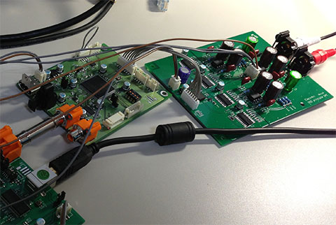

Thank you Bunpei!
It seems very interesting device and I am intching to try it. Hope he will finish it soon. Are you planing to try it? Your opinion will be very important to me. Is it big differences of sound to the software conversion and to native PCM?
Andrey
... Are you planing to try it? Your opinion will be very important to me. Is it big differences of sound to the software conversion and to native PCM? ...
I will try it when the board becomes available for beta-testers.
I have listened to his first prototype connecting it to Buffalo II DAC in synchronous master clocking scheme. Upper stream transport was ElectrArt's USB Dual Audio board. I played 44.1kHz/16bit PCM sources on PC and listened hardware converted DSD256 sounds. My first impression was "Oh, it sounds as DSD256 does sound! Better than the original 44.1kHz/16bit PCM direct play!"
Then I listened DSD256 sources using ElectrArt's proprietary player software "PlayAudio". The DSD256 sources were converted from 44.1kHz/16bit PCM using SONY DSD Direct on PC. I felt the latter, software converted ones, did sound better than hardware converted ones.
Please remember that it's just a result of his first prototype that has never appeared in this thread.

Within my limited knowledge, there are two DIY oriented board kit products that support DSD256 play from PC.
1. ElectrArt's USB DUAL AUDIO(UDA)
2. ExaDevices exaU2I (DSD512 is supported also)
Both kits have USB input and DSD-raw digital signal output. They provide each proprietary player program on Windows, PlayAudio for UDA and LoTech Player for exaU2I. You can't use such generic player as foobar 2000 or JRiver.
Both require USB 2.0 high speed interface.
You need to prepare your DAC device with DSD256-ready DAC module. Possible DSD256-ready DAC modules are;

ElectrArt announced an update for his PCM2DSD converter kit on his blog page (in Japanese).
ElectrArt?Digital Audio???
Bunpei regards the board as his proprietary "Delta-sigma DAC" device because Bunpei could listened a high quality music by connecting a simple home-brew LCR filter to the DSD output of the board.
The board has various input;
1. two S/PDIF RCA and one S/PDIF TOSLINK optical
2. I2S via PS-Audio standard HDMI connector
3. I2S via 7 pins connector
Output;
1. DSD256 for all input [normal mode]
2. DSD256 for 44.1 & 48 kHz PCM and DSD512 for PCM of 88.1 kHz or higher
3. PCM or DSD on input without conversion. [Bypass mode]
One of two types of delta-sigma modulators can be selected.
One of two types of output filters, fast and slow can be selected.
The board can be integrated easily with his UDA board at an input side and his DSD1794A DAC board at an output side.
He confirmed DSD512 can be played without problem on DSD1794A DAC.
The kit will be released early next month if possible. He will accept orders through his web page.
The final price is not decided yet. However, he is making his efforts to keep it in the same price range of his UDA board kit.

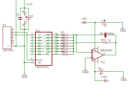

ElectrArt presented his final version of "DSD Principle DAC" on his blog page.
ElectrArt?Digital Audio??? ???????? 1bit delta sigma DAC (In Japanese)
The dark green board at the upper right is his "DSD Principle DAC".
Its schematic is here.
He says the board has achieved a filtering performance comparable to DSD1794A.
To my regret, he has kept the R1-R8 values non-disclosure on the schematic.
He may distribute a bare board.
