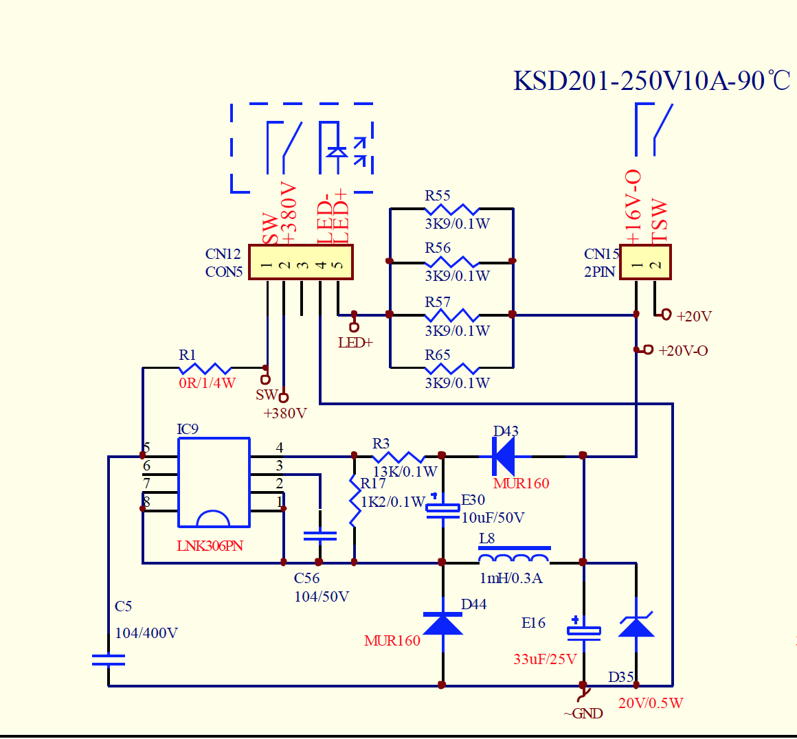

Me pasas pdf schematico..graciasTal vez un poco tarde pero lo he identificado como LNK306PN. ¿Si está colocado en la placa de la fuente de alimentación?

good afternoon you will have the schematic of psu 101A since in my country you can't buy it...thanksTal vez un poco tarde pero lo he identificado como LNK306PN. ¿Si está colocado en la placa de la fuente de alimentación?

good afternoon... will you have psu 101A schematics? since in my country this new plate is not sold or arrives... I am missing the numbering of the 2 integrated soic16Hi, I'm working for that brand to design new product. I can help if you want.

Hi there. Im al Vivian drol South Africa and nzw to this forum. My 3k6 also blew up over the long weekend. Don't really know what the cause was. I'm in nzzd of a schematic if anyone can assist please. Found that rhz power supply module is damaged and 2 fets on heatsink Q3 nd Q5. Thank you in advanceThanks but I actually already got the service manual and schematic which even got examples of components which are better to upgrade to, but they are now obsolete unfortunately. Can you ask for suitable updated alternatives to the ones I listed maybe? I think several users would be happy to know since this amp has been a bit problematic as I’ve understood it. Big thanks for your support, it’s the way to go and make customers happy!
@RBMK1500, Please share access to your YouTube clips? My SYNQ 3K6 does not power up. I have replaced the main switch and PSU module with no luck. Thank you.I made some YouTube clips how i test the PSU Board after changing the defective PFC mosfet.
SYNQ 3K6 load test - YouTube Load Test
SYNQ DIGIT Class D Amplifier SMPS power supply troubleshoot Fehlersuche - YouTube PFC Mosfet Signal
