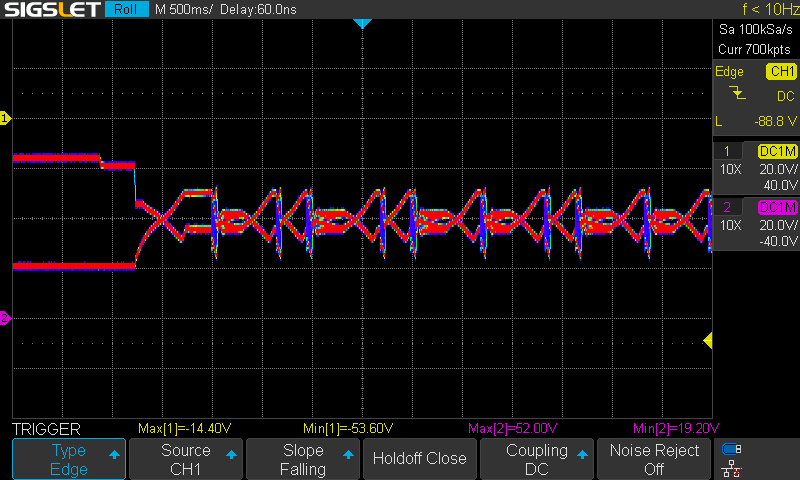

After two months breaking my teeth on it I found that the latchup is caused by the SITs not being switched off fully at powerup. Without the output transistors and the PWM in service mode (R119/69) it works like a charm. Now the latchup causes the power supply to be overloaded. Which is weird given that it would work fine with DBT previously. With the PSU overloaded the two gate supply rails (+/-120 V) don't rise enough to cut off the SITs. Which need more than 25 V to reach that point. I also found that the PWM modulator also goes in a latchup mode due to the current source Q103/53 not starting as its power rail also rises too slowly. I did manage to get it going by removing C155 (I am working on the right channel, left is still in service mode) and using an external power supply to get the gate supplies going. At first it would start reliably when switching on the external PSU but when I started to move SITs around that went south and now it is bursting or even flatlining fully latched up. I don't believe that the SITs are bad. The rush-in current limiters are both OK and when the amp does work properly get shorted with their respective relays. Apart from the plethora of PSU rails the circuit itself is not all that complicated but the chicken/egg situation has me utterly flummoxed. What is going on here and how can I fix it? It must be something silly that I am overlooking but for the love of all that's holy I can't see it.

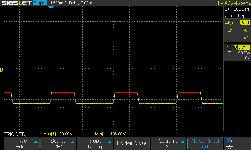

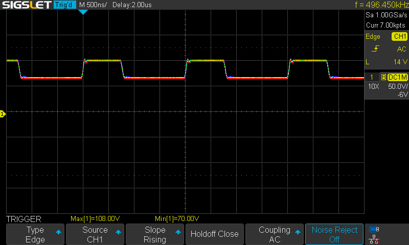

Scope images might illustrate. This is the gate drive of the SITs. This is a successful start with the external PSU:

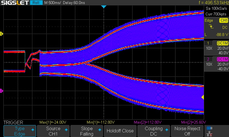

And here it fails:
Once the PSU rails are established the rushin relays kick in, followed by the speaker protect relays. The slow rise is caused by the first stage of the PSU, which builds the primary regulated voltage (240 VDC). This is then fed to the second stage which provides mains isolation and all the secondary voltage rails. There are no less than eight. The PSU has not been touched, only the amp itself has been recapped.
And here it fails:

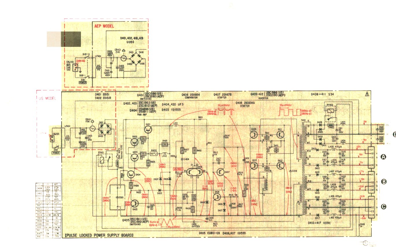

Some additions for other forum members to participate.
The ServMan of the Sony TA-N88 is 48MB, just to large to post here completely.
The ps-page was in need of some brightness & contrast adjustment (small portion left original).
As is visible in the second picture, the supply tries to start continuously, but fails to engage oscillation.

I do. And I have extracted some images like you did as well. Luckily the version I found is a very good scan. I will study your versions. Many thanks!Do you have this ServMan Regenpak? Drop me a pm.
Further analysis.
The ServMan I have has a second section about the 88/88B with more clear pictures. The above is from the first about the 88 only.

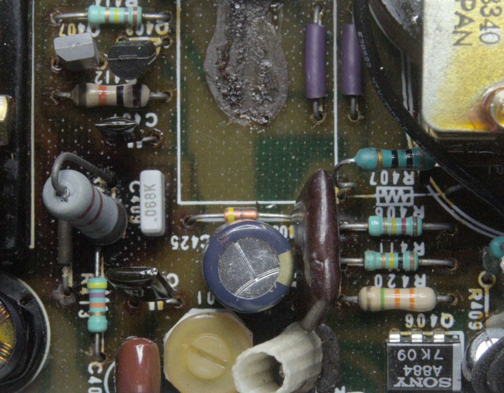

The initial fault was bad resistors and capacitors in the startup circuit for the PSU. I replaced some fried resistors as well:
The PSU came to life perfectly with DBT once this was fixed.

This is not true. The 120 VAC version has a different T402 than the 230 VAC version. The live part generates 106 VDC (US version) or 240 VDC (EU (AEP/UK) version). But the main problem is that the 240 V gets loaded too heavily and is unable to provide the plethora of supply rails with the correct voltage. The cause is of course the DBT but as said the power rating of the bulb does nothing to change this behavior. Whereas with a 60 W bulb it started up without any issue before the recap. The PSU even has its own "DBT" built-in: surge current limiters TH401 and -2 which gets shorted out once the power rails have developed enough voltage to energize relays RY401-2.But also: the smps is able to cope with 120Vac (US) and 220/240Vac (AEP/UK) models without voltage selection switches...

That's very curious...C155 was a film capacitor. Removal brought back some life as illustrated. With it in place it consistently would go into latchup mode.

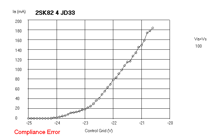

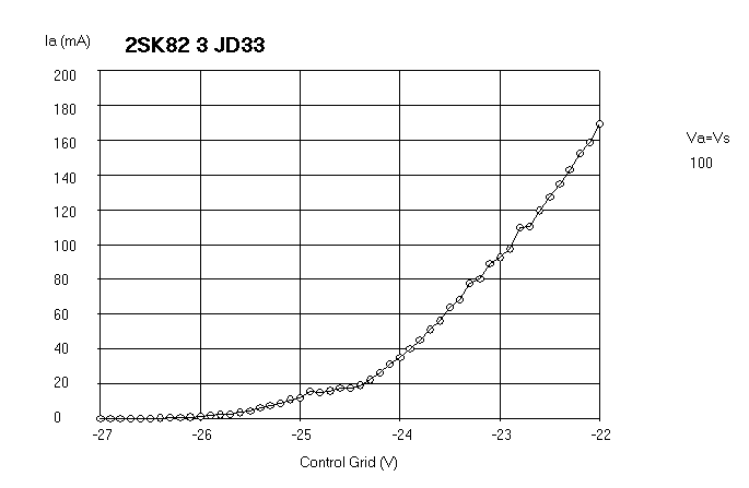

The SITs differ but that is because of V(gs) spread, even though they have the same ranking:The +/-78V rails are the true 'power rails', so if these are roughly at 50%, something is drawing a lot of current, and heating up.
I now test with only a pair in place and even then I get different results as I swap SITs.
The PSU has been fixed and now I will concentrate on the +/- 77 V rails.

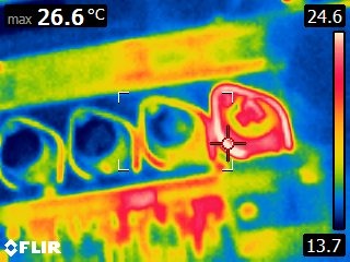

One would expect the middle ones to heat up most, not the one on a side with such a difference, even 'spreadwise'.The SITs differ but that is because of V(gs) spread, even though they have the same ranking:
I tested the same ranked SITs on my µTracer 6 and they differ very significantly:One would expect the middle ones to heat up most, not the one on a side with such a difference, even 'spreadwise'.
In the fault condition the transistors are in their linear operating area which means that the transistor with the lowest V(gs) (here #3) carries all the current. With the amplifier in class D this obviously doesn't happen.
