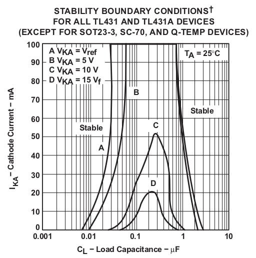

Digging in the TL431 datasheet I found the stability boundary conditions graph (see below). The relevant conditions for my circuit are the "B" curves. I'm operating the TL431 at 2-5mA and the pass mosfet has a high-ish input capacitance between 2.2-2.8 nF. In these conditions the TL431 may become instable with as low as 9nF capacitance. I have not yet tested the snubber arrangement suggested by Marcel as I'm not sure of the advantages of having a capacitor acros AK...
