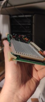

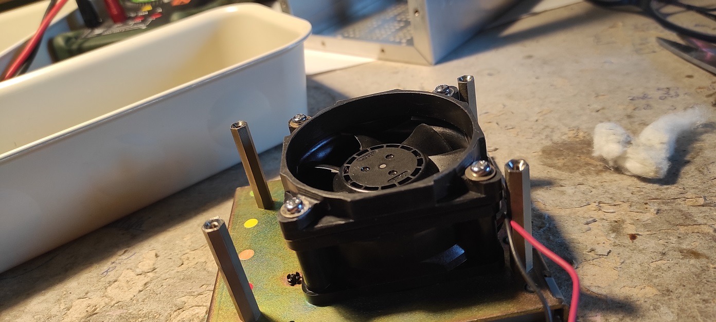

I finally managed to get the DSP working . The problem was, as I suspected, a fried signal processor . The replacement finally arrived and after connecting it without any excuses, the measurements in THD1 mode begin to appear. I replaced the blower and added an extension made from the old one, because it had some strange dimensions of 33mm wide.

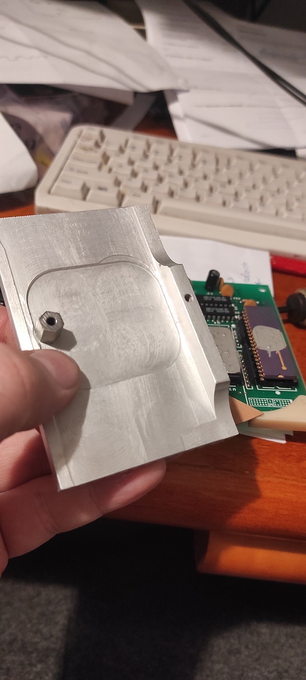

I also added some heatsink to cover the PROM and CPU as it gets quite hot at 20MHz.
