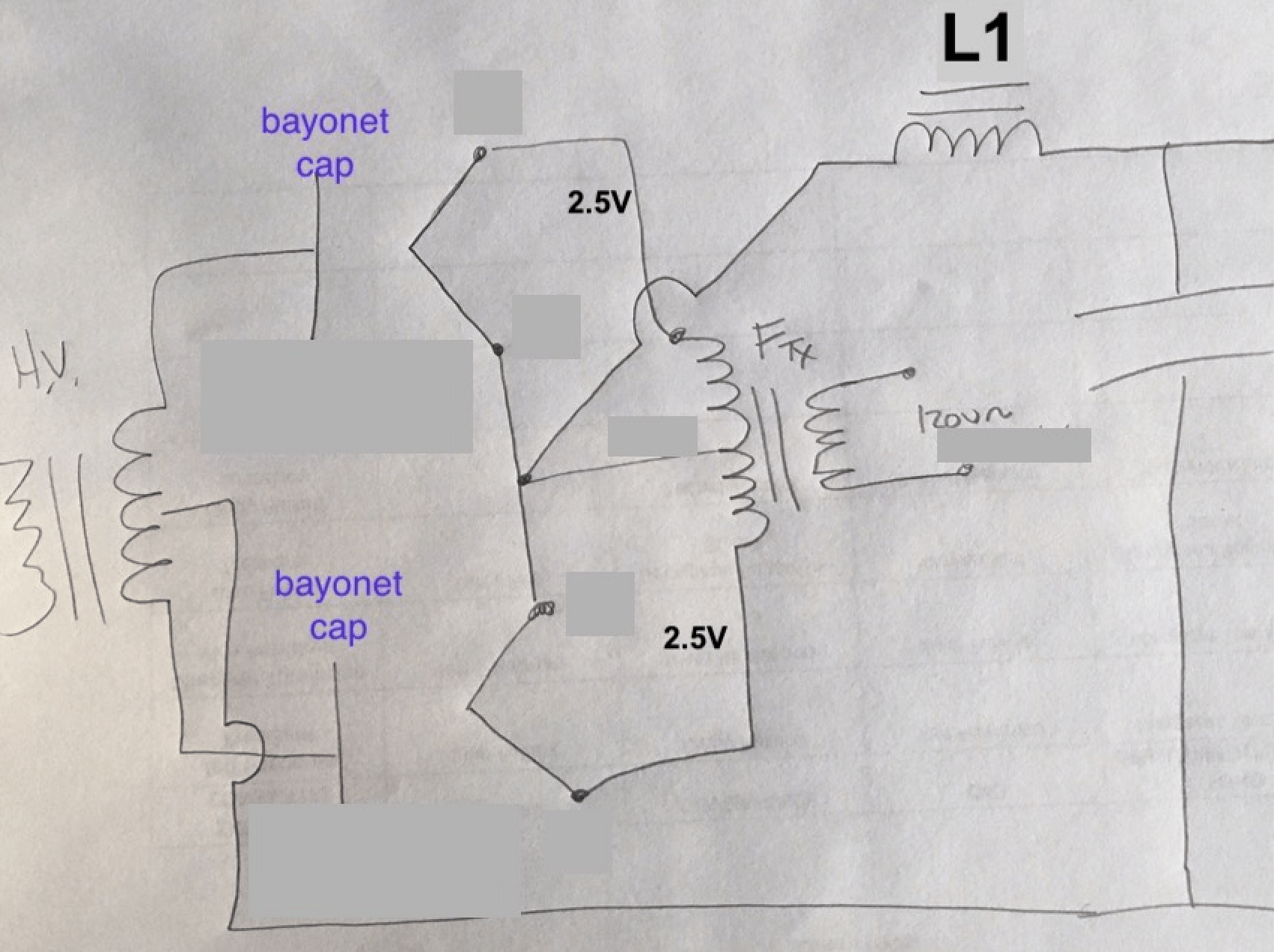

So, when the amp is power up (after 2-5 minutes of filament warm up for the 866A rectifiers), the B+ ramps up nicely to ~460Vdc, then immediately reverses back down and settles at ~180Vdc where is holds steady. I expected the B+ to stay steady at 460Vdc. One of the 866A rectifiers is lighting up a nice blue glow, the other does not. I tried switching the tubes and the blue glow stays with the socket. This tells me this is not a tube issue. I also tried new 866A tubes and the same behavior. The filament voltage measures 2.5Vac, per spec. My filament wiring config is attached.

Are there thermistor(s) for both the High Voltage transformer, and the filament transformer?
If there is only a thermistor for the High Voltage transformer, check to see if Both filaments are lit after the power supply warms up, and the B+ voltage is collapsing. If they are still lit, Both the filaments are still hot . . .
That would mean that either the B+ thermistor is bad:
Or the B+ primary windings or secondary windings has a bad wire,
Or there are bad connections from the circuit to the B+ transformer.
I guess L1 windings could have a bad wire, or the connections to it.
You are loading the B+, right?
Otherwise, the supply is operating as if it had a Capacitor input filter 1.414 x Vrms to the plate.
When loaded, a choke input filter only outputs 0.9 x Vrms to the plate.
1.414 / 0.9 = 1.57 ratio of cap input to choke input B+. Ratio = 1.57
Your ratio is: 460 / 180 = 2.56
(I did not account for the small voltage drop of the plate to filament of a Mercury rectifier).

Update:
1. Thermistor was removed. No change in behavior.
2. B+ is loaded
3. Both 866A filaments are still heated when behavior occurs. I can see the glowing filaments
4. Only one of the 866A tubes has the blue glow when B+ is applied
5. Tried increasing the load by increasing the Rk. No change in behavior.
6. Install a 300k resistor from 866A to ground. No change in behavior.
6A3sUMMER - how would I test for a bad B+ winding wire?
Other thoughts?
