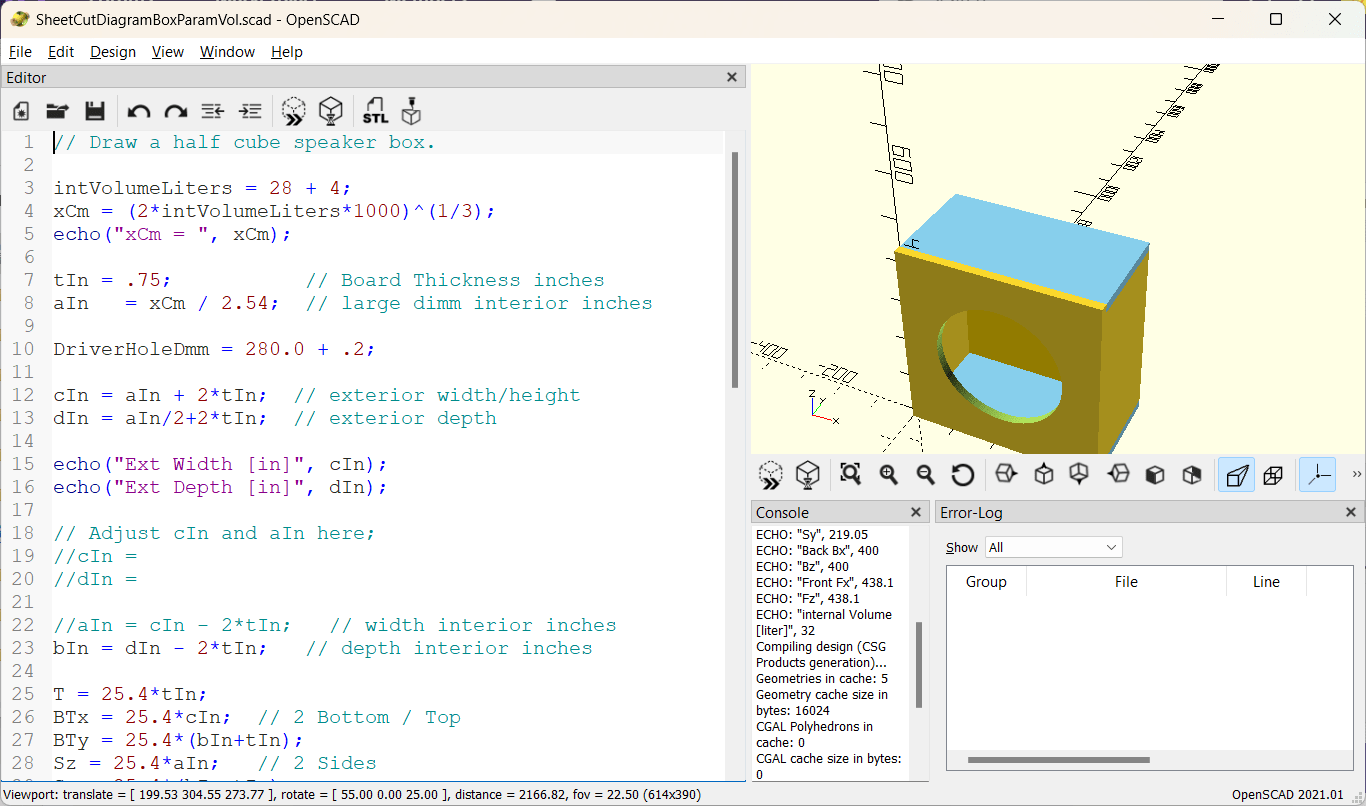

I use OpenScad. It's free. It is a code based. So you write a script that calls simple functions to make the drawing. Here's a drawing of a half cube shaped box. That's pretty much all I build.

I got started using Autodesk fusion360 a couple of years ago only to discover that "Free" meant I could only save a few designs up to their site and they would be public. I also got non-top calls from the sales department and they eventually ended my "Free" license. So that was a total waste of time for me. I used the Salome package years ago as it came loaded with a Linux distribution that I would run in a virtual machine. It has likely improved all these years later. It linked with an FEM program. Starting out now I would look at Freecad, as they have fixed some of the major problems in the last two years. I like openSCAD as it generates the whole drawing from beginning to end from the code. So I can just change a line of code and get what I want. It is pretty limited compared with other packages.

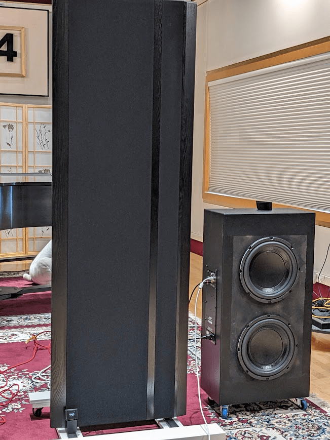

Have a look at the drawings I uploaded in my earlier post. They are parameterized so you can generate a box of any size. The woofer box has maybe five different sizes in the code. You uncomment the three lines of code associated with the box size you want. I also have a 3D printable waveguide. It is printed as two halves, upright. The install is small. You can delete it easily if you don't like it. https://openscad.org/downloads.html Drawings are made using function calls with parameters for the size like this cube([[3, 4, 5]); will draw a 3D box of size 3 x 4 x 5. That's it. The translate() function moves it to where you want in the drawing. The two box drawings print out the dimensions for each board to be cut to build the box. The larger box has a rectangular cutout for installing a Hypex Fusion FA253 amplifier and holds two Eminence LAB 12" woofers. A set of these were built to go with some Magnepan 3.7i speakers.

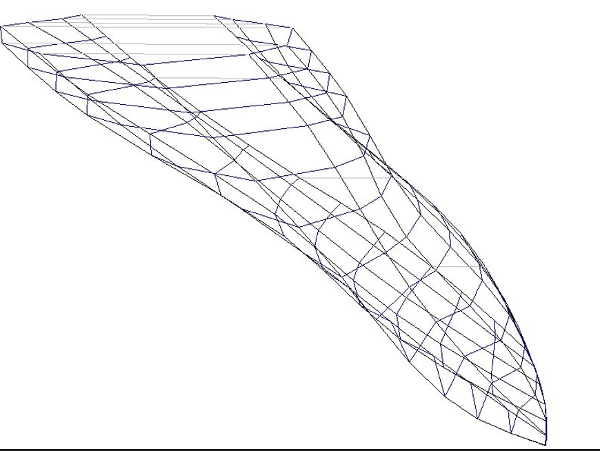

Done entirely in Carlson hull in a couple of hoursSo @Randy Bassinga , boat interest or just using an applicable tool?
Another in the works, Klingon warbird inspired central nacelle for an ultra light solo WIG. This is what Calson Hulls outputs as working model. One day this thing will glide a metre or two over the chop on airfoils. In developable fabric inflatable RIB
