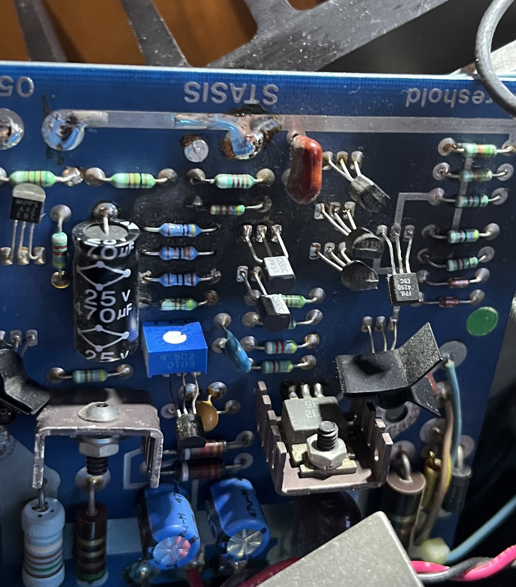

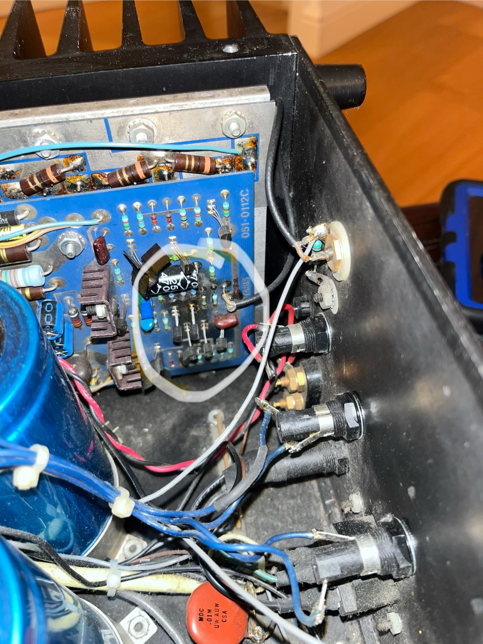

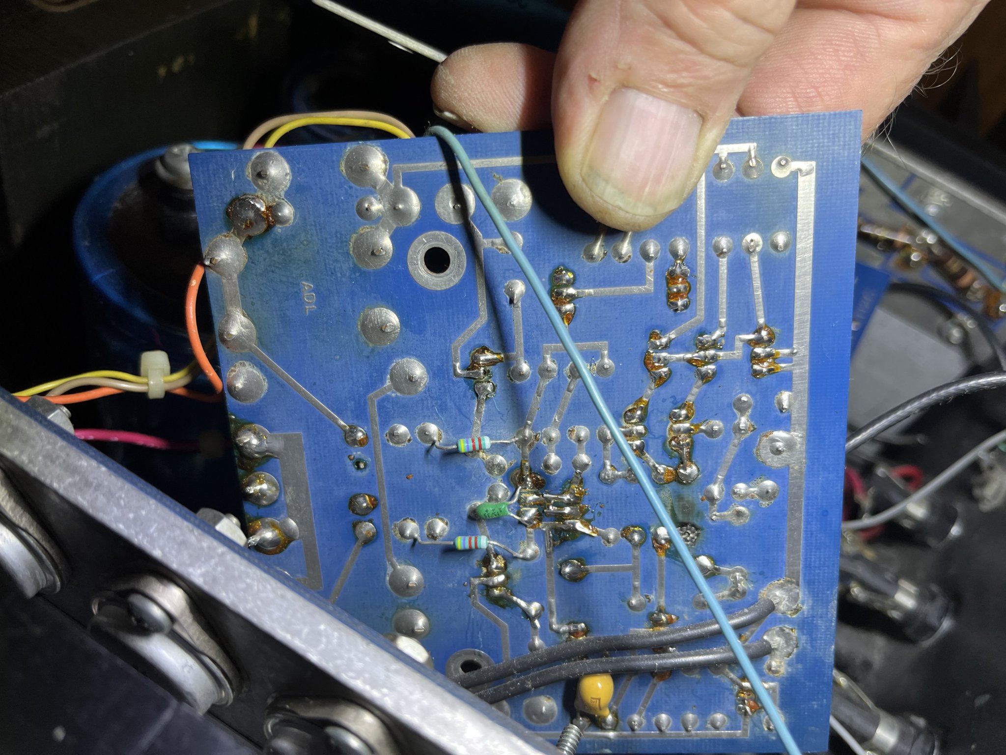

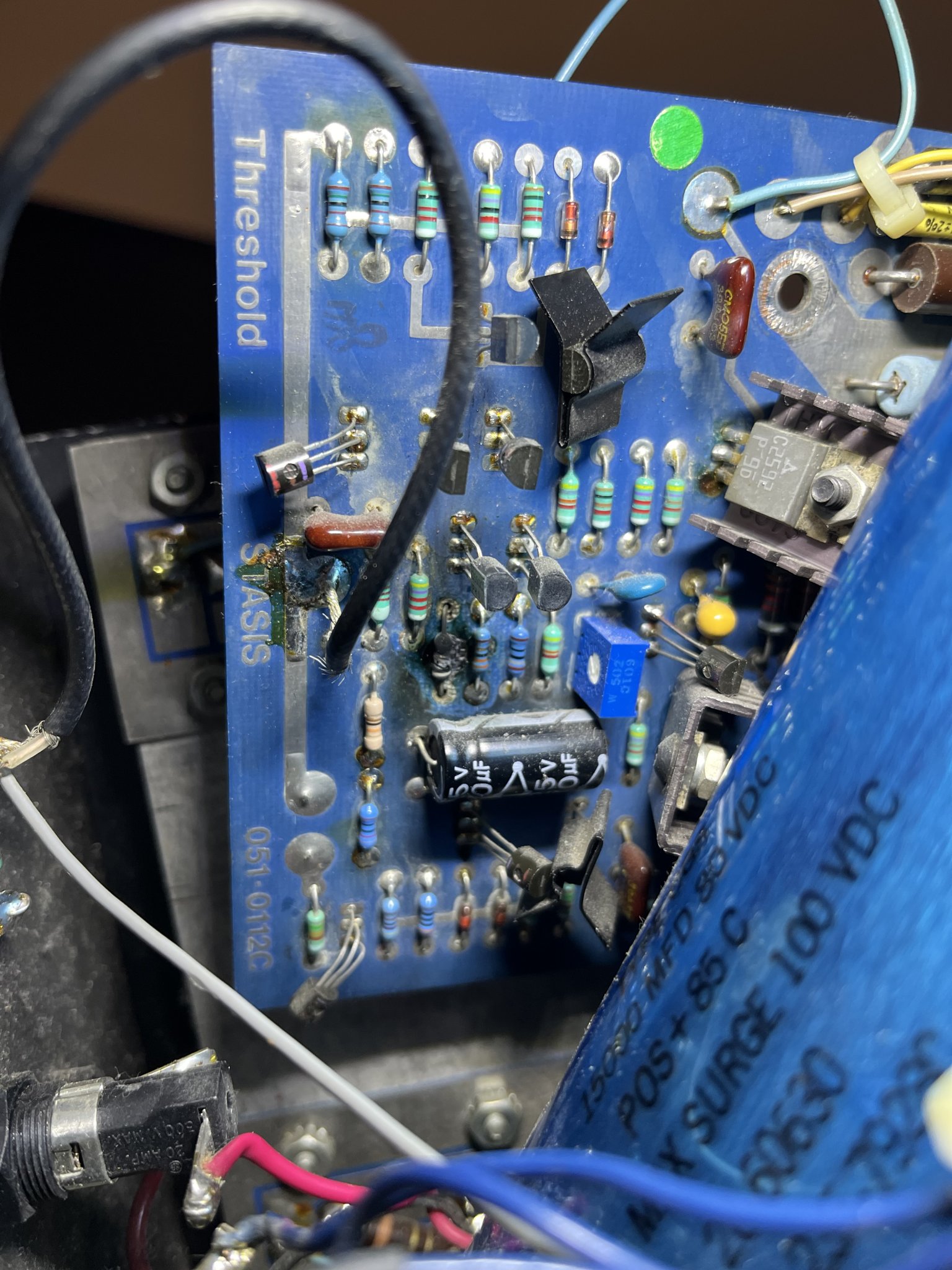

Hi Gents.
Recently bought this Stasis 2 as faulty ( the only way I could ever afford one )
Symptoms were : slowly over time was brought up to 240v using a variac , then used for a week until smoke was seen and then the left channel went down.
I’m no engineer but I can replace parts so I’m hoping someone can steer me in the right direction.
Any idea which component(s) have failed and caused the burn ? ( see photo also )
Any assistance would be greatly appreciated.

I would start by looking for a schematic and posting it here. Then I would clean the bulk of that smoke residue off of the board to try to decipher where it originated. Could be the 25/470 cap, could be a resistor.
To clean the board, you can use a Q tip and isopropyl alcohol. Also, make sure it is unplugged and confirm that the voltage has left the caps in the power supply.

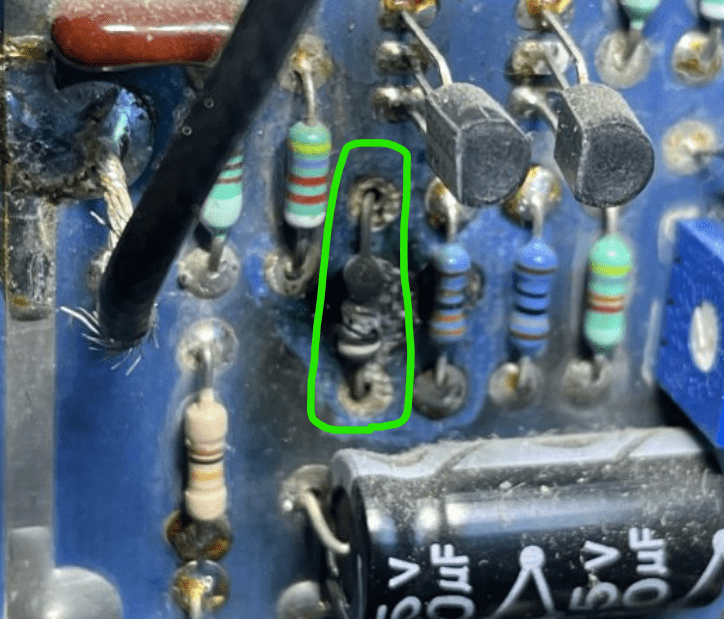

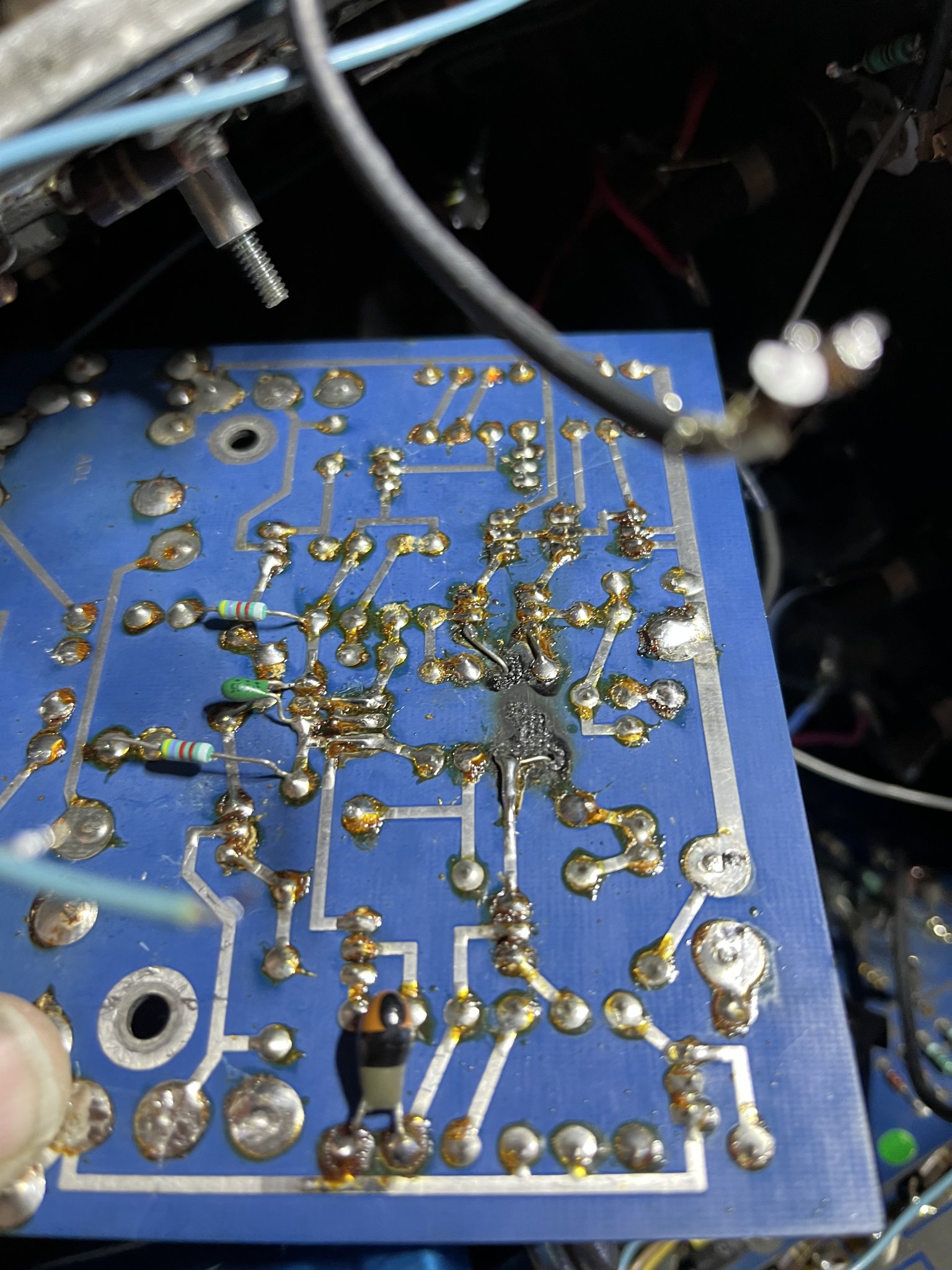

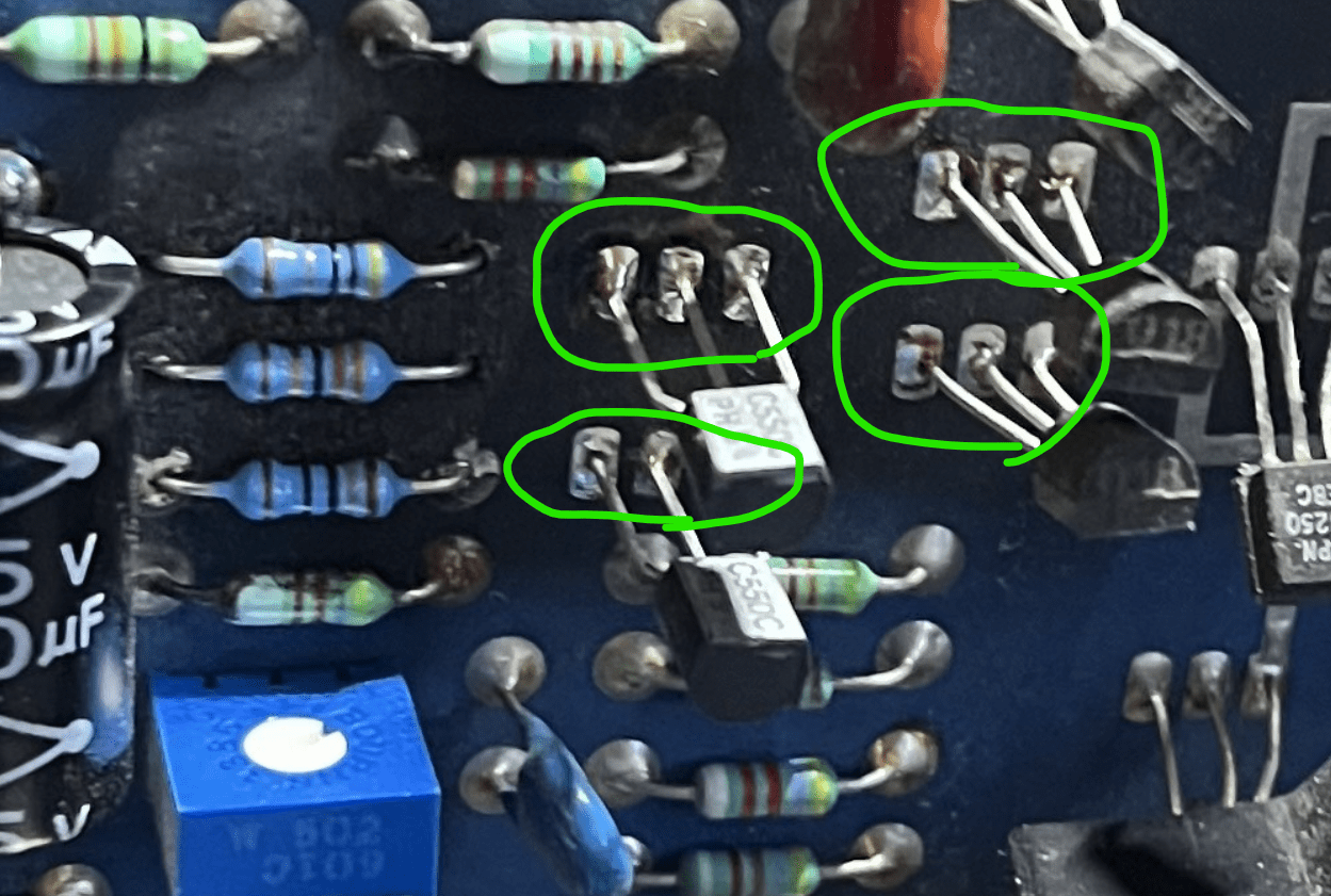

The second channel looks as though it had never been repaired before. It looks like this resistor was pulling some serious current:

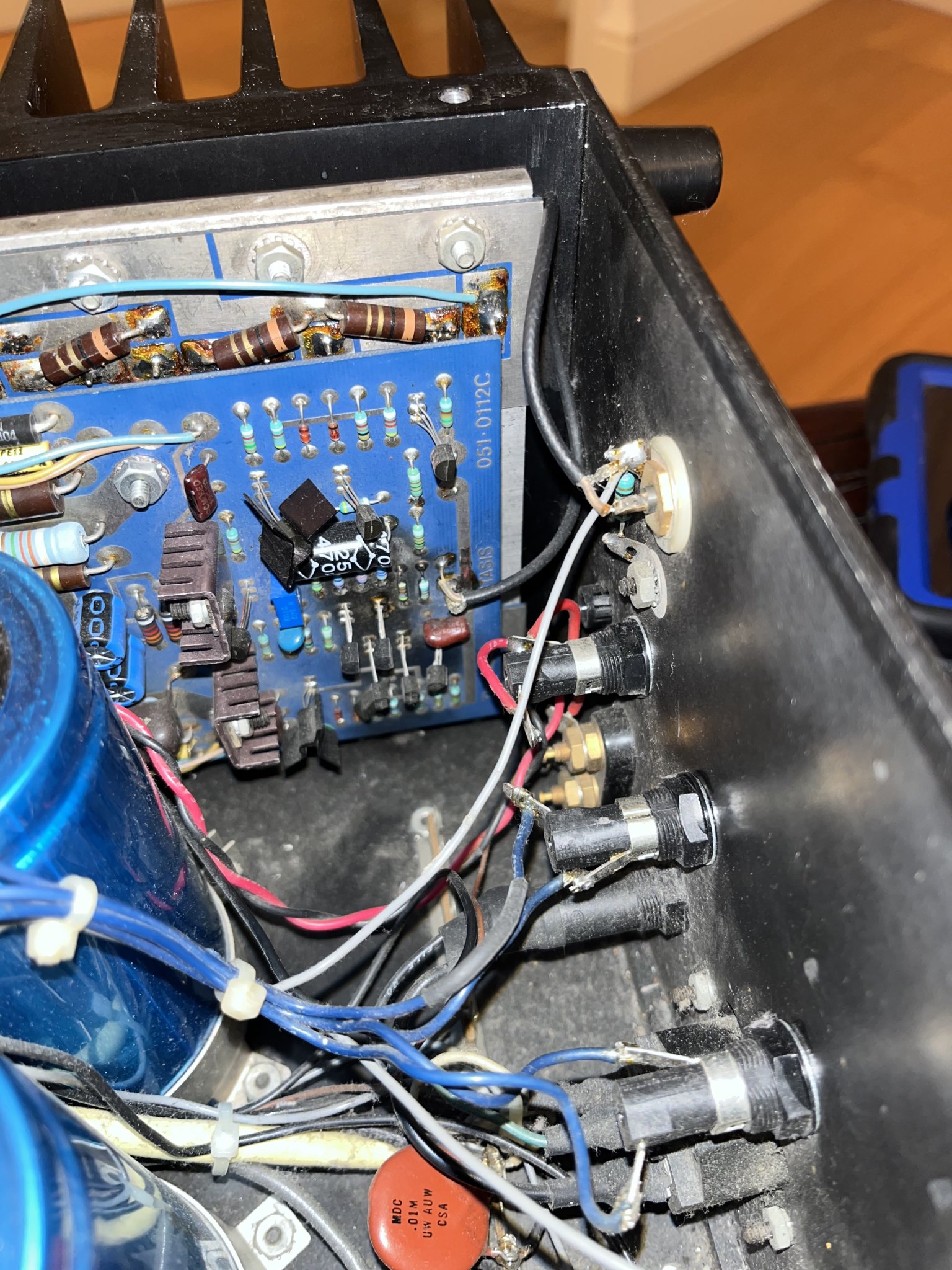

The first channel you posted looks to have been repaired after a part had blown:
The solder joints look to be shiney and new'er' on the first channel:
so the first channel may work. You can get a dim bulb tester or a variac and try to bring that channel up by itself slowly. The first thing that I would do is to start identifying the componants in the circuit and where they are. These old boards do not have a silkscreen which makes things a bit more difficult.

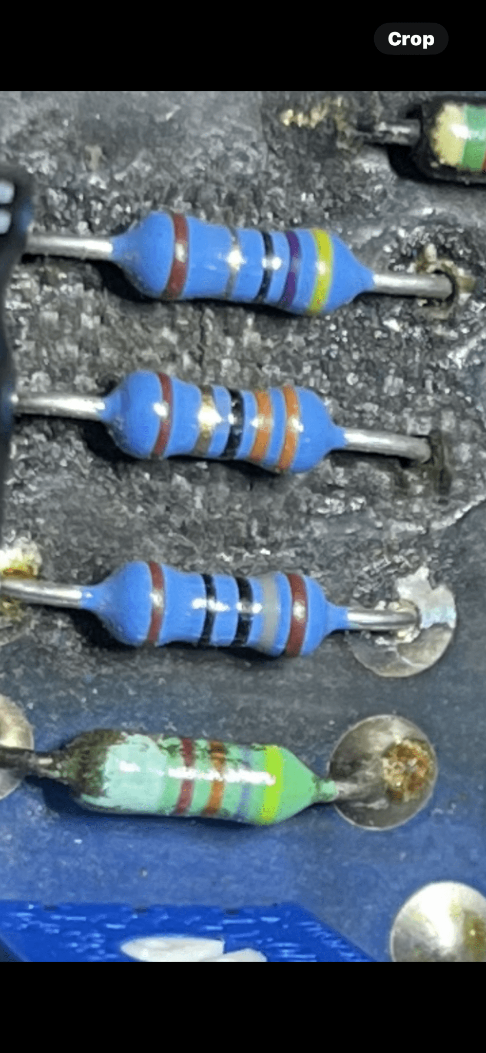

You can use the color codes as well as a multimeter to check the resistors. If a multimeter is slow to give you a ohm reading, you may have to lift one lead and retest. So to start off with, identify the resistors usign the resistor calculator I linked to and confirm that the resistors are within say 5% of that.
Once we know what is blown as far as resistors, we can see what active devices they are tied to and test those devices seperately.

Sorry Mike , forgive my ignorance. Do I count all the bands on the resistors? There are silver bands that are not in the calculator?Interesting. I suppose it is time to start idendifying the culprits.
