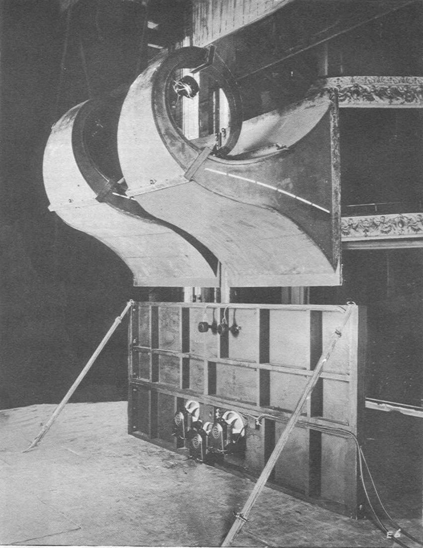

Western Electric figured out the baffle size thing 100 years ago

Wow. Love the picture.Western Electric figured out the baffle size thing 100 years ago
