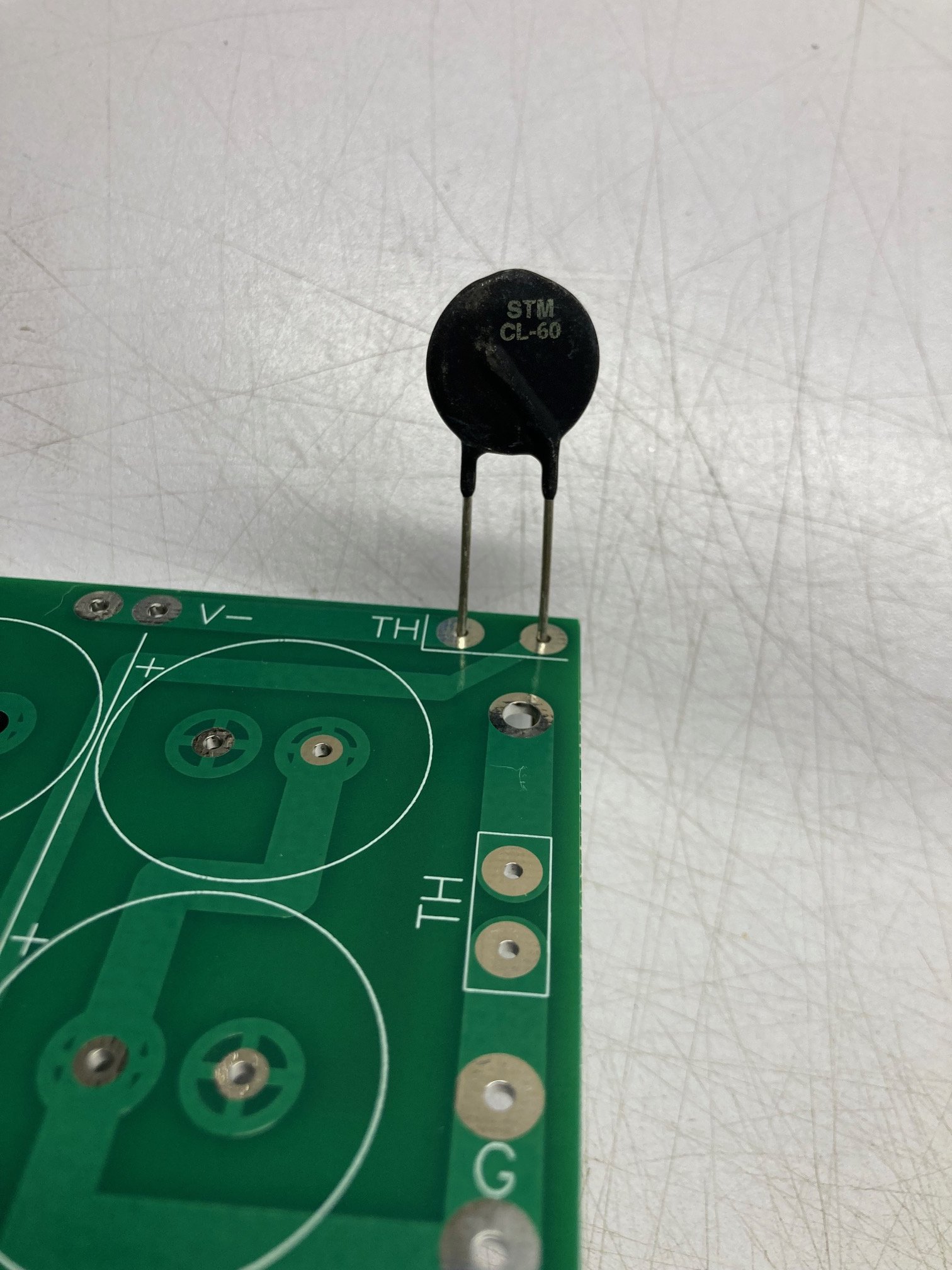

My essentials kit came with three of the mid-size EPCOS 10 Ohm NTC thermistors (Digikey PN 495-76260-ND) and one bigger green SCK 108. I have the V1R1 board which uses four thermistors as rail filters, one as a circuit ground to earth ground isolator, and I'll need another on the primary to stall the inrush.
I have a quad of Amphenol CL-60 thermistors (Digikey PN KC006L-ND). Can I use these in place of the EPCOS in the rail fliter position? Both parts are 10 Ohm and rated 5A, but it's not clear from the spec sheets if their rate of change of resistance, or steady-state hot resistance (180mOhms for the Amphenol part, none given for the EPCOS), is the same, or if this matters in this applications.

Hi Anand,Because the CL-60 at mains/live inlet serves a different purpose than the much smaller thermistors on the PSU board.
When the power is first turned on, the transformer will draw significant current for the first few mains cycles as the magnetic field builds within the transformer core. The inrush current can reach several hundred ampere, which severely stresses the transformer. Furthermore, to accommodate the high inrush current, the mains fuse used to protect the transformer and connected circuitry must be grossly oversized, which limits the effectiveness of the fuse in the event of a catastrophic fault in the circuit. The CL-60 NTC resistor solves this issue by limiting the inrush current thereby saving your transformer. The amount of current that is drawn is directly correlated with the amount of capacitance in the power supply itself as well as the size of the transformer (in VA). Remember at first turn on, the capacitors are empty so the current draw is very high. If you didn't use a CL-60 or similar thermistor, especially with transformers that are >300VA you will hear a very authoritative growl from the transformer itself as the electromagnetic forces build up.

First of all, I don’t have a kit and I don’t plan on getting one (I’ll be building my own F5m with existing F5 boards).
Member ranshdow just posted the Digikey part number for the TDK thermistors used on the supply board (these are the original ones I believe). There are charts and graphs on the pdf datasheet with that link. You can see how low the resistance once fully biased. There are also 5 ohm NTC resistors which are rated for higher currents.
The steady state resistance once the amp is fully biased does matter since too much resistance will render a bigger voltage drop and hence lower rail voltage and of course lower power output. So the small TDK/Epcos ones supplied should be the right ones.

I bought a few of the epcos therms in the 4R7- 7.5A version to play with but hadn't pulled them out of the bag until today. I've been running f5m channels with an Antek 4218 - 64,400uF per rail CRC instead.
So, seeing the questions raised again, I placed a parallel pair of CL60's between the PS and one channel, with a parallel pair of Epcos 4.7R between the PS and the other channel. Both biased to 1.3A.
After several minutes with everything fairly settled, I measured a voltage drop of ~ 1.6V across the CL60's and ~ 0.85V across the Epcos.
I repeated the experiment with a single device per side and as one might expect, with twice the current and twice the resistance, the results appeared to be on track to match the first run... but with considerably higher temps.

The thermistor hot value resistance will be inversely proportional to the amount of capacitance you have on the PS PCB... (more capacitance will allow for smaller "hot" resistance), while at the same time, it (the thermistor) will need to sustain the constant class A quiescent current run and not get dangerously hot.
But with most of the DIY-ers going for double the original total PS capacitance, a hot thermistor resistance value of max. 0.2 ohms is what I'd aim for.
