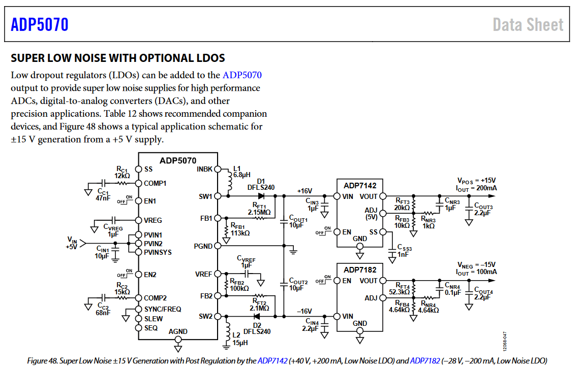

I'm designing a +-15V dual rail low noise power supply, 200mA mini per rail. A first version was the classic design with tapped transfo and a pair of LM317 and LM337 regulators. But because of the price and size, I want to make it with no transfo.
I'll use a 9Vdc or 18Vdc SMPS. First idea was to use buck / boost dual (positive and negative) converters. I find some IC's like LTC3265 (perfect ICs but not enough current, and really expensive!!), LM27762, TPS6513x, LT8335... But not easy to choose the good one and the corresponding architecture.

Hi Ben,
Never use Buck-Boost in audio as they are noisy switchers. When talking about low noise, the SMPS has no place.
You can realize the +/-15V with some of TI ultra low noise LDOs . In this table - https://www.ti.com/power-management/linear-regulators-ldo/products.html#sort=238max;desc& , you can choose the best ultra low noise LDO for either positive or negative rails.
After your +/-18V SMPS, use good filtering, then use the desired LDOs for +/-15V. Don't forget the good SMPS shielding.

A common mode choke in the output from a SMPS will filter out the noise but will work best if the switching frequency is relatively high - >50kHz.
I guess the same would apply to a buck/boost converter but find one with a high switching frequency and be prepared to enclose it in a metal cover (eg thin copper sheet from Amazon)
On the other hand, for a15v 200ma suppy, small dual 15v 5-6watt toroidal transformers are snall and cheap.

You might want to look at the LT1965 and LT3015 which are newer and lower noise and very low dropout voltage. Available in 5pin TO220 package.Hello,

The MeanWell PD-2515 costs $16.92 at Mouser (link). Sometimes it's in-stock at Amazon, other times not. PD-2515 an SMPS, 107 x 61 millimeters in size (4.2" x 2.4"), takes in 115VAC or 230VAC, and puts out both +15.0VDC and -15.0VDC at 800 milliamps each. Because it's an SMPS, it's fully self-contained, you don't need an external power transformer. The Mouser sales pages includes a link to MeanWell's engineering datasheet.
If you wish, you can follow PD-2515 with a pair of diyAudio Store SMPS_DC_filter cards (here's their page) for HF noise removal. Or, if you seek even more elaborate filtering, substitute a pair of "AmyAlice" filter cards, which you assemble yourself as a true DIY project. Forum Search will lead you to the AmyAlice discussion thread if you're interested.
