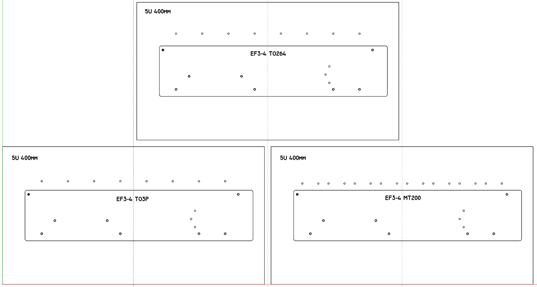

Really happy to see the group buy is going so well! This is just to let you know that the heatsinks of any of our 400mm deep (3U/4U/5U) Dissipante or Mini Dissipante chassis heatsinks can be customized to accomodate the Wolverine boards. It's a simple as adding this product to your cart and selecting the output in the dropdown menu https://modushop.biz/site/index.php?route=product/product&product_id=811
It only takes us a couple of days after you place your order to ship everything as each heatsink is drilled pretty quickly. In the next hours each member who partecipated in the group buy will receive a special coupon code from Stuart to get an extra discount
