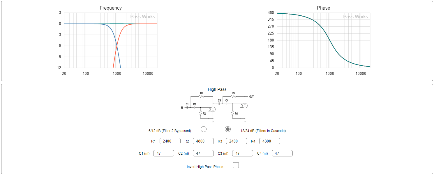

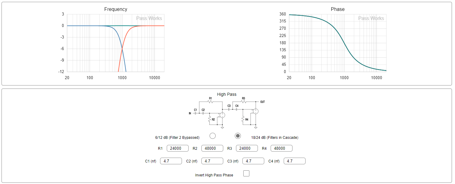

Would it affect the circuit performance to use for example 47 nF and 2,4k instead?
It would change the crossover center point frequency.

I too had this question, but decided not to ask. I'll stick with the convenience (for now) of the 50k trim pots.Hi. About example component values. For 1000 Hz cutover the examples uses 4,7 nF and 24k base values for xover comps. Would it affect the circuit performance to use for example 47 nF and 2,4k instead?
Are you asking because you are concerned about noise? For what it's worth, the resistors are low noise (max. 1.5 μV/V for R > 1 MΩ) as per data sheet. I suspect if keeping the pots, most noise would be generated there?
Yes, maybe to give some benefit to thermal noice but mainly because I have built other xovers with those values so I have alot of comps to match from. Those were opamp based so my question was more about if this circuit would be affected in terms of current/drive issues related to those values. My plan is to breadboard with fixed values and compare.

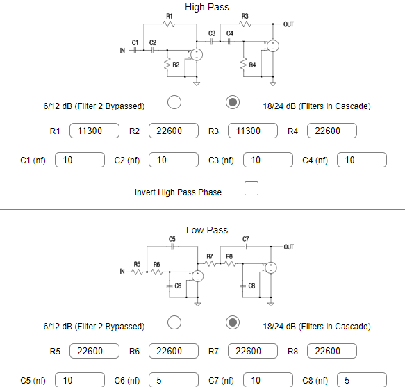

So what do you guys think of basing a fixed xover on:
Dale CMF5511K300FHEB 1/2W 11.3Kohms 1% and Wima FKP2C021001G00HSSD 63V .01uF 2.5% using one resistor for R1 and R2 and two serial resistors for the rest and one cap on every position except C6 and C8 that get dual in series?
Exact center point for crossing over is less important then phase alignment etc, but I aim for ~1000 Hz.
Easy to source and decent quality for the buck and only two models.

Novice here, so take my thoughts with a grain of salt. I think limiting to a couple of resistor values would be fine for a "good enough" approach if you aren't super worried about perfect phase alignment. These simulations work obviously as technically correct if your drivers and cabinet had perfectly flat responses.
Of course in the real world, if you are concerned about good phase alignment you will need a full suite of near and far measurements of all drivers from 0-180 degrees around the speaker, crossover component values optimised by simulation software and using ears from there. After all that, those resistor values will not be looking so neat, surely.
