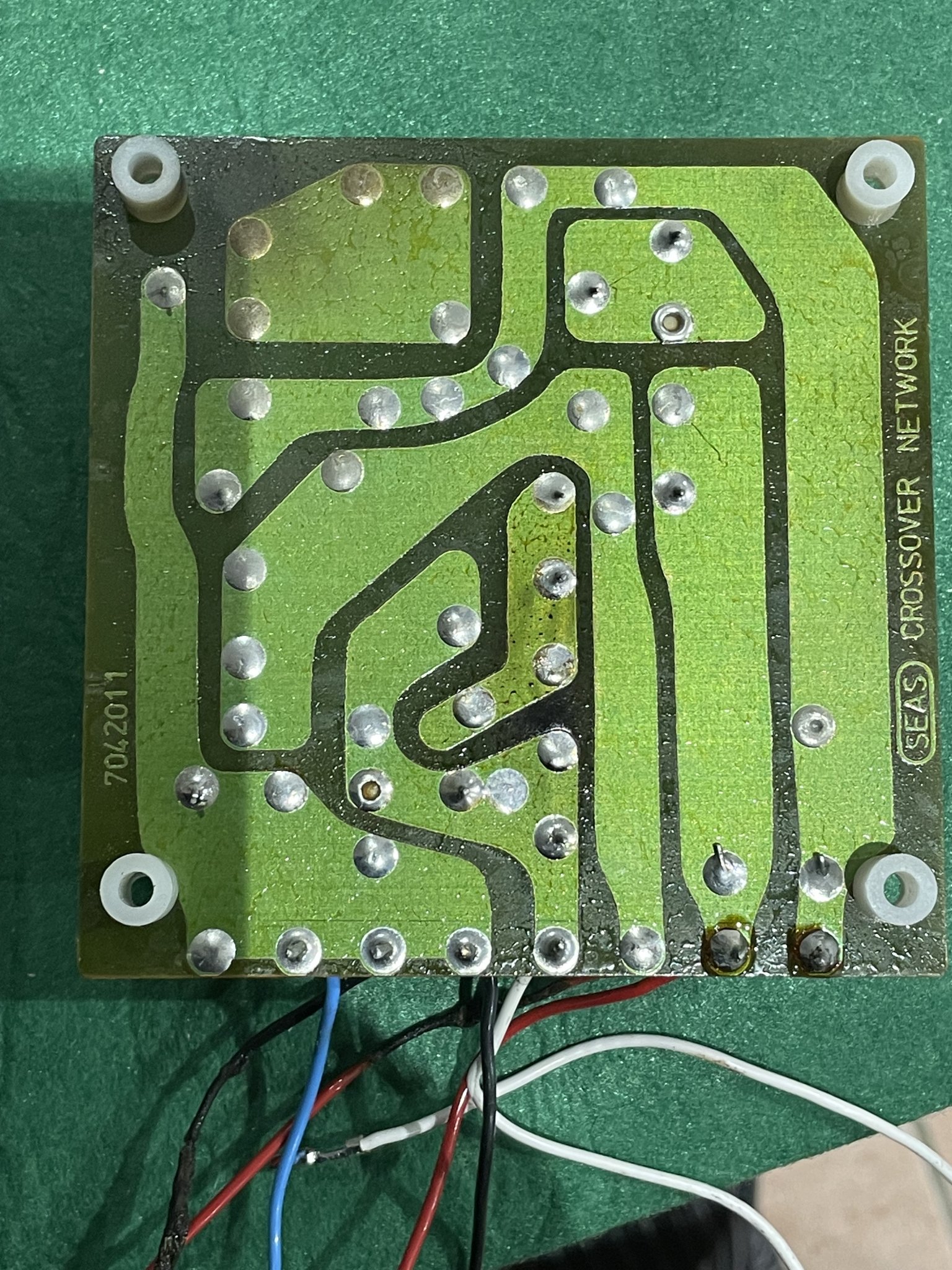

Hooked them up and realized one speaker was quieter than the other. So did the usual and ascertained its the speaker not amp or anything else. Took them apart and saw to my dismay that the 2 woofers are covered in oxidation so that needs doing. Then noticed that the crossover looked a bit cooked on the one that was quieter. So I set out to try to ascertain all the values. Not so easy , so I hooked out the other crossover only to find it has different make caps etc. A bit odd as I bought them new so no one has fiddled with them.
So, I’m struggling to see what size the Inductors are. I can read the Caps on one crossover ok so that good. Also the resistors on that board , not so easy on the other board. Both the air cooled Inductors look ok and I’m to understand they rarely have a problem.
So here is the information I can see. Hoping someone on here can work out what I need to buy …
Crossover 1 :Has a sticker which reads : D 093 P 8ohm, 2-way 3120176, fc: 2000Hz.
Inductor; 6F8 5%
Caps 1; CEO 2SP 50V 12mF (K) The m is actually the symbol for micro but can’t find it on my keyboard.
Caps 2; CEO 2SP 50V 8mF (K)
Resistors 1; RGB5 10 Ohms J Noble62
Resistors 2; 5W 7 Ohms J Micron86
Crossover 2:
Inductor; can’t read at all
Caps 1 ; 12mF 50V
Caps 2 ; Can’t read till I remove it.
Resistors 1; D(ohms symbol) C. 811 4R7 5% 5W
Resistors 2; can’t read at all.
I will upload a photo of the crossovers. I have more photos if anyone needs extra.

For some reason you have two wires that look like they overheated, where they shorting inside the cabinet and did you have to pull them apart when you removed the drivers from the cabinet?
The fact that the wires look charred may have caused the caps to let loose along with the overheated resistors.
Back to the crossover, I can see per board: one coil, three resistors and two capacitors. Not two coils?

Raymondj, No I didn’t pull them apart but it could’ve done when I pulled the woofers out.
Ah I thought the black looking tubes were inductors . I didn’t think you needed 3 resistors on a 2 way? Shows how much I know 😬…

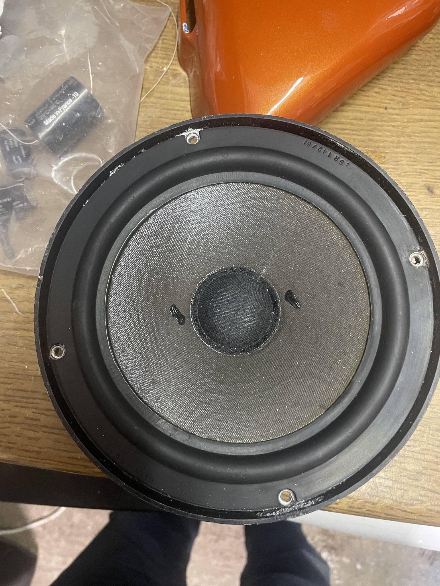

Ok so just popped out to garage and checked the speakers and both woofers are reading 8 Ohms as specified on their labels. One of the tweeters is measuring 6 Ohms as specified but the other is only 2 Ohms. I presume this means the tweeter needs to be replaced - or in fact both so they match.
Both the woofers are moving freely and also looks like the tweeters move ok too. Is it possible to repair the tweeter?
Also measured the resistors and the 2 black wire wound ones both measure 3.8 Ohms.

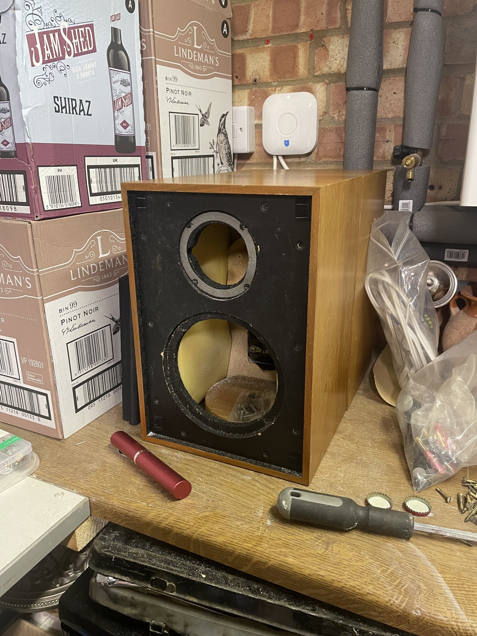

What pictures specifically would you like?
The box, the front of the woofer.
