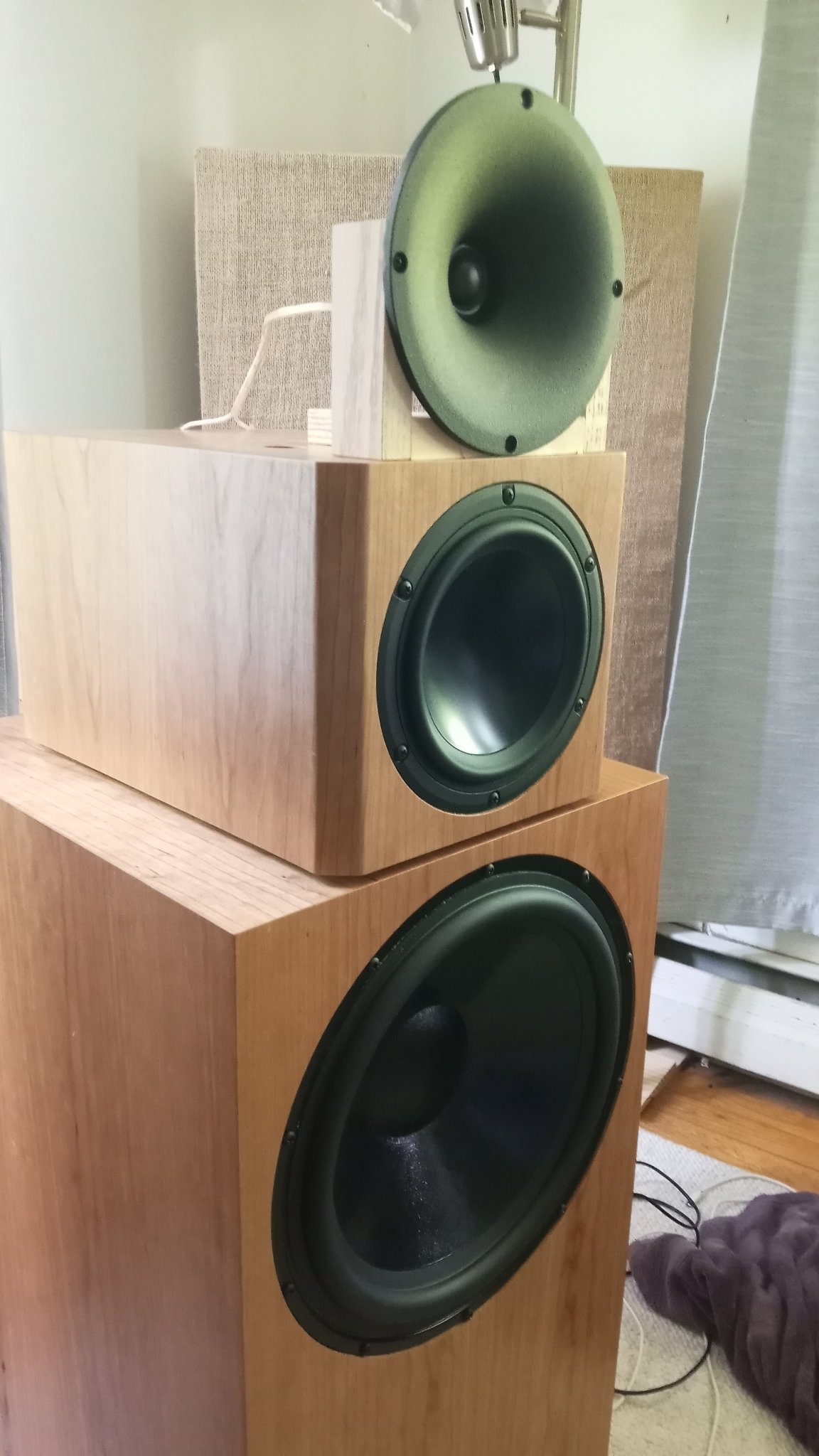

Hi,I will say I find these speakers difficult to place in my room, I wager it's due to reflections. Imaging is not as stable as I'd like with some phasey holes around the center. Moving closer to the speakers alleviates the issues as does corrective EQ, so I guess I need some treatments up.
what if you increase listening distance, would image get more stable and phasey gone?
I'm speculating your speakers are good and room acoustics is in check already, and that you are listening at close enough proximity where direct sound dominates over early reflections so that your auditory system pays attention to the sound. If you increase listening distance, the auditory system doesn't separate the sound from overall noise in the room anymore and what you perceive is more stable roomy kind of sound in the portion of room where the speakers are at. No phasey, but no clarity either, or pin point localization for example.

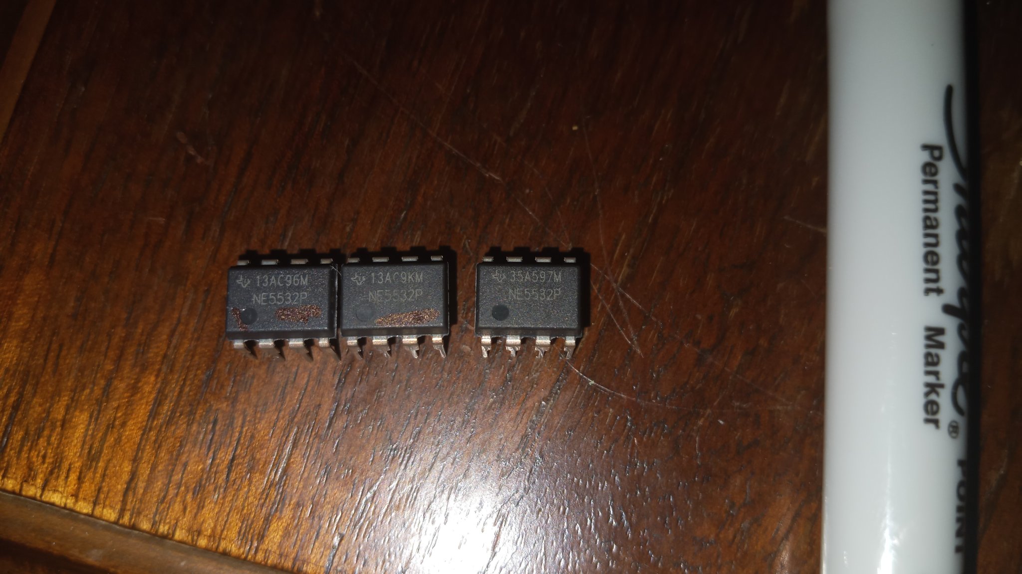

A very scientifc point. The Opamp that has major influence on the sound is in front of the power amp. The inductance of the speaker is not affected.
This NE5532 is a fake IC. It has written something that is supposed to look like a Texas instruments logo scraped in the top and a part number, but inside is some industry op amp, usually used in products like washing machines for keeping a sensor happy, but not audio. The fake is well known and I have pulled a handfull out of very different Chinese audio parts. They sell for a few Cent in China, a real one is more expensive.
All I do is to change it for a part with the same number, but one 100% made by Texas Instruments.
Maybe read this thread and then compare your NE5532 to the pictures.

I understand the part is a fake, I just don't think changing the op amp for the real thing is going to make a difference. If it does, it would be pretty easily measurable, and without seeing that info I just don't care at all.

Of course it will. The simplest thing is to try it yourself, if you don't already believe us.I just don't think changing the op amp for the real thing is going to make a difference. I
Last time I'll reiterate this one, I really only bother with mods if there is a documented case showing that it will improve things. I refuse to waste my time and energy on random suggestions with no evidence. I really don't know why this is so difficult for people to understand.
That's all I asked for, not sure why it was so hard for the other users to understand why I requested this info.
I am not in court in front of a judge that I have to prove anything to anyone. This is a DIY forum for hobbyists, you got some friendly advice about that amp based on testing various opamps instead of those fakes. If you're looking for some kind of "documented case", you don't want to waste time and so, please forget about everything. Let it be as if I didn't write anything.

I think it's just largely related to my crossover atm. I was able to get some ok data into vcad and lets just say my electrical tasks certainly didn't line up with my acoustical response. Having developed some new filters that look good in vcad things sound much better and the phasey-ness is all but gone. I'm getting the sort of wall of sound that doesn't change as you move that I'm used to.
I'm going to wager my woofer to mid is off as well, since I don't have to invert the mid with 2nd order to get a good response. I'll try to tackle that next. Too bad I'm sick atm though and my hearing switches between no highs and no lows by the hour, fun stuff.
If you are satisfied with the fake NE5532, where the TEXAS logo looks like Montana, there is no need for you to do anything.
I was curious as another member shared some data. I got some replacements from mouser. No idea if the stock are fake are not, hard to tell. The ones that came with the amp are marked with red sharpie.
The change to a real NE5532 was instandly audible.
I can safely say, no it wasn't, and you just made that up. I'm now on my THIRD a07 op amp swap as some friends of mine own the amp and wanted me to do it for peace of mind, even though I told them it will likely provide no sonic differences at all.
So you lied, and then decided to get other people to buy into your lie. You got placebo'd and your ego is the defining factor in whether you can accept that or not.

Hard to argue with better integration. I think the DX25 +wg300 I have gives me the best results. I'd like to make a better mount for them that has some rounded edges, I can't imagine the current mount is good for diffraction but it sounds fine for the most. I've considered grabbing some xt25's as performance looks better there with the waveguide, but man does the top end beam.
Im considering materials for the tweeter mount, Id like to make a sort of ring that contours the top of the waveguide, but the lower half will be straight down on the side, with a round over on the whole thing. A solid wood would look visually appealing, but I'm concerned about warping. MDF would have to be painted black if I go with that, not really what I'm after. Think I could get away with a red oak or other easily available species and not have it turn into a abstract art after awhile? My first speakers were a box made of pine and they tore themselves a part.
I have made a tweeter housing which is very similar to what you are describing. I used 3 layers of 3/4" cherry, laminated with the grain at right angles. Then I machined the tweeter recess, then used a 1.5" radius round-over bit to shape the outer edge. Laminating the layers in orthogonal layers adds stability.
