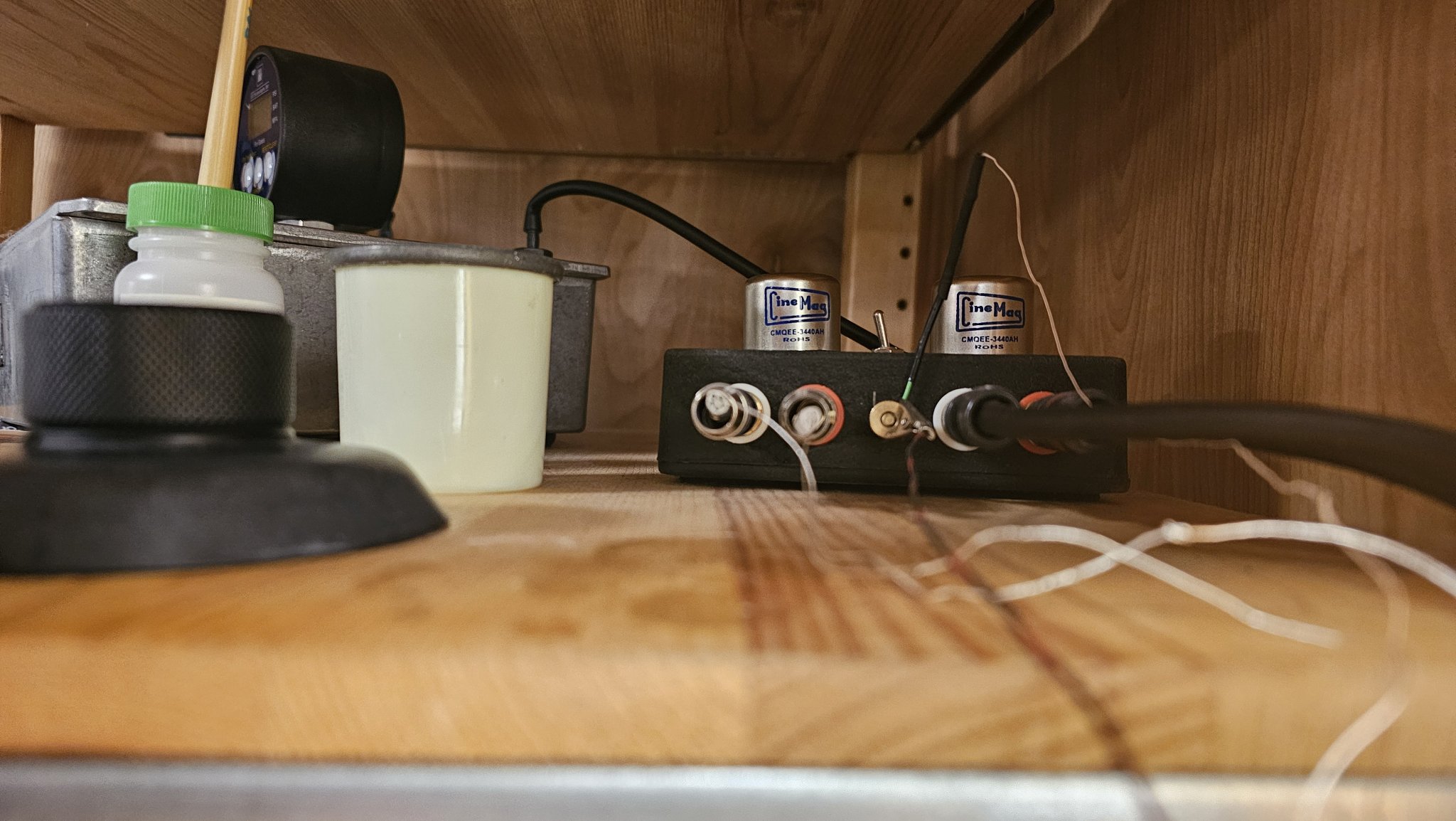

I have bought a Cinemag SUT from this Ebay seller as well as had him build me a nice SUT with transformers I supplied him. Very easy to deal with and his builds seem well done.

I really can't help you there as I know nothing about the Budgie. But I think that if you want to run LOMC or LOMI carts you will need a SUT in the 1:10 to 1:20 range. Remember you may have to change the loading as the SUT reduces the built-in phono stage load by 100 to 400. So utilizing a 1:10 SUT and if the Budgie has the usual 47KΩloading resistance, you will end up reflecting 470Ω instead of 47K. This may not be critical but for some carts it is.
