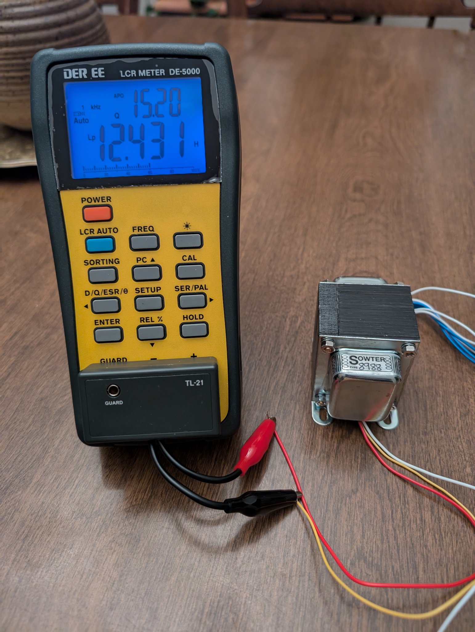

Hi Euro 21 Thank you for your response. I actually did read the datasheet several times.
The DAC has an output impedance of 121R, and the preamp has an input impedance of 10K, so 600R input impedance would not be sufficiant.
But I will recall my statement that Sowter does not respond. I got a reply from Brian Sowter today, to put a 1K resistor on the secondary, so
I will get around 900R resulting input impedance on the preamp. That is still a little low, but probably the only way to get them to work in my
application.
Because they can easily be confusing and are often ambiguous. For example the primary inductance is listed as 15H but this is meaningless unless a frequency is specified. Unlike ferrite, the steel and mumetal used in transformers has a frequency dependent inductance (it is also level dependent).
They say the preamp should have an output impedance of up to 600 ohms yet they measure the frequency response with a 6K4 source impedance.
Despite the ambiguous spec, experience tells me that a transformer with a quoted primary inductance of 15H is most likely to be a 600:600 type. This means when used as an input its secondary load should be about 600 ohms and as you have shown, this is easy to achieve. The real problem though is it this now means your preamp has to be able to drive a 600 ohm load. And most will not.

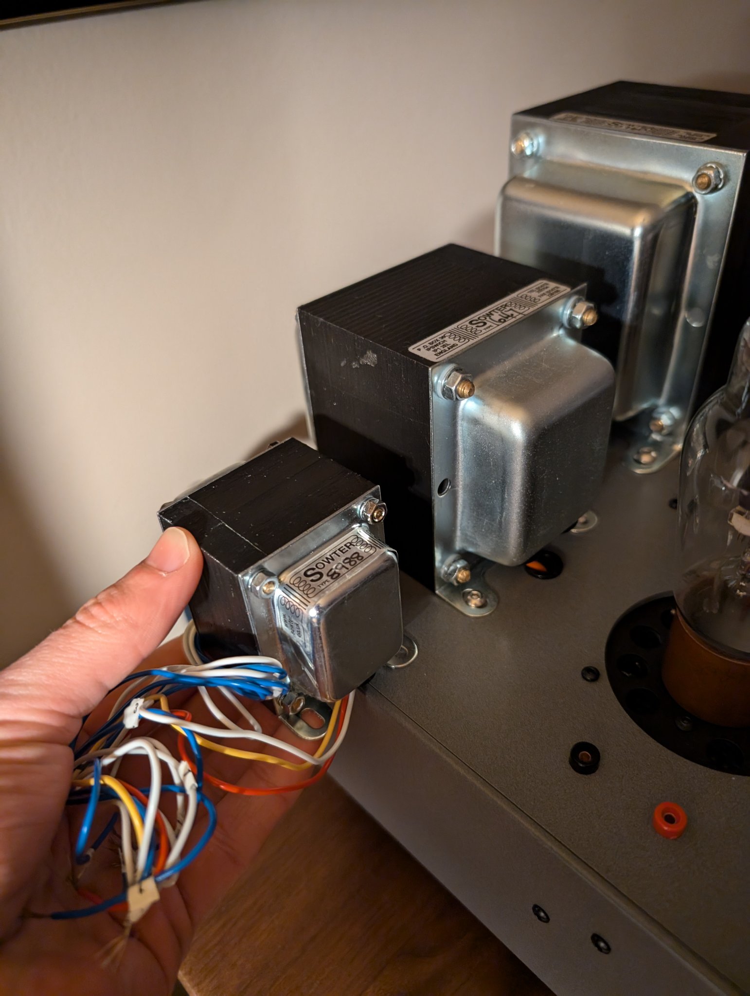

Hi Ian,
thanks for chiming in, you have helped me before, and I very much appreciate it. The Sowter 3603 is listed as a 600:600R bridging transformer. My source impedance in the test is a 50R generator, and I tested with 1K, and 10K secondary loads. 1K looked superb and 10K looked horrible.
In that the DAC that I want to use the transformers with, has an output impedance of 121R I think a resulting input impedance of 600R to the preamp is to low. Brian Sowter suggested a 1K secondary load which gives me around 900R, but that is still a little low for me.
I could change the I/V resistors on the DAC to a lower value, which will give me a lower output voltage on the DAC, but also a lower output impedance.
On my other DAC i use Sowter 3575 10:10K bridging transformers, and they work fine, without any compensation. And then why no use those again? - because I have a set of 3603 lying on the shelf, and they were not exactly cheap.

Which is pretty much what I would expect.Hi Ian,
The problem with output impedance is it gives you absolutely no indication of drive capability which depends primarily on the available current. The vast majority of op amps intended for audio applications will drive 2K but no lower (yes there are ones that will drive a 600 ohm load but I suspect they are not inside any DACs. Also, most op amps are susceptible to instability with a capacitance load so they often incorporate build out resistors of 100 to 200 ohms which tens to dominate their output impedance. So altering I.V resistors may not result in a lower output impedance. Which DAC are you using?In that the DAC that I want to use the transformers with, has an output impedance of 121R I think a resulting input impedance of 600R to the preamp is to low. Brian Sowter suggested a 1K secondary load which gives me around 900R, but that is still a little low for me.
It is likely the more critical of the two.I have tried to get my head around audio transformers for some time, and papers from Ian has helped me a lot. But the use of transformers is not common ground for most folks anymore. My experience so far have showed that the output impedance adaption is more important than the input adaption.
