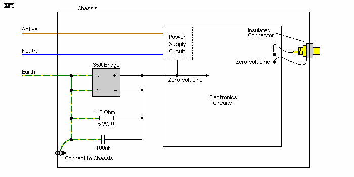

You might try a hum-buster circuit to help isolate grounds:
Another thing you can do is reduce loop area of the ground loop. The bigger the loop, the more of an antenna it is.

Hi. Possible solution is isolated dc/dc converter, it will break ground loop. No filters will help in this case, as power ground from amplifier shares its input ground. Same apply to bluetooth module - same signal and power ground.
Or use separate power supply sources for bluetooth and amplifier, like separate batteries. Bigger one for amplifier,smaller for bluetooth.
