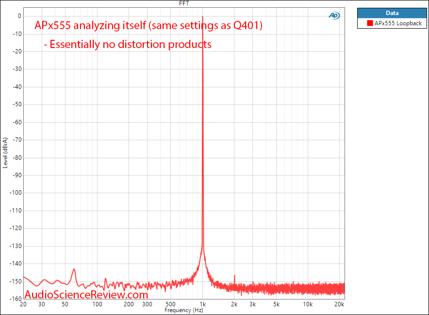

I think that opamps should be the answer As someone has already advised me is very very difficult to get the same performance of opamps with discrete circuits A good evidence could be to look what they use at Audio Precision to amplify the signal of their analog generators
Difficult to find something cleaner My guess is that they use opamps ?
yes those One thing i am noticing It is not possible to get very low THD+noise from discretes without using very complex circuitations
Much easier with opamps And i have also another big curiosity To see what premium brands use to amplify the signals of their top of the line signal generators I have seen the 1kHz sine distortion spectrum of the analog generator inside an Audio Precision apx555 I am amazed I am attaching it
I think i see absolute perfection
However here there are some informations
https://archimago.blogspot.com/2020/07/pictures-audio-precision-apx555-b.html
i love the smd look ... unfortunately is almost impossibile to use smd with expensive tools But they look gorgeous And the most recent parts have also great specs ...

so it seems that transistors have still a place in the top performing analog units Good !... a closer examination of the analogue output section. This section includes the Analog High Performance Sine Generator, capable of 5Hz to 204.457kHz output with superior signal purity than the digital generator... The vertical boards appear to be power stages with transistors on them. Unbalanced output can go up to 13.3Vrms, double that to 26.7Vrms balanced....

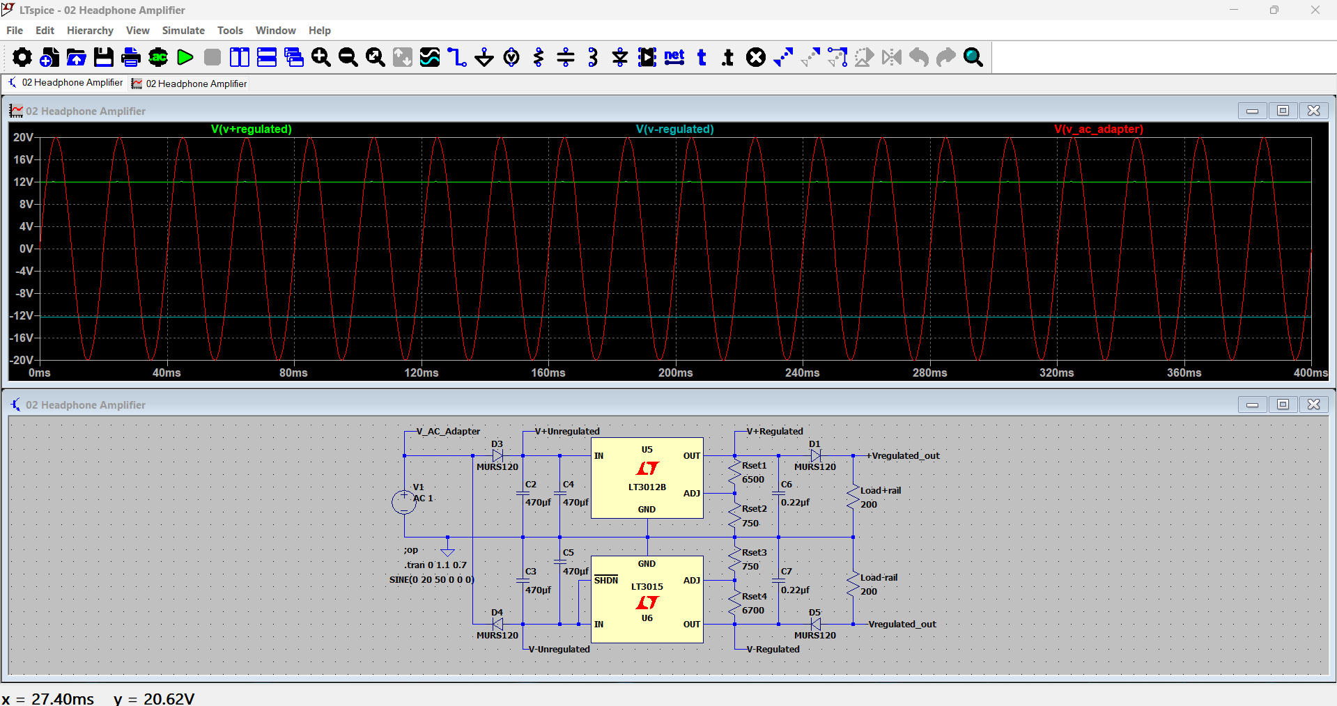

i see the cap multiplier as an active filter Maybe i am wrong So before chip fixed regulators could provide a first stage of noise suppression probably in the range where fixed regulators perform worse ? i love fixed regulators a lot They are so convenient to use and cheap as wellWhere is the need for a capacitance multiplier in a low currrent circuit?
Nevertheless also a passive filtering stage with a combination of RC and LC filters could do a similar job I have to study a lot more about passive filters

Well Ginetto, the name says itself, the active part is multiplying the effect of the capacitor, if the multiplying factor is say 100, then a 10 uF cap will look like a 10 x 100 = 1000 uF, Darlington just increases it, but it's still not a regulator that shaves of the ripple and noise superimposed on the DC voltage, also it will not operate as a cap multiplier if the incoming ripple dives below Vb where it will instead start discharging the capacitor through the transistors base-collector diode back to input and potentially destroy it, some matters to take into account when designing a Cx, however you can also do this with passive parts, just use a much larger capacitor, more foolproof, so what exactly is it you want to do? :)
Hi thank you for the very kind and valuable advice I would stick with one chip fixed regulators Then i read that they are not enough to filter ripple and noise
So the idea is to put something before them I tend to prefer actives because they allow for the use of smaller caps Big ones are big and expensive

@ginetto61 yes that sounds like a good philosophy, add a first stage simple filter that eliminates the crude stuff cascaded with a good regulator, that's what I would do if I would design the ultimate audiophile gear, at least it leaves one a peace of mind and better night sleep. :)
With regards to power supply affecting the sound of an amplifier or some other cases of audio gears is to some extent depending on their PSRR (Power Supply Rejection Ratio), if you don't mind.. nowadays opamps are so darn well designed and have astronomical PSRR it's almost making diy audio boring. ;(
