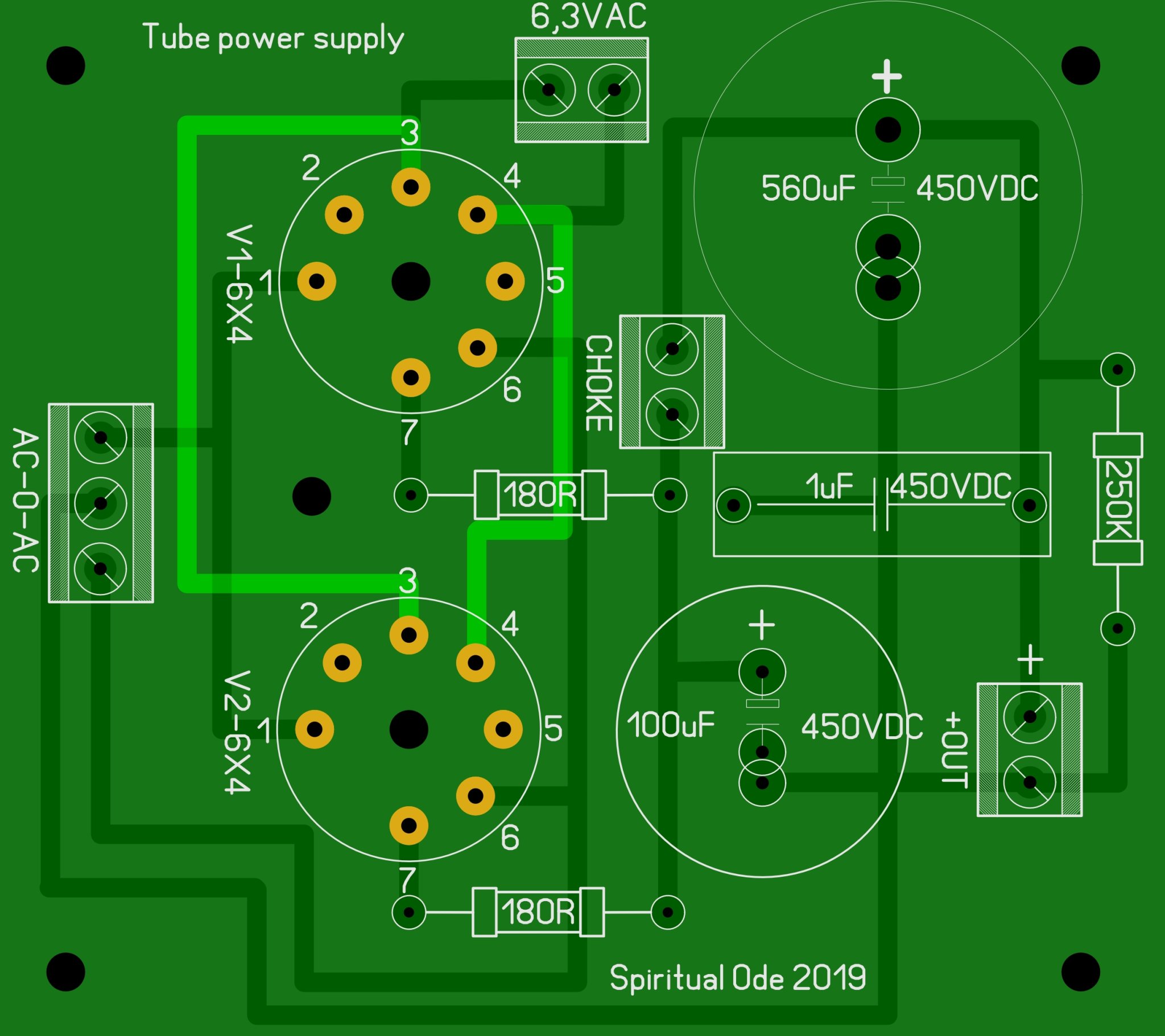

This is a 6X4 tube power supply for Audio Note M7Kit11 preamplifier.
I have built more than 10 tube preamplifiers since 2010 trying to copy designs from big brands like Marantz, Audio Note, Audio Research etc.
I have tried many different tube power supplies using 5U4, 5Y3 and a couple of others. Hum has been always present. Little but it was there making me nervous.
A couple of months ago I found a schematic from the M7Kit11 preamplifier and I decided to give it a try. I drew the pcb with sprint layout 6.0 adding a second 6X4 tube replacing the original 6X5 of the AN design.
The result was brilliant. Excellent sound and NO hum at all.
This is my design and I want to share it with all of you. The gerbers of the tube power supply and the preamplifier are available to everyone who would like to build it. Your comments are more than welcome
Cheers

Be sure that the current that flows though choque input filter is suffient to make it not to run dry. Say, that current flows in it during the 360 electrical degrees of the line frequency. Otherwise, voltage will not be completely filtered and will go to an unpredictable value between 0.9xACV to 1.4xACV being ACV the ac voltage RMS available at each 6X4's plate.
I hardly like choque input mainly with tube rectifiers, but be careful with it. And still more warning when one or more or all tubes being the PSU's load are removed from the zockets or disconnected completely from PSU.

6X4 requires a 10h choke. i have built many tube power supplies based on 6X4 using the same 10H choke and they work fine with 2 t0 5 mV ripple.Be sure that the current that flows though choque input filter is suffient to make it not to run dry. Say, that current flows in it during the 360 electrical degrees of the line frequency. Otherwise, voltage will not be completely filtered and will go to an unpredictable value between 0.9xACV to 1.4xACV being ACV the ac voltage RMS available at each 6X4's plate.

I think that the designer has placed the choke after rectification for using a bigger filter capacitor. ( 100uF instead of 10 ).Indeed the current that flows in most of the tube preamps is not more than 30mA according to the Tubecad.

The transformer is a 300-0-300 120mA and the tubes JAN6X4. Can you be more specific?

Over it, keep in mind that an inductor can saturate by the presence of DC current flowing in it (This is the case) and by tha AC voltage across it. Thus, an inductor usually is designed for a specific work and no necesarily will do its job properly out of this conditions. Thus, the brand and model of choke are irrelevant.

Cap multiplier and choke filter are different things. They can coexist in a circuit but one doesn't replace the other.Use a cap multiplier and dump the choke.
I have read carefully the article from that site and I am aware of all those terms in using a chole. My design is taken from an Audio Note design (which I trust) and it would be identical whether I didn't want to use 6X4( I have plenty of them in stock) in place of 6X5 changing just the choke value from 20H to 10H due to the tube data sheet. My previous power supplies were not so different. This is what I meanhttps://electronicscoach.com/choke-filter.html

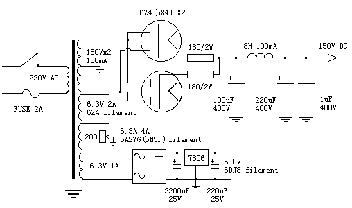

That very simple power supply below has worked in 3 of my preamps for many years. It's an RCLC but it would work as an LCRC too. Its only disadvantage is the little hum. I believe that any comment on a design or a schematic is very creative and welcome. This is the purpose of publishing our designs. By the way, your handmade chokes are superb.

@metanastis : please note rhat what I wrote refers mainly to the schematic at post #1 where a choke input filter is showed. This doesn't apply to the schematic at post #13 where capacitor input is shown.
