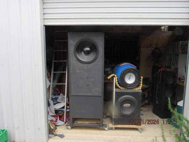

WAF says a definite "NO" to any 18" in the loungeroom. Any affordable 18" in a 150litre box would also [ maybe] be too much one note bass and maybe not get any usable output at 16Hz
Picture of the current 18" bass box to show why, it needed 600litres to sound good. Australian prices are pretty high for what you get

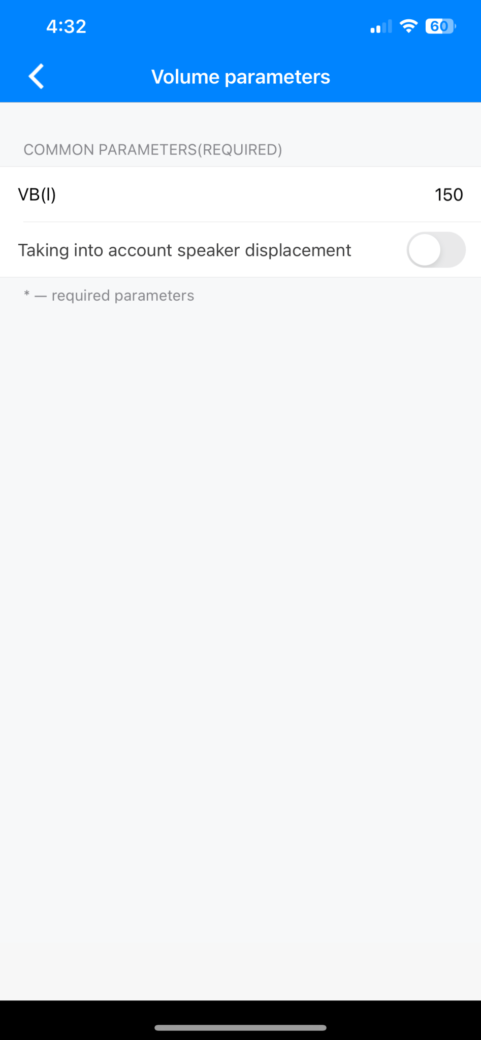

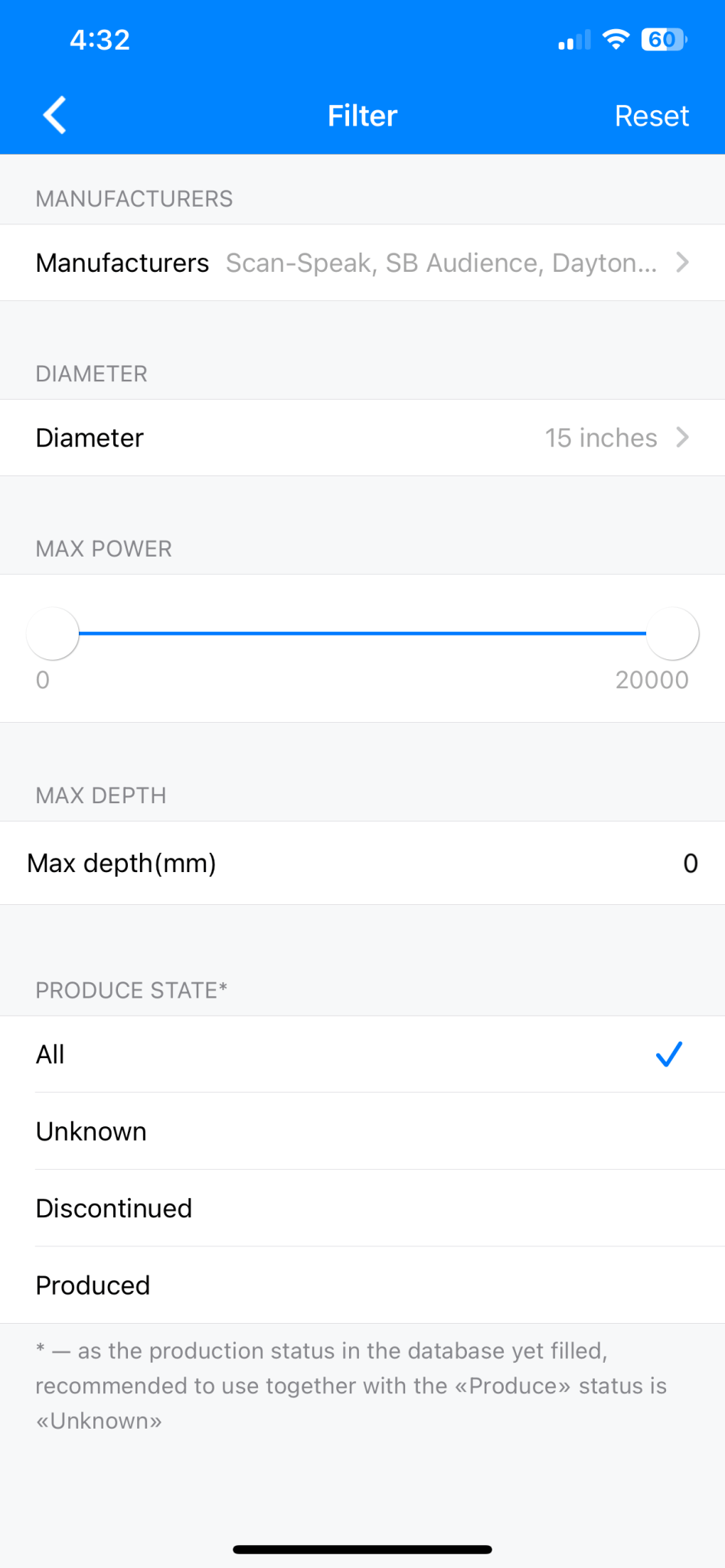

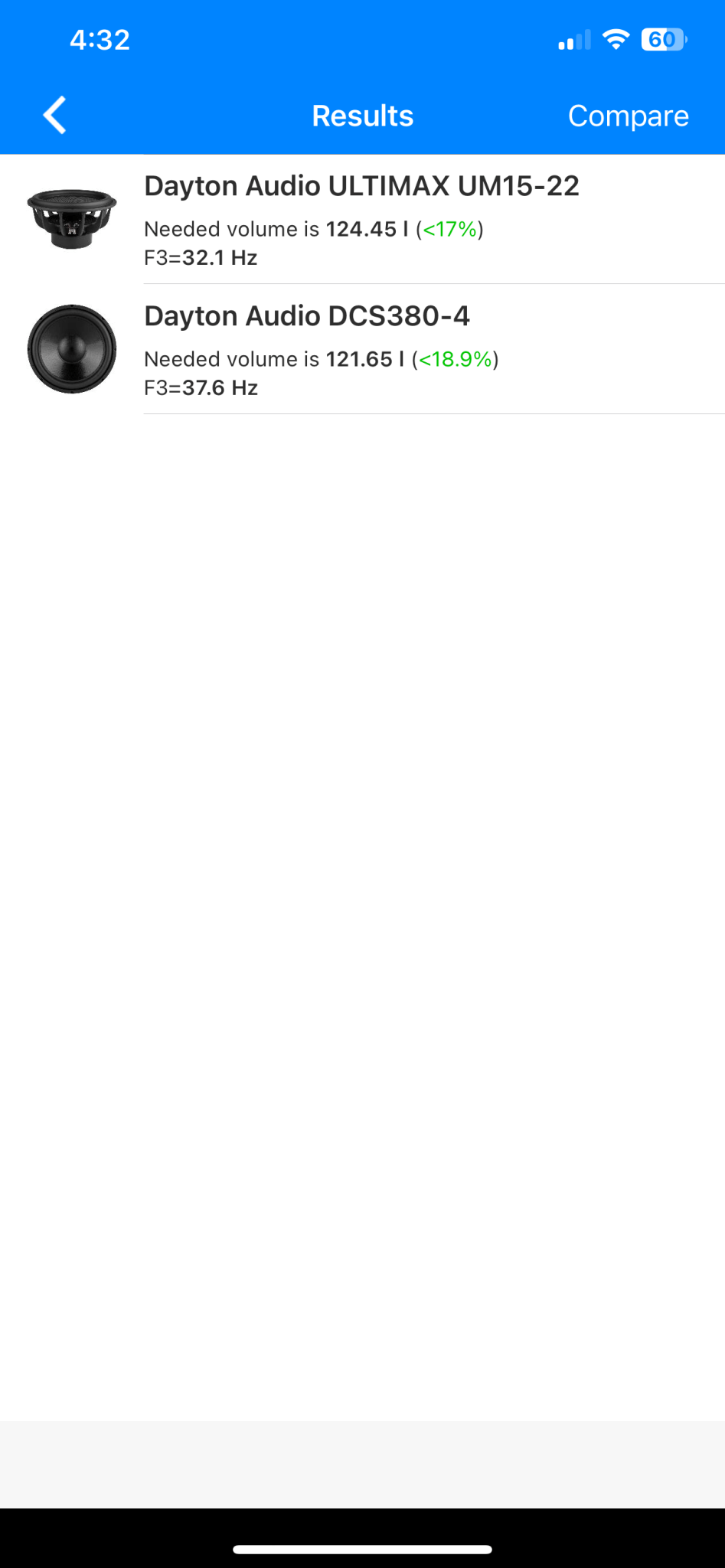

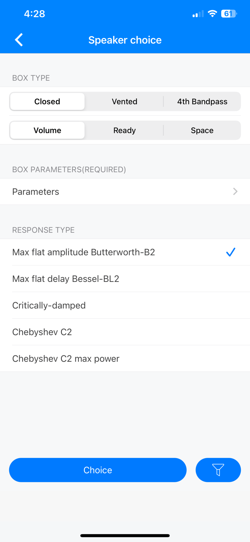

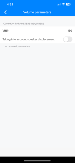

G’day!
I had a similar problem- I needed to fill a column/speaker stand no wider than 35cm for WAF. By the time I worked out the cabinet height to ensure the tweeter was at ear level, and, and the maximum depth to match my TV cabinet, I had a net volume of 100L to play with.
Then I went and looked at an app called SpeakerboxLite. There’s a free PC based version that is not as intuitive, but works all the same.
You plug in your box volume, box type eg. Ported or sealed etc, desired F3, and then select from your desired driver size eg. 15” and the program will spot out a dozen or so close matches.
It’s like doing speaker cabinets with TS parameters in reverse- it choose the drivers based on your cabinet requirements.
You can even shortlist manufacturers so you don’t get recommendations from drivers that cost more to ship than to buy on this island continent!
Check it out!
Check it out!
Eg.

SpeakerLite is just software, so it's a start when you're stuck for options and need to get a shortlist.
Like AI, it's not real smart. Needs to be checked, or have oversight, by a real human.
I'm with Harry72- I'd take RSS390HF over the Ultimax15, for clean bass in a sealed box, particularly if you're wanting to read to mid hundreds Hz in a 3-way.
The RSS390HF would go nicely in 150ltrs, 130 should give you a Qtc .7, F3 about 30Hz and F10 in the high teens, but its a $600 driver
