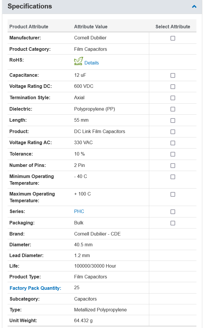

A nice 10uF paralleled with a 2uF or 2.2uF should do ya.You can parallel any cap values to achieve 12uF, you know, right?

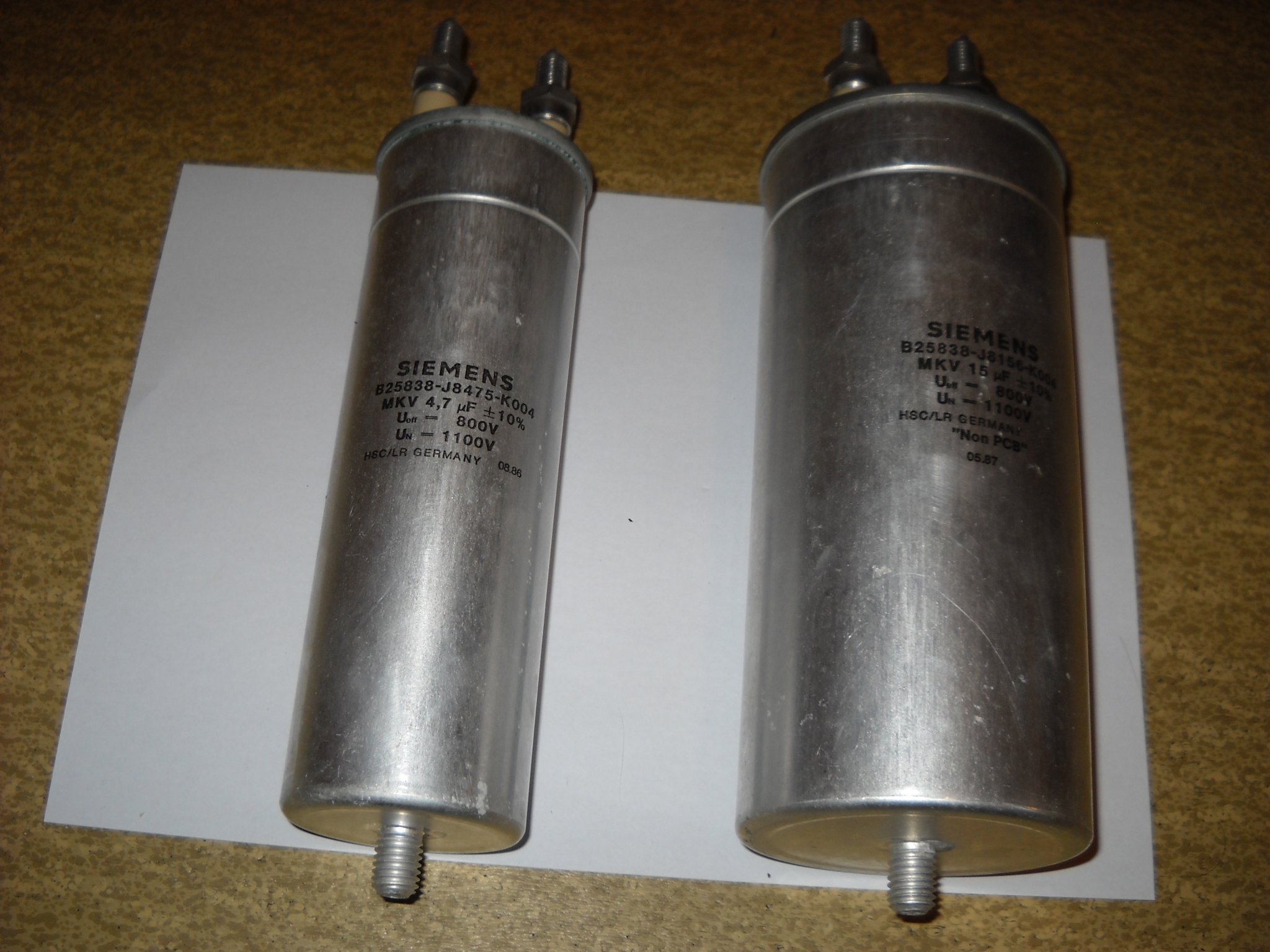

I could sell you a pair of 12uF NOS Siemens MKV caps, industrial quality hermetically sealed ceramic feedtrough connection bolts,
for €60 shipped to England.
The data below is for the 15uF caps I also have, but the 12uF is not much different.
I have at least 10 of those, if someone else is interrested, also 4.7uF.
I can also measure and look for a pair if needed.
Siemens B25838
MKV
15uF +-10%
Ueff 800V
Un 1100V
Imax 80A î 9 kA Is 23 kA
(du/dt)max 600 V/µs (du/dt)s 1500 V/µs
Lself 170 nH
tan δ0 2 · 10–4
RS 1,7 mΩ
Dimensions ∅ × l = 89,3 mm × 194 mm
Approx. weight 1500 g Impregnation Oil
Fixing Threaded bolt M12 Max. torque 10 Nm
Terminals Screw terminals M10 Max. torque 7 Nm
Terminal cross section 16 mm2 Creepage distance 20 mm
The one on the rigth in the picture.
