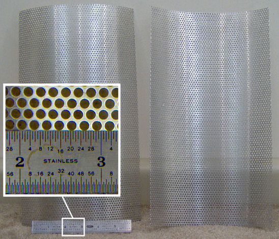

Here's a photo of the stators. 7-1/2" wide, 14" tall, and a 5-1/2 radius roll.
They're 0.032" thick aluminum with 0.125" dia. x 0.156 staggered holes, about 50% open area. One of the things I learned from the first build was to cut the edges to minimize sharp points to keep down leakage. The stators were rough cut 1/4" oversize on all sides, patterned matched, and screwed together before cutting both at once to final size.
I made no attempt this time to smooth the burrs from punching and just rolled them with the best sides facing in.

Here's a picture of the latest version of the stators with a 500 gm roll of solder next to them for scale. It's going to be a simple flat panel built from 0.050" thick aluminum with 0.057 diameter holes, 35% open area and a 4-1/4" x 11-1/4" actual radiating area. The non-staggered hole pattern made cutting an edge with no sharp edges very easy.
The insulators are 0.025" thick acrylic sheet super glued to the stators with a divider that breaks up the diaphragm into 2-1/2" and 1-3/4" wide sections. The VHB tape from the first version didn't work out very well. It needed it to cover more area than I was willing to give it to be effective. I've used VHB in real life and it can perform extremely well when used correctly. My first try just wasn't a good usage of it.
I tried a couple of things that seemed like a good idea at the time. Each stator has an short edge bent at 90 degrees to the face to give it some rigidity and I added four legs for mounting. Each of the holes in the legs will have a rubber grommet added later. The legs should also make a good connection point for wires.

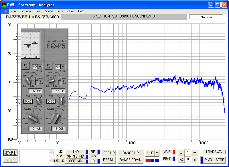

Here's a screenshot of the small ESL without equalization. The microphone is 3" away from the center of the ESL and white noise is being fed to the ESL. The high end of the graph looks a lot like my larger ESL with a broad rise at 6Khz and a dip above 10KHz.

BillH-
Thanks for the updates. I'm surprised to hear that "The small ESL seems to be about as efficient as the larger panels, but plays louder." Can you remind me what the spacing and overall size are for the large panels? I'm assuming the small one keeps up with the large one because of a significantly smaller stator/diaphragm gap, but I'm still surprised the maximum loudness of the small one is greater. Is your amp's circuitry limiting the loudness of the large panels at fairly low SPLs?
Few
Few writes:I'm surprised to hear that "The small ESL seems to be about as efficient as the larger panels, but plays louder."
Hi, Few. Me, too. Even though I was careful and checked my work, part of me was surprised it worked at all. :D This happened with a reduced bias voltage, too. When I first started the small ESL I forgot to turn down the bias voltage. It sounded like bacon frying. When I turned it off, I could hear the diaphragm that had stuck to the stator slowly deattaching itself. Fortunately there was no permanent damage.
About 0.060" diaphragm to stator spacing and about 3 square feet of radiating area.
I believe it is. The amp is nothing special, a Kenwood 100 watt x 4 home theater receiver. I am grateful for the protection circuit. Without it I would have left the magic smoke out of the amplifier several times.
I think the next step will be to make a new pair of small panels based on this one complete with bias supplies and step-up transformers so I can move on to enclosing the back wave. Has anyone tried the cheap CCFL power supplies for bias? I'd like to try to avoid building them from scratch if possible. I'm also looking for cheap toroids to try as audio transformers.
