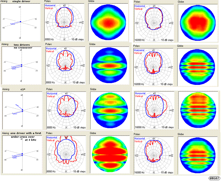

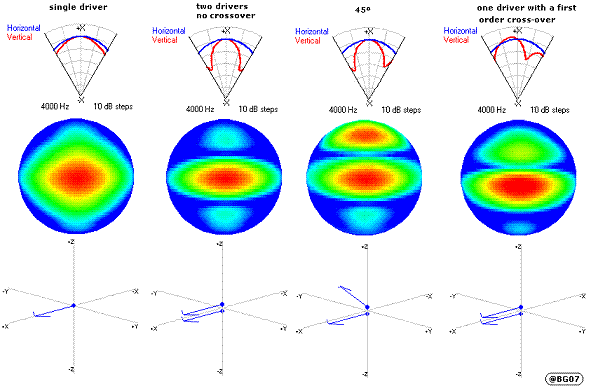

I guess I can imagin what the "comb-filter effect" is now. Per the picture, the distance between centers is around 10 cm, what frequency will it be?

Scottmoose 2nd January 2007 01:30 PM
Quote:
Originally posted by pwan
Thanks Scottmoose.
About 4Khz, give or take.
