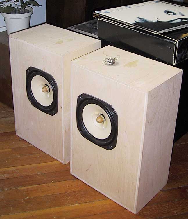

MPM 31st August 2006 03:22 AM
I've been contemplating FR drivers for a few years now. Probably get a complete set of fe167e's and build the recommended BR enclosure for the mains and the optional enclosure for the center and rear speakers. Will be using a Panasonic sa-xr50 to drive them.
http://www.fostexinternational.com/d...7e_enclrev.pdf
planet10 31st August 2006 03:54 AM
2 Attachment(s)
Quote:
I'm listening to a set of those (althou with the port lengthened to 3"). If you are going to use them set to small they should do well... the Brines box is better. We are also working on a Mama Fonken box for these.
The pair of 167s i have are awaiting me to go at them with the C37 & puzzlecoat (they already have phase plugs)
dave
