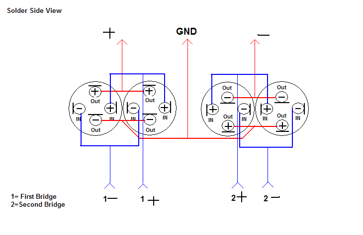

Now, I'm confusing the connection of the Jensen 4-poles E.Cap.
I found that in the Jensen's Web site, different kinds of connections of the 4-poles E.Cap, anyone know that which connecting method is the best?
My connection now is only parallel two 4700uF/63V in one side, + IN connect to the + side of C6/C7¡A- IN connect to the - side of C6/C7, + OUT and - OUT connect to the other cap's + IN and - IN, and finally the + OUT and - OUT connect to the + side and - side of C8/C9.
Is a best result given out in this kind of connections??

The way you have them adds the ESR. Wire your Jensen's like so:
More so because they're four poles and I doubt the possibility of mounting them on the PCB at all.
Placebo aside, these caps sound incredible, to the extent it's likely worth a bit of increased EMI. Still, I'd at least twist the wires and it might do to try a ferrite clip or other common mode choke right up against the PCB, in the least.
I'd twist all the other wires too.
Now that I look at it more, I really have no idea why the T networks are jumping back to the PCB. Can you not just // them for each rail and then go straight to the amps off the caps in the most direct route possible?
Could probably also put the caps in front of the supply and shorten the wires all the way around, from the supply to the caps and from caps to the modules.

But the output of the Coldamp SPS80 is +VCC GND -VSS, how can I connect the T-Network like your attachment??
Easy enough.
Add another wire.
V+/GND (two twisted wires) and Gnd/-V (two more twisted wires). The output ground formed by the cap common just goes straight to the amp power ground.

I've try to connect the Caps like your suggestion, +Vin GND use a twisted wire connected to C7, and -Vin GND connected to C6, also the OUT+ & OUT - of the Four caps becomes the GND of the output.

Actually, now I connected the Jensen Caps like classd4sure suggestion. For the best performance, we should connect in this way!
And also, I found that the sound becomes more muscial and detail, a possible way to modifiy your SPS80 in a best result.
